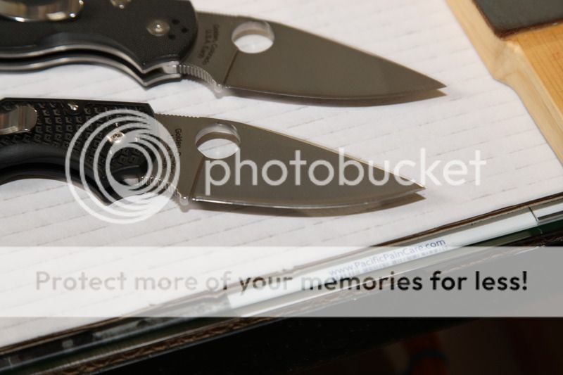

i have a dumb question to ask,i have a spyderco native 5 with uneven bevels on it,how dose one make then even! do you just sharpen one side more then the other until they become even ! i should have returned this one but never did,so now i would just like to even out the bevel on it,i have never had a knife that came this way before,thanks guys.:mad:
Depends on how uneven the bevels are. Pics?
If it's not too bad, you should be able to sharpen it out without much trouble.

Uneven as in the bevel is wider at the top/bottom or uneven as in its wider on one side of the knife than the other? Pics would be helpful.
In either case you should be able to sharpen it out by maintaining a constant angle on both sides from the ricasso to the tip. Depending on how bad it is you will likely need to use some moderately coarse diamond stones or the like.

this bevel is wider on one side then the other,and i was wondering if i should just grind the smaller side to until its even!
If you just sharpen on one side you will create a burr on the other side. So make 4 or 5 passes on the wide side, then make a pass on the other side just to take the burr off.
sorry about the photo,this is the wider side showing on the lower native 5 bottom,but i'll try working on it.
That's what I'd do. Use a marker to determine the angle of the 'wide' side, then use that angle on the 'small' side.
