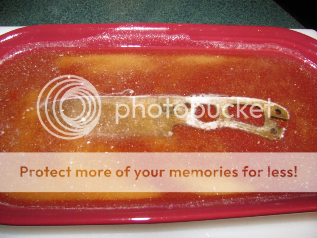

While I was posting about rust and 1095, I decided to do some testing on my own to see what would happen to a BK11 in a really bad environment.
Took my stripped BK11 and cleaned it thoroughly with denatured alcohol, then 90% rubbing alcohol.
Then I made a batch of strong acid from household goods: 1/2 cup of cider vinegar, ascorbic acid (2 crushed vitamin C tablets), acetylsalicylic acid (2 crushed aspirin tablets). To that I added 1/4 cup of kosher salt and 1/4 cup of hydrogen peroxide. This is strong, oxygenated, super salinated stuff.

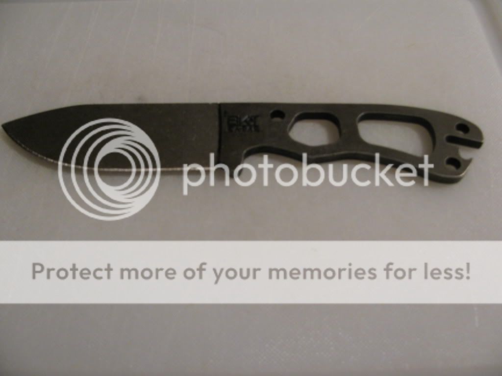

The innocent test subject:
Starting to see some reaction 10 mins in, added additional peroxide to move things along:

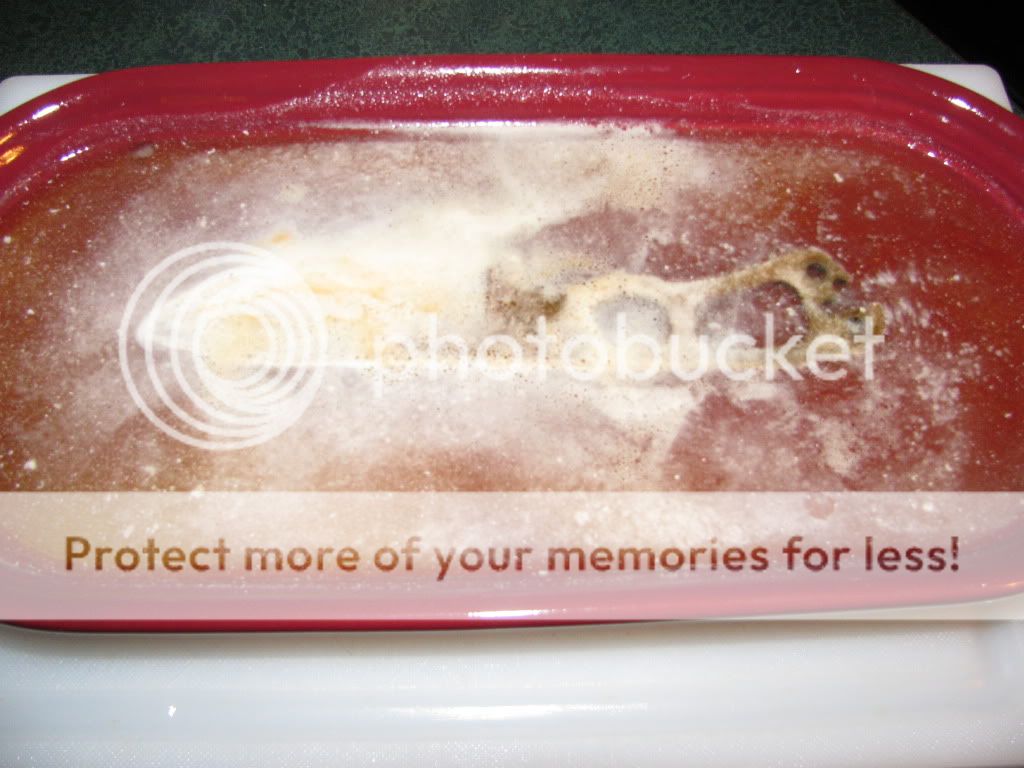

Not exactly a spa treatment - lot of chemical reaction going on 15 mins in:

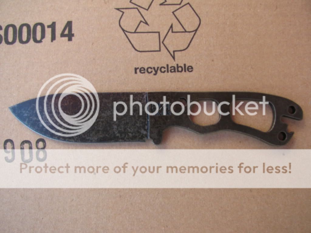

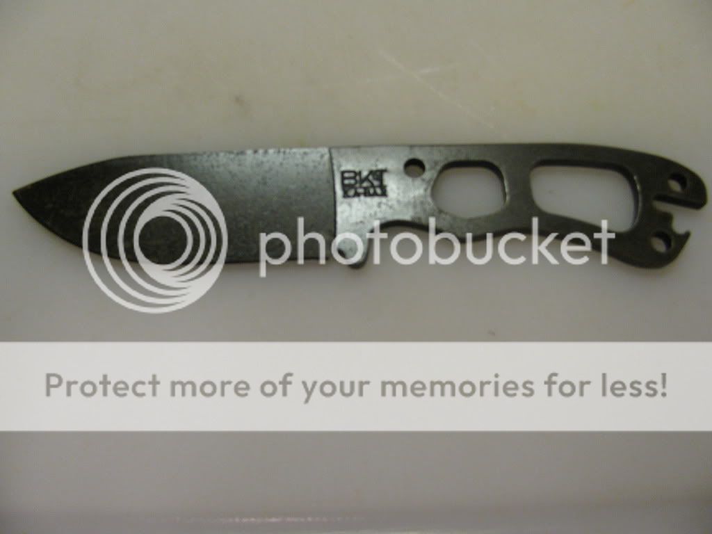

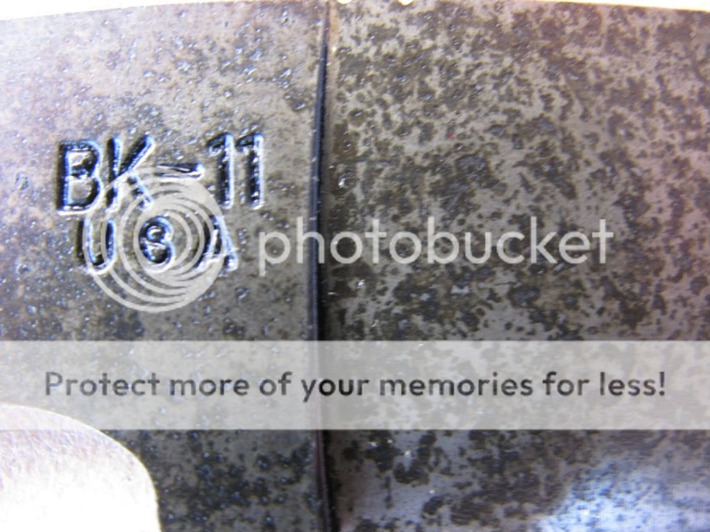

45 mins in time to pull her out and use some baking soda to stop the reaction. Light oil and wipe with paper towel. With my finger or fingernail, I can't feel these pits. With a toothpick, you can just tell there is some texture. If I had fully dissolved the salt, I do not think you would even have this at all.

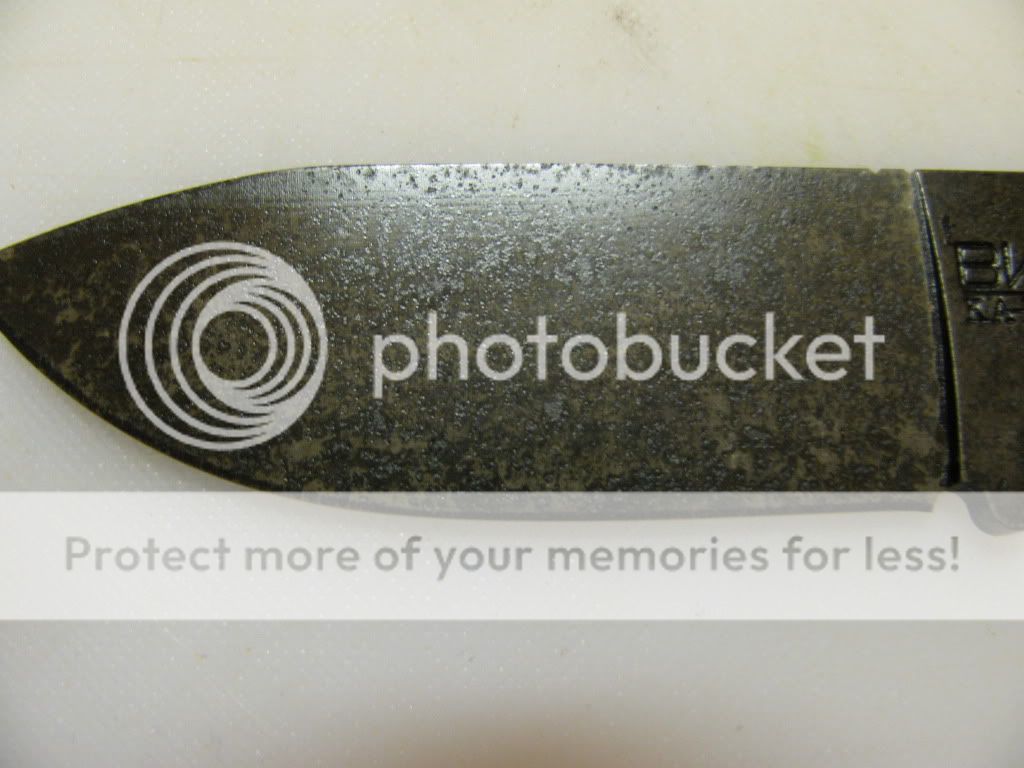

Closeup on the blade. Darkest forced patina I have done. Blade still sharp as hell:
I would call this strictly cosmetic, no damage to the structural integrity. I am really impressed with the way the blade held up. As a happy accident, I really like the nice dark finish. I will work on some daytime pics with better light.
I am not a bit worried about my BKT's rusting from real world usage if this is what it takes to discolor one. This knife is going directly into EDC rotation. 1095 full of win.
