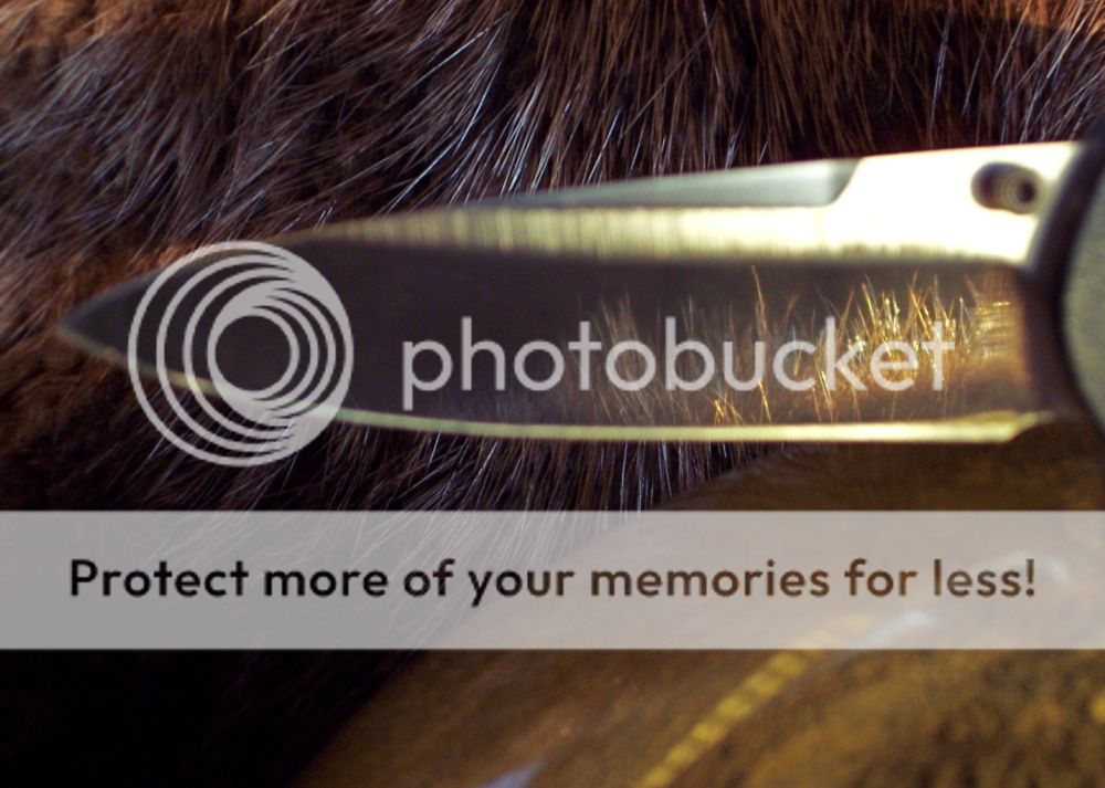

I'm just learning how to sharpen with stones instead of a more mechanical tool and I've gotten great results on the bevel, but in the process of learning I've put some ugly scratches on the steel. What's a good way to get those scratches out and make the knife look shiny again?
Scratch the whole thing!
It sounds crazy, but it's one easy way to polish a knife. Just make the scratches smaller and smaller until its shiny again, using progressively higher grits of sandpaper. Don't start too low, unless you really gouged it. You can probably start at 320 grit and go from there if its not too bad.

This is s30v taken to 1000 grit-- coarse enuf for "dazzle":
This is D2 taken to 3000, followed by a full Flitz polish:
You can stop anywhere in between.
I do my coarse work at 320, then run progressively finer from there-- but you never want to start any coarser than you have to. If your scratches approximate 600, start there. Sandpaper available to 3000, where I gen'ly take blade faces I'm working on (3000 will pass for a full polish till examined closely). Full polishing takes MUCH add'l time when done by hand, and there are other issues w/ polishing that can cause problems of their own.
