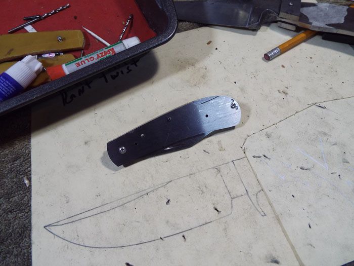

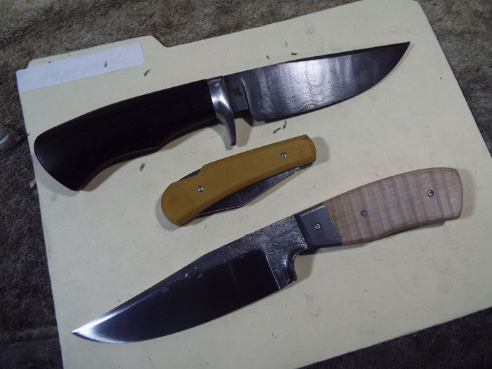

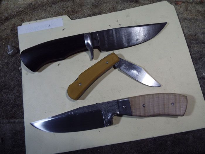

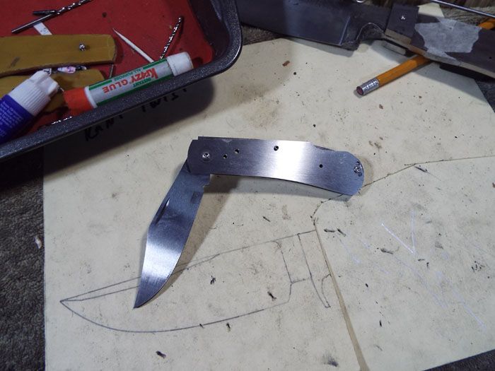

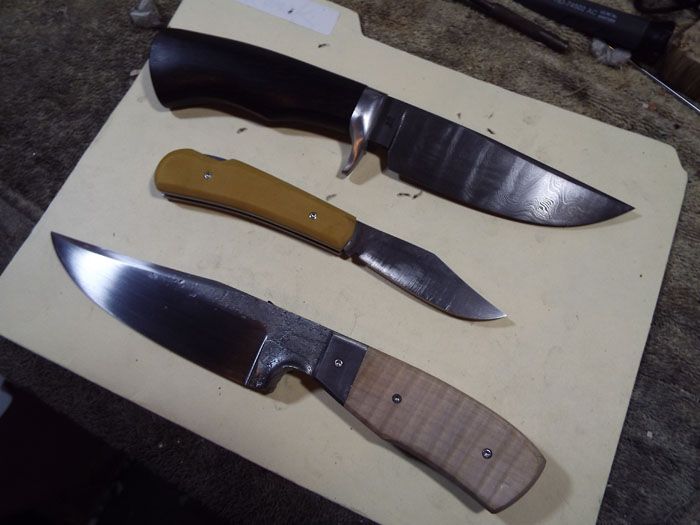

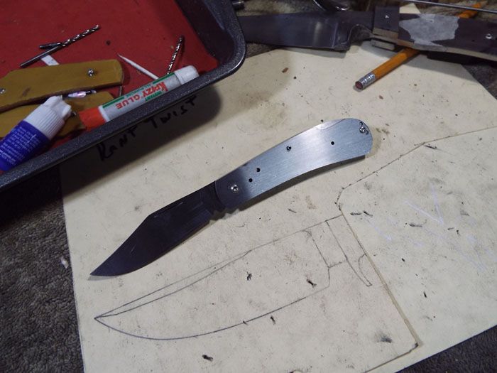

For about a year, I have been bugging Keith Johnson, here in northern Minnesota, to give me a few lock-back lessons.
Once some other guys heard about it, they also asked to join in.
So, this past weekend, Keith delivered up in spades, and four of us gathered at his shop for some instruction.
Keith only stood back and gave assistance, and we all did our own hands-on work. So everything is sole authorship.
This is not done, but I was sitting here at the computer doing some photo work and thought I'd toss this up.
I had my own plan, as far as what I wanted to make, so what you see here is all carbon steel - 15N20 frame, 1080 lock-bar and rear spacer, and a laddered Damascus blade.
Everything is all hardened and such.
I wanted all carbon steel so I could hot-blue everything.
The scales are early 20th century Bakelite.
I have so much work to do this year, I'm sure I won't get this done for another couple weeks or so, but here is the first folder from Andersen Forge - not-yet-done.
