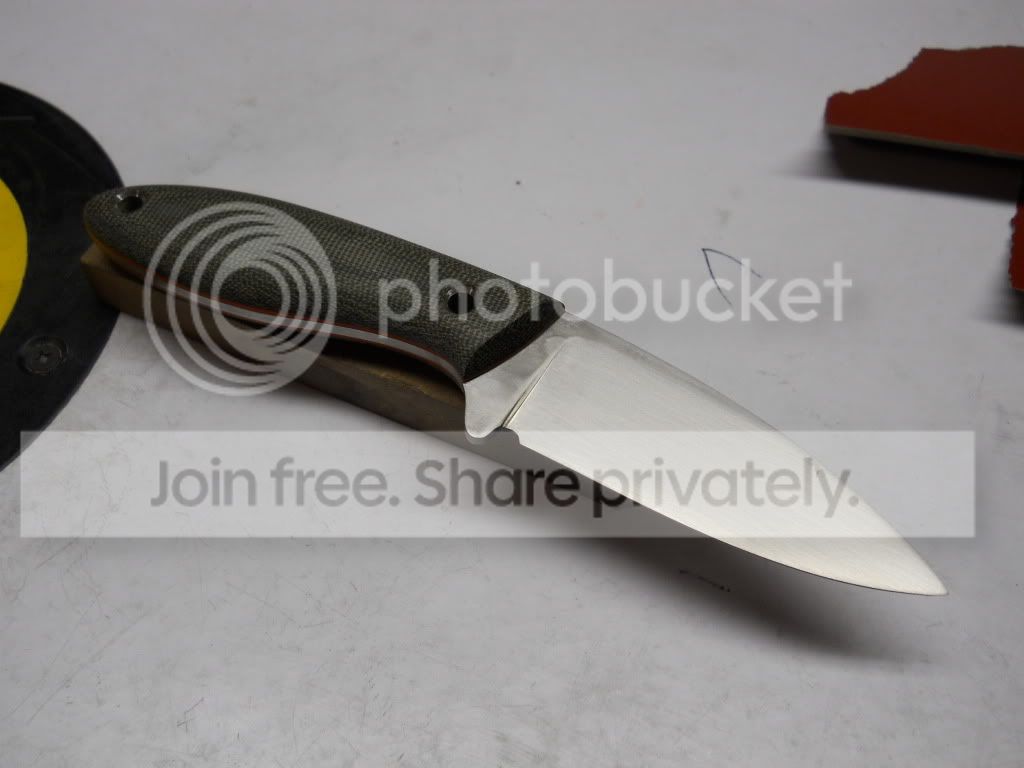

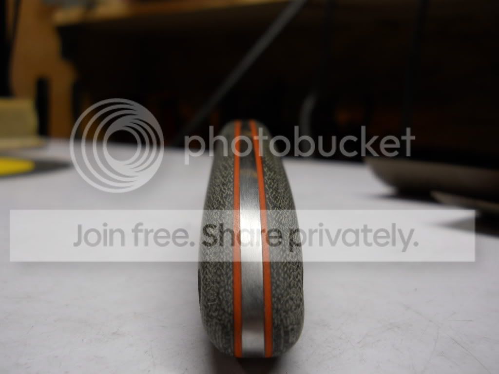

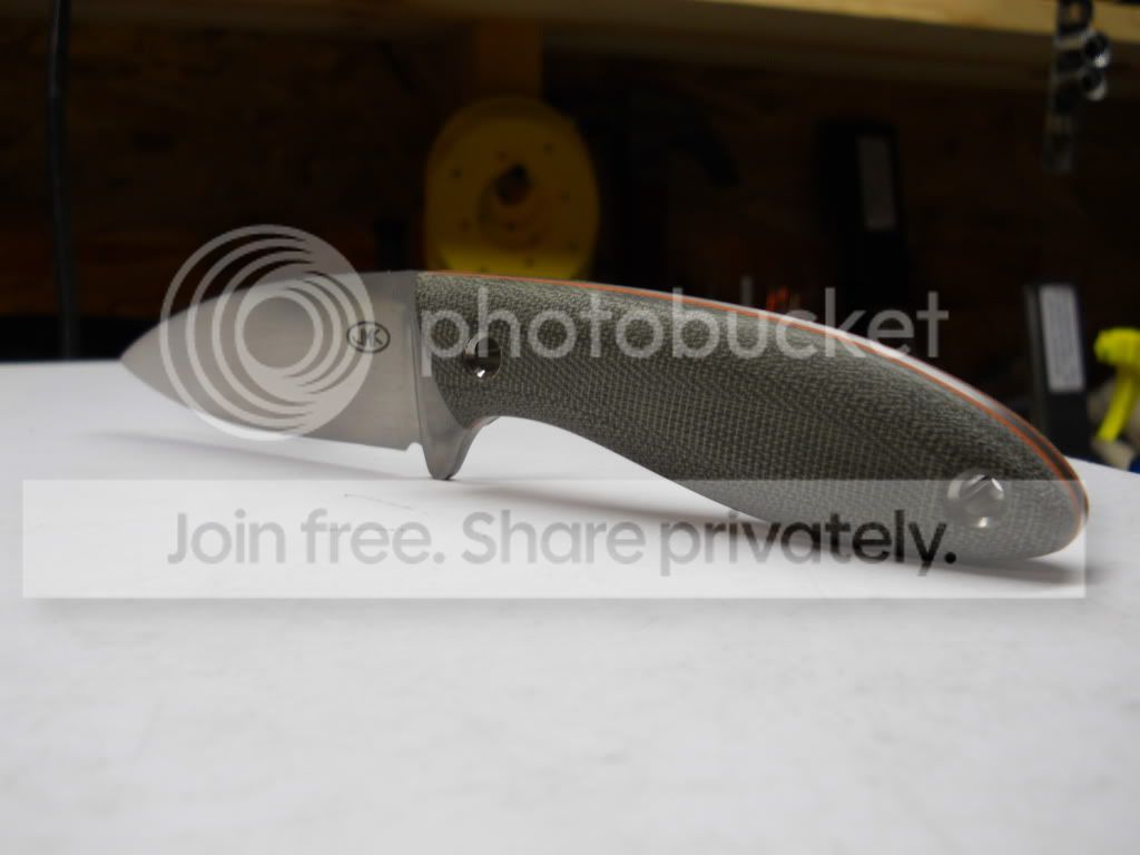

Hey all, here is a little WIP thread on a knife I'm getting close to finishing up for a forum member. It's my EDC model in ATS-34, RC 59 done by Peters, green canvas with orange G-10 liners, stainless tubes, and a hand rubbed satin finish.
Feedback is welcome, thanks for lookin'!

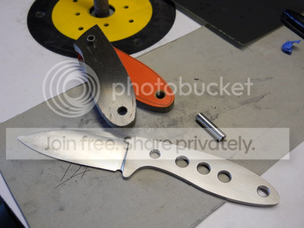

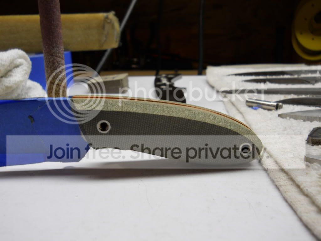

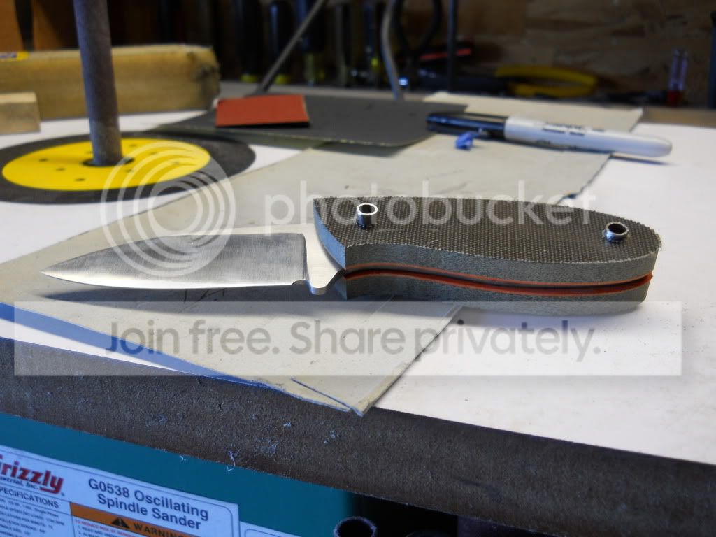

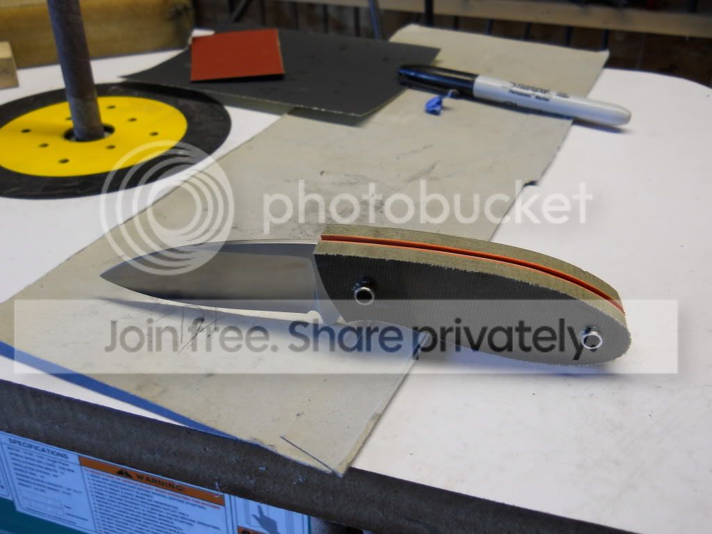

Blade ground and handle slabs roughed out getting things lined up:
Handles glued up, shaping with the grinder underway:
More coming.......

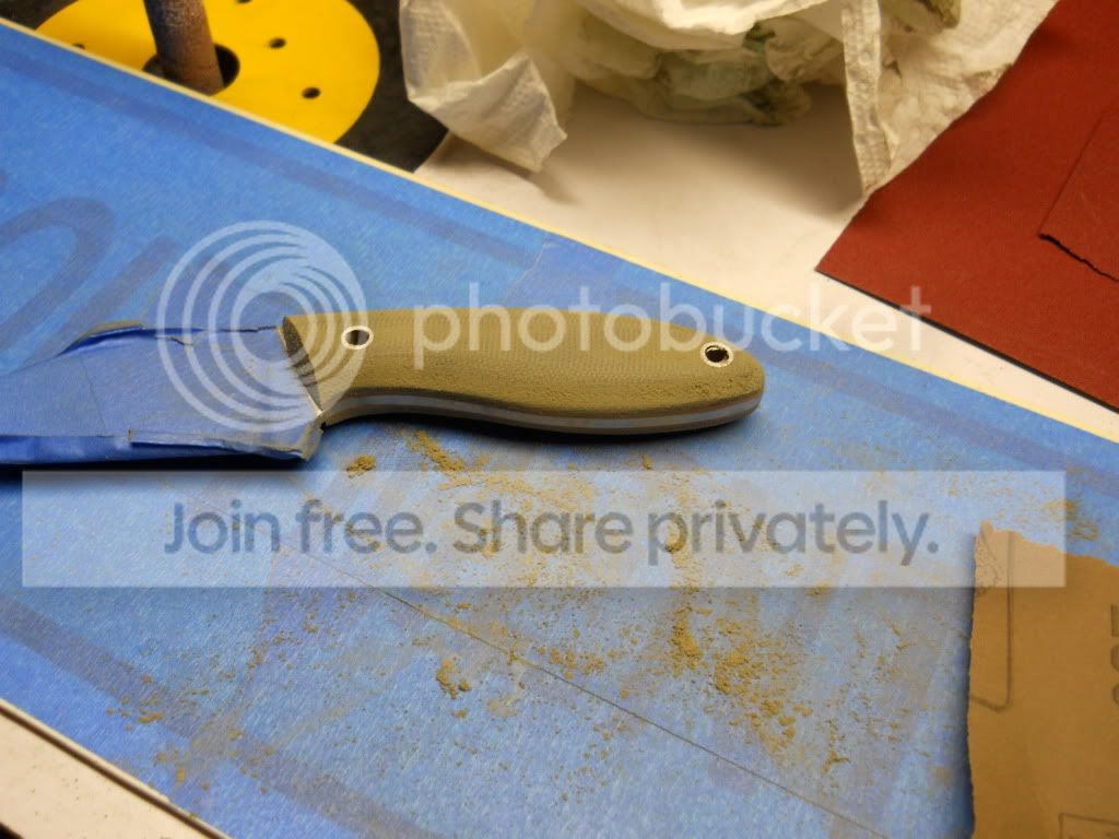

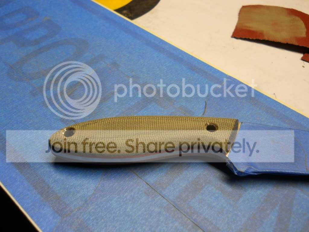

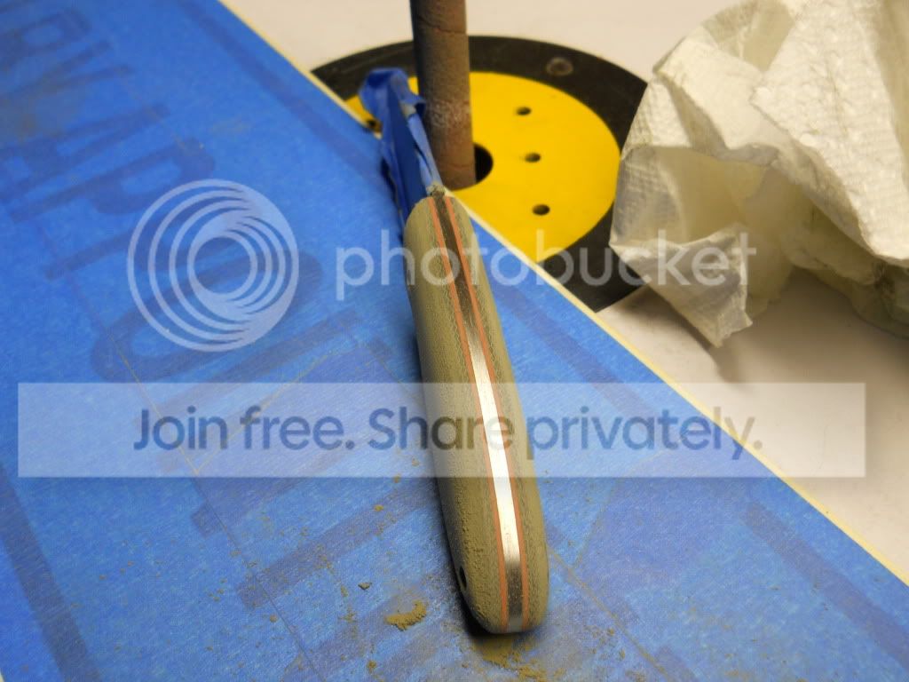

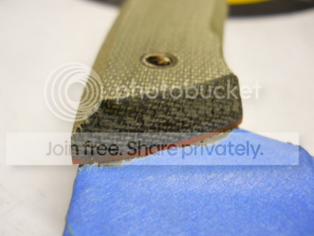

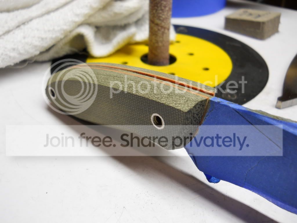

Hand sanding on handles and countersinking tubes:

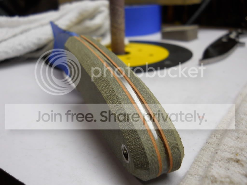

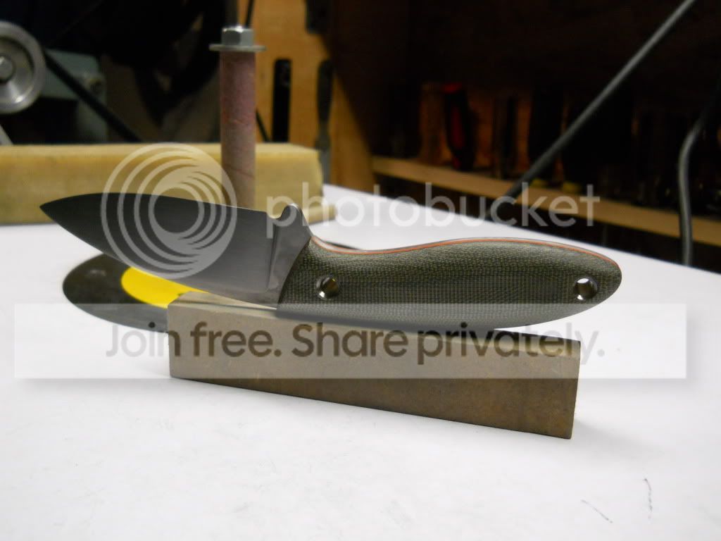

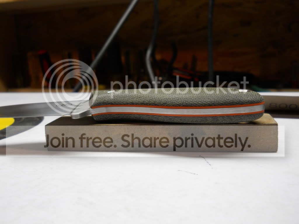

Hand sanded handles to 600, almost done, needs a little buffing on handles and final edge grinding:

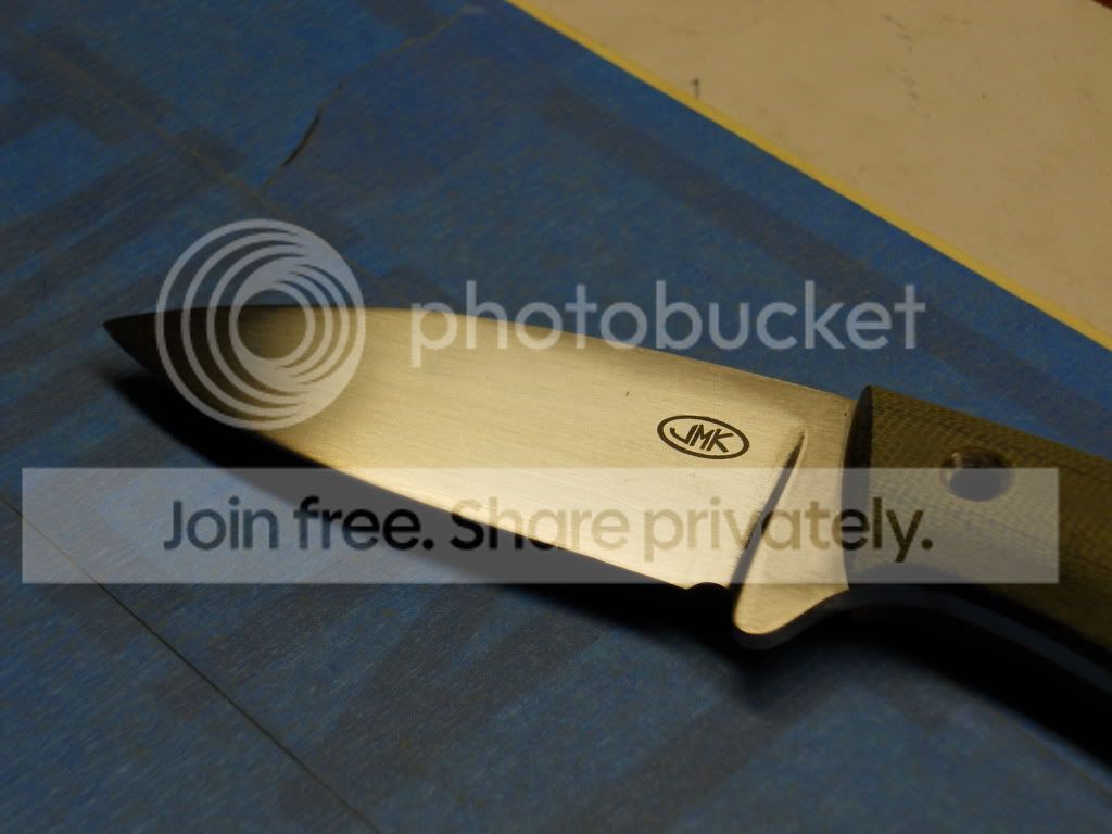

Should have it wrapped up tonight or tomorrow, I'll post more of the finished blade. Thanks!
Dear sweet lord..... You are too fricking good to have a completed blade count as low as you do. The satin is perfect, the handles look amazing the design is tight, the grinds are nice and crisp. Bravo, Jon...bravo. I can honestly say that you made my week.

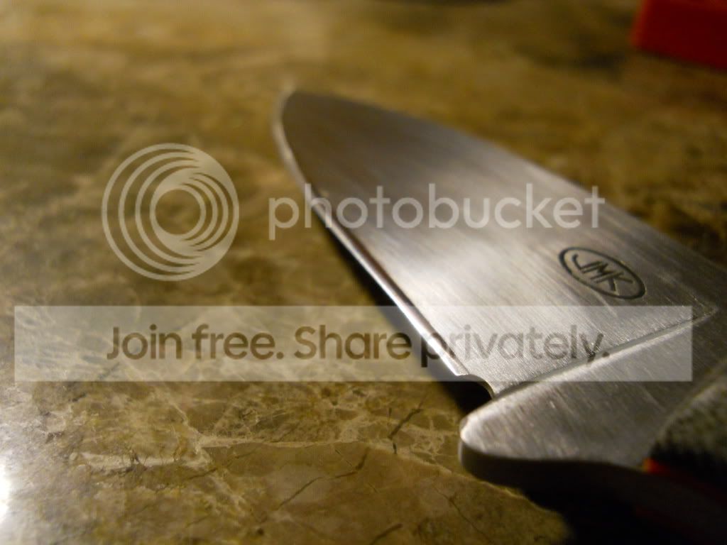

Johnny, that looks really nice. That's pretty much the same way I shape my handles, btw. A very nice looking knife there.
Is that final edge a hollow edge? Paper wheels?
--nathan
very impressive. I'm constantly amazed at your progress.
Wow, that is very nice of you to say. I know I've got lots of work to do on my finishing skills but I try to improve a little bit each time. Thank you!!
--nathan
Nathan,
Thanks man! I grind my final edge with a 220 Norzon blue belt and then hit it with a 320 SC belt and a 400 SC belt before taking off the last burr and polishing with a slotted paper wheel. Good eye you've got there!:D

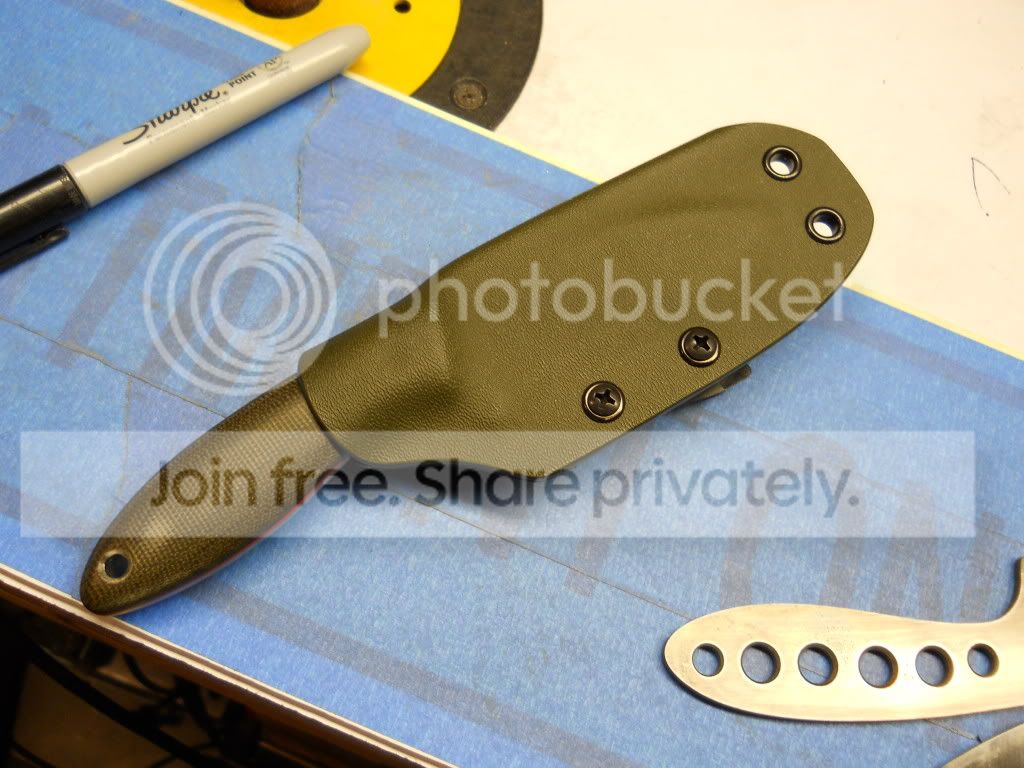

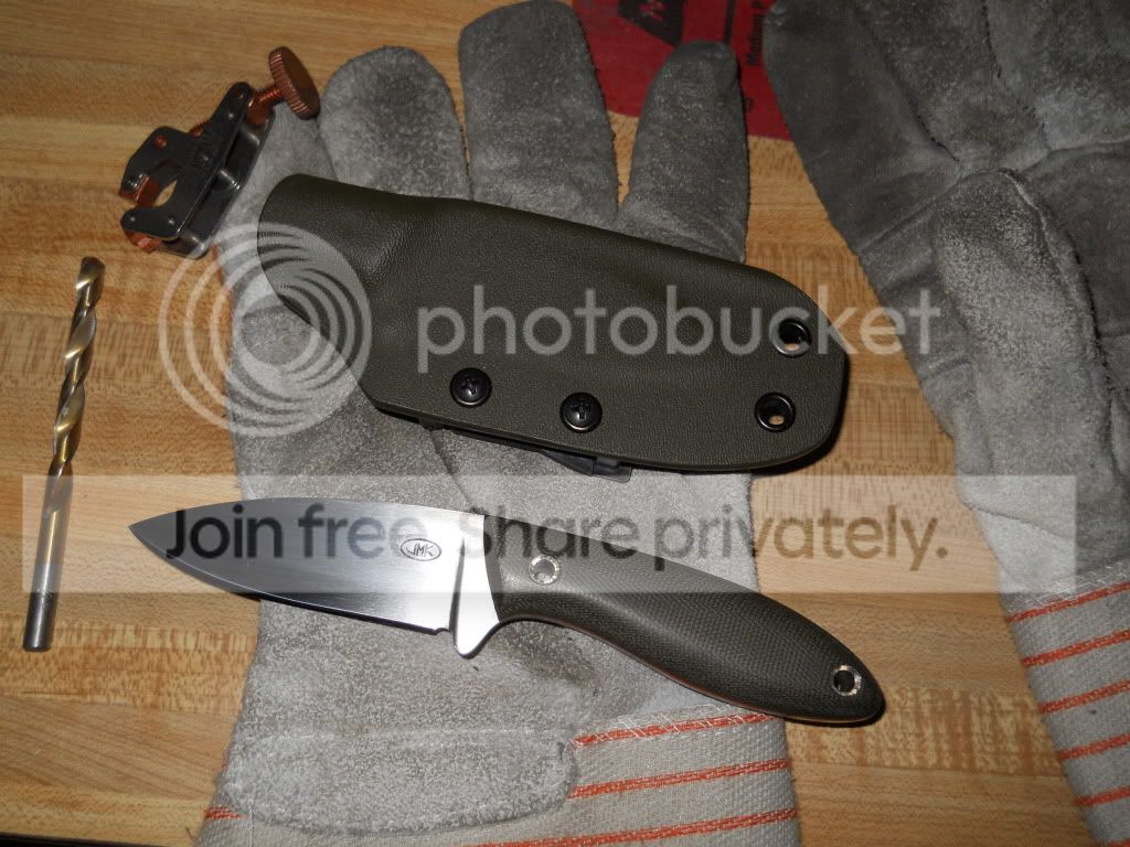

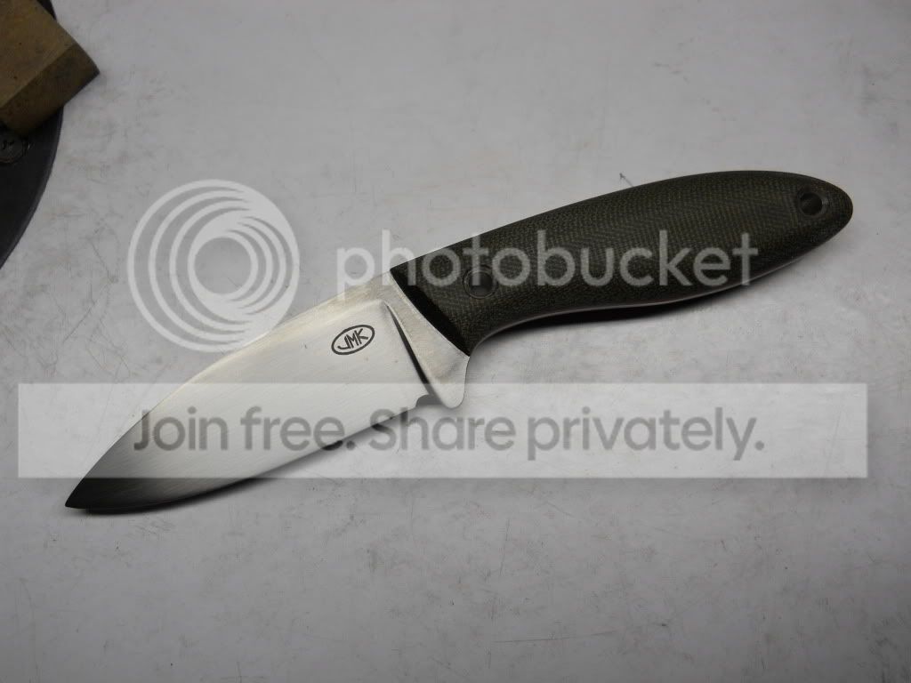

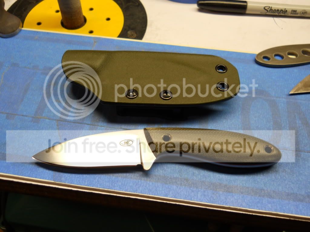

Here are the last few pics before this one ships out. Kydex is done. Set up for small Tek Lok and inverted paracord carry per the buyer's request.
