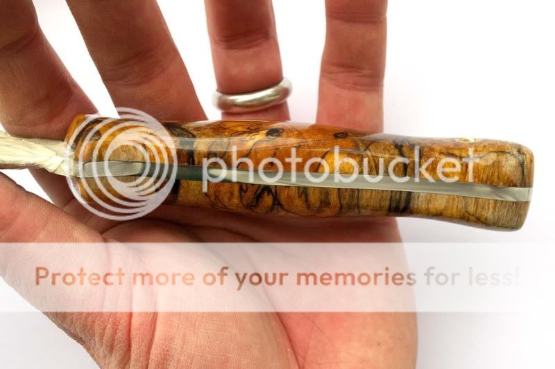

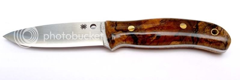

I ordered one of the seconds and left it to settle a few months. The cracks were almost invisible by that stage. I've filled the cracks and sealed the handle with multiple layers of cyanoacrylate (polymerised with linseed oil) and polished it up. It's a very durable finish.
It has seen heavy use since (batoning, etc.) and the scales remain solid.

Looks like a custom knife now. I guess it is. That sounds like quite a recipe you used for sealing.
Great pictures and fantastic result on the handle.

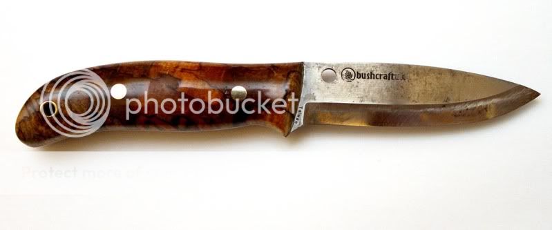

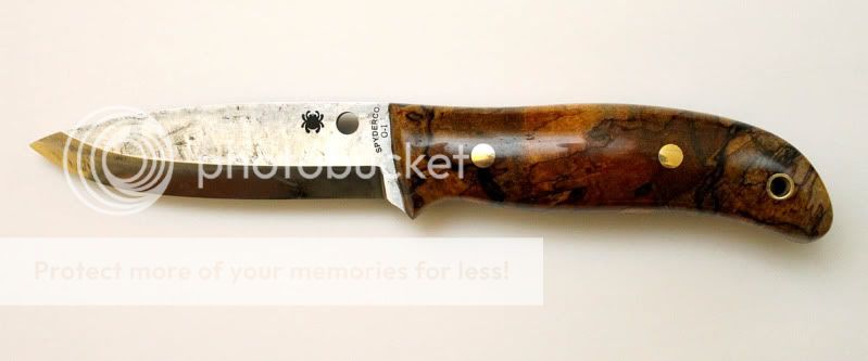

Here are a few pics of my knife, which has seen regular use this year:
There is some staining of the blade, which is not surprising as I do not pamper my working knives. It does get a quick clean and a wipe of oil after use. There is no pitting or rust (one of the pics above is misleading as the colour balance looks a bit orangy/rusty.)
Lazy field sharpening with small stones has distorted the zero/scandi grind but it remains perfect in function and easy to keep shaving-sharp. A good balance between ease of sharpening, edge retention and toughness. The G10 version will hopefully be the same.
The "cracked" scales have shown no signs of shifting or splitting. I haven't had any grip issues with sweat, rain or blood on the gloss finish. Some areas of the gloss finish have lost their shine and there are a few dings. The finish is not the factory standard (see original post.)

The cracks in mine were pretty small, thankfully.
The liquid/runny cyanoacrylate seemed to penetrate the cracks quite easily: little bubbles could be seen rising to the surface. I had to do several applications per crack as just dabbing more in meant more ran out, of course.
I had wondered about degreasing the inside of the cracks before filling but since the knives were shipped in linseed oil (which "reacts" and sets cyanoacrylate) I wasn't too worried.
I am no expert but so far it seems to be working.

After filling the cracks I used a gloved finger wrapped in cling film to apply cyano. This was then rubbed with boiled linseed oil. I repeated the process several times and sanded back to a uniform thickness after a couple of layers, before reapplying. Once I though I had a good thickness over everything I did final sanding a buffing. The cyanoacrylate is surprisingly hard to abrade, but takes a high polish.
I have heard of wood turners applying cyano and linseed to the spinning wood, but no direct experience myself.
