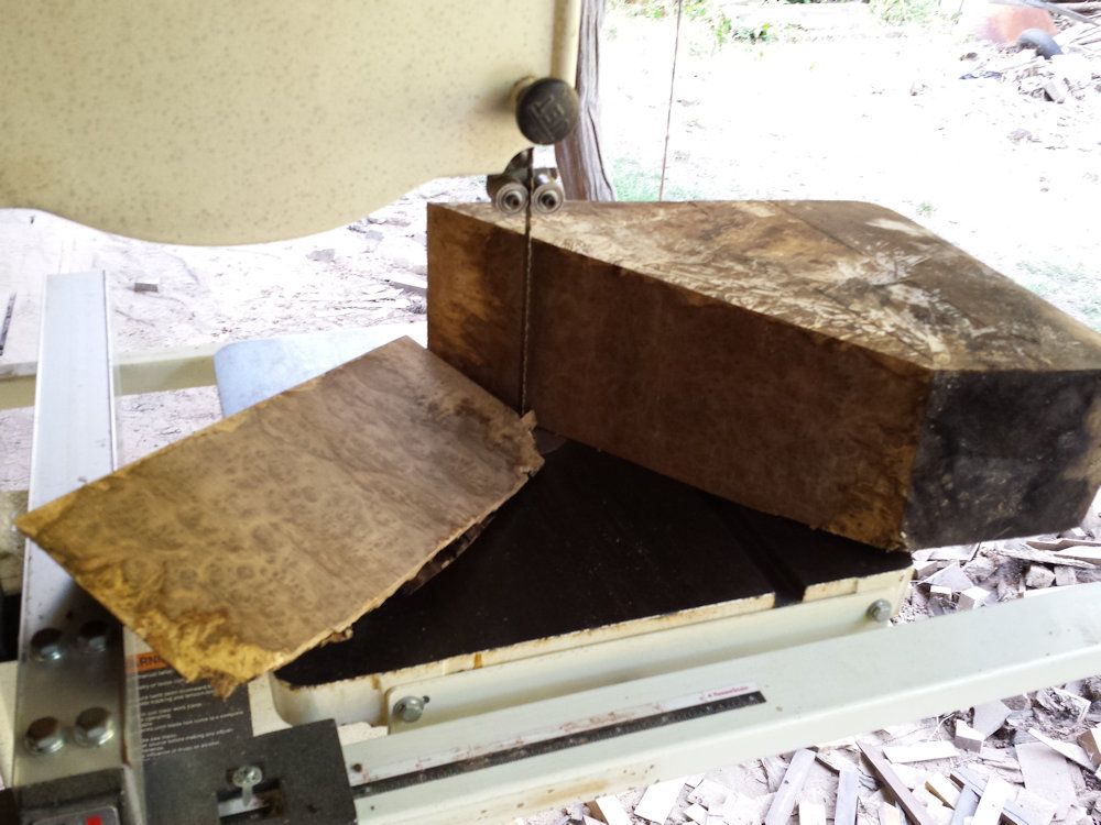

I split the chunk so I would have a manageable size to cut on the bandsaw.
The wood is currently over 35% moisture content.
Most of the color inside has changed from a light orange to a milk chocolate brown color.
I have cut it all into 1&1/4" thick slabs and will let them air dry in a dark area of the shop for a few days so some of the surface moisture will go away.

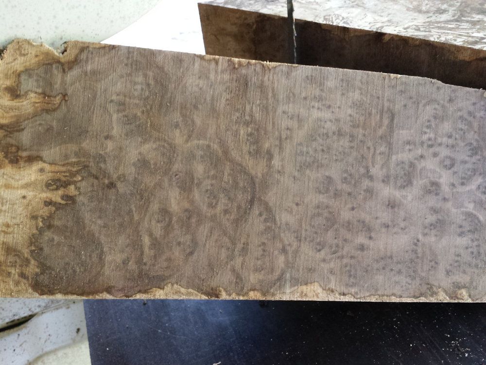

Here are some photos of the chunk I cut up. When dry the color will be kind of gray/brown.
Many types of wood would have turned to mush by now if I had treated them like this. But with Madrone Burl, this way works with very little waste caused by cracking and movement.

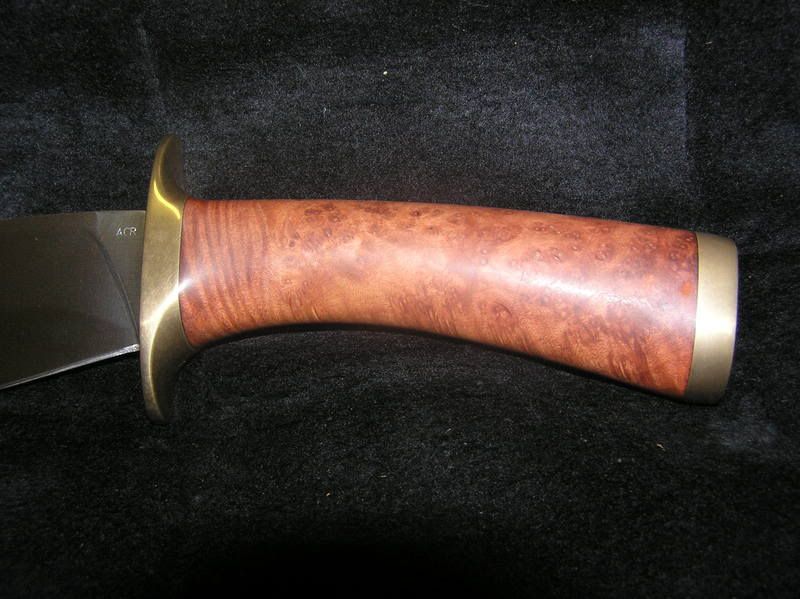

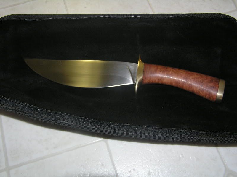

let me know how it works...I have tried many ways...knife handle is Pacific madrone burl and slabs are super dense old growth redwood

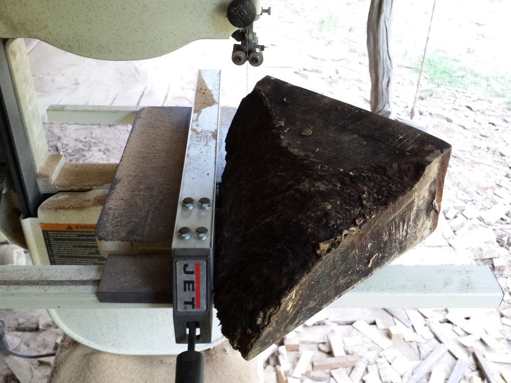

Here are a couple photos of the chunk coming out of the plastic.
Yep. I hate goo, but mold loves it. Dries up fast on plus side :) You might have a bit of blue stain going on, but spores would have been on the wood before plastic wrapping.

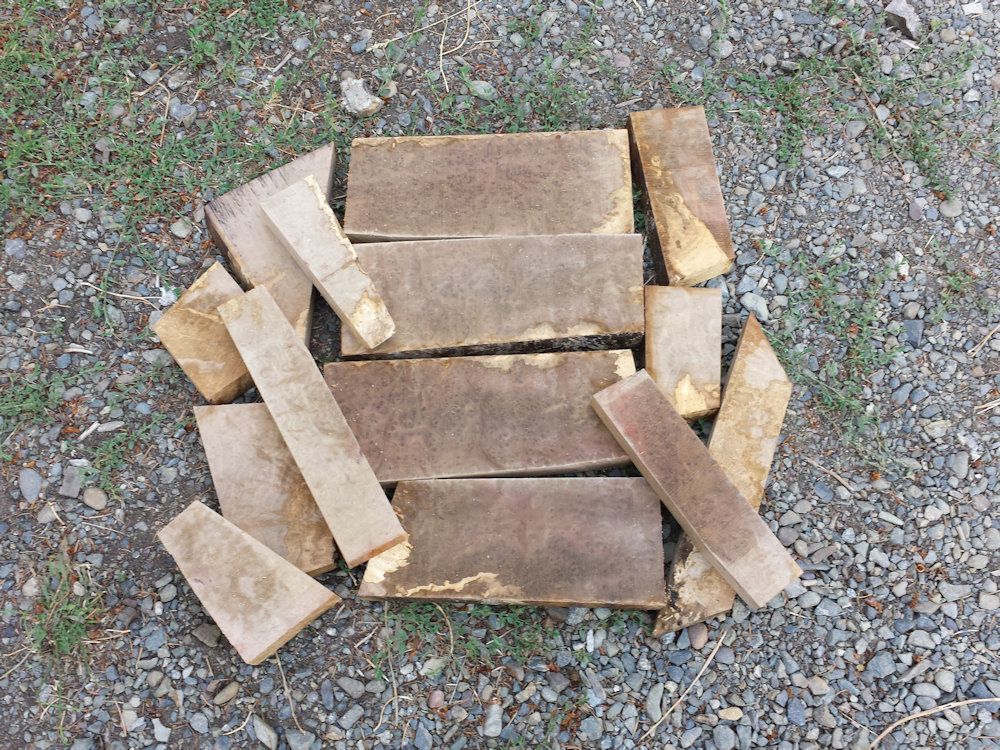

I got busy and the slabs were set aside in a dark part of the shop and forgotten. I was going to wrap them in paper grocery bags but they were stood on end instead. This way they had airflow around them for about a week. After that some of the moisture had evened out so I guessed it was safe to put them in the drying room on a bread rack with the fan and dehumidifier going.
This morning they were looking pretty good so I pulled them out for a closer look. Using a pin type moisture meter it read 10 to 12% moisture content. NO WAY THAT IS CORRECT. That was just the outer portion of the wood.
They felt a lot lighter in weight so I decided to thickness sand them and do a bit of trimming for a better look at how they were coming along. There was very little movement (warpage or cupping) and no cracking. That alone is a minor miracle with Madrone burl.
Drum sanded at 36 grit I can see if there are drying flaws and get a better look at the figure and grain patterns before cutting blocks.

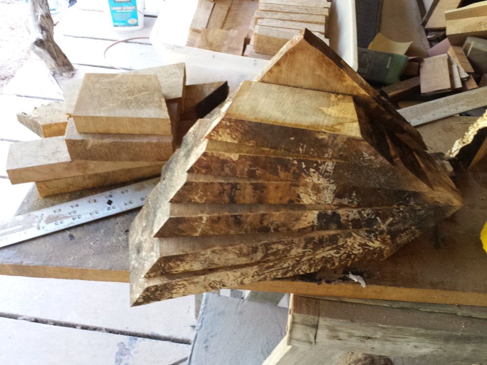

Here I found an old photo of when this wood was fresh cut in January of 2010.
