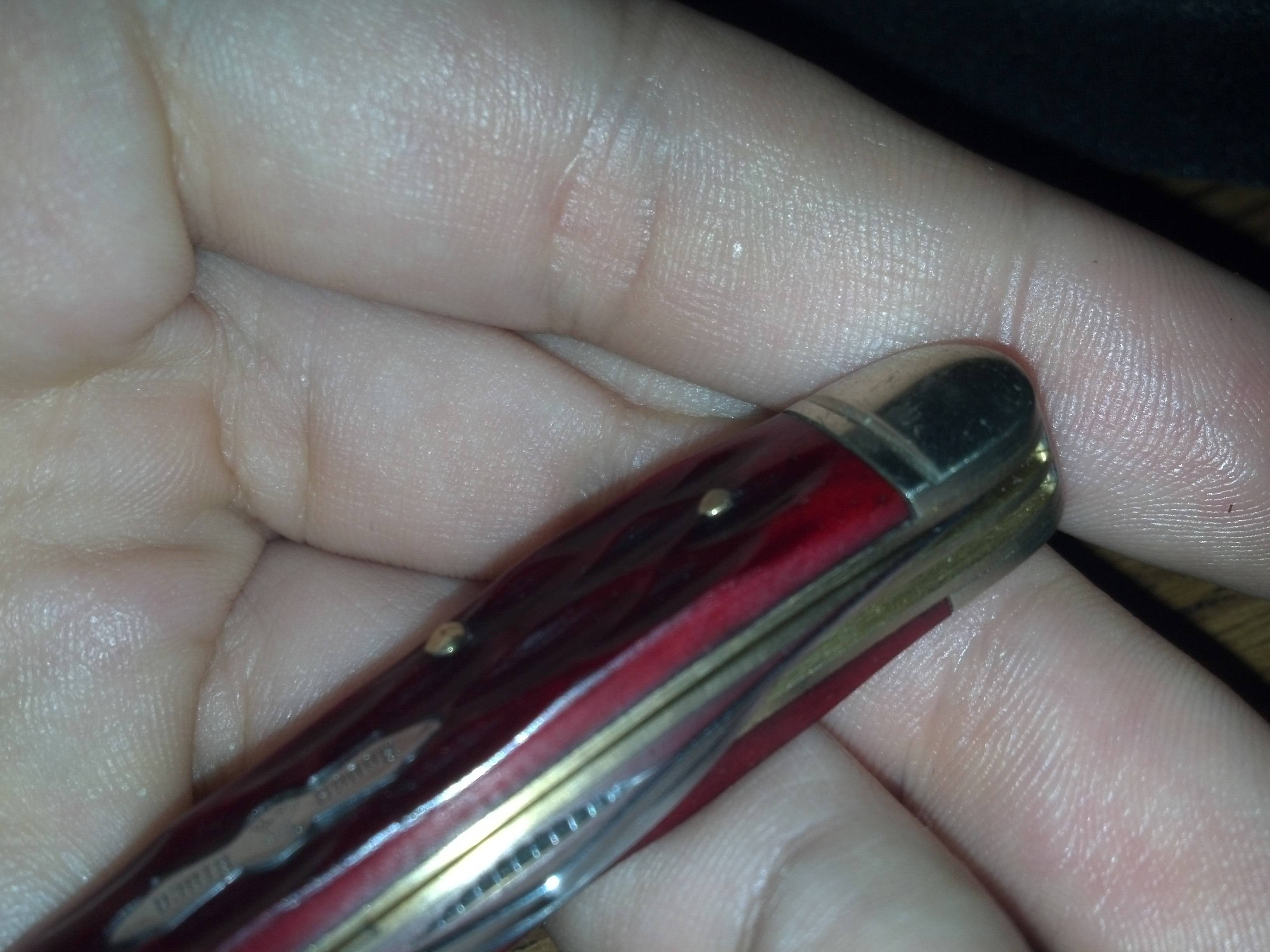

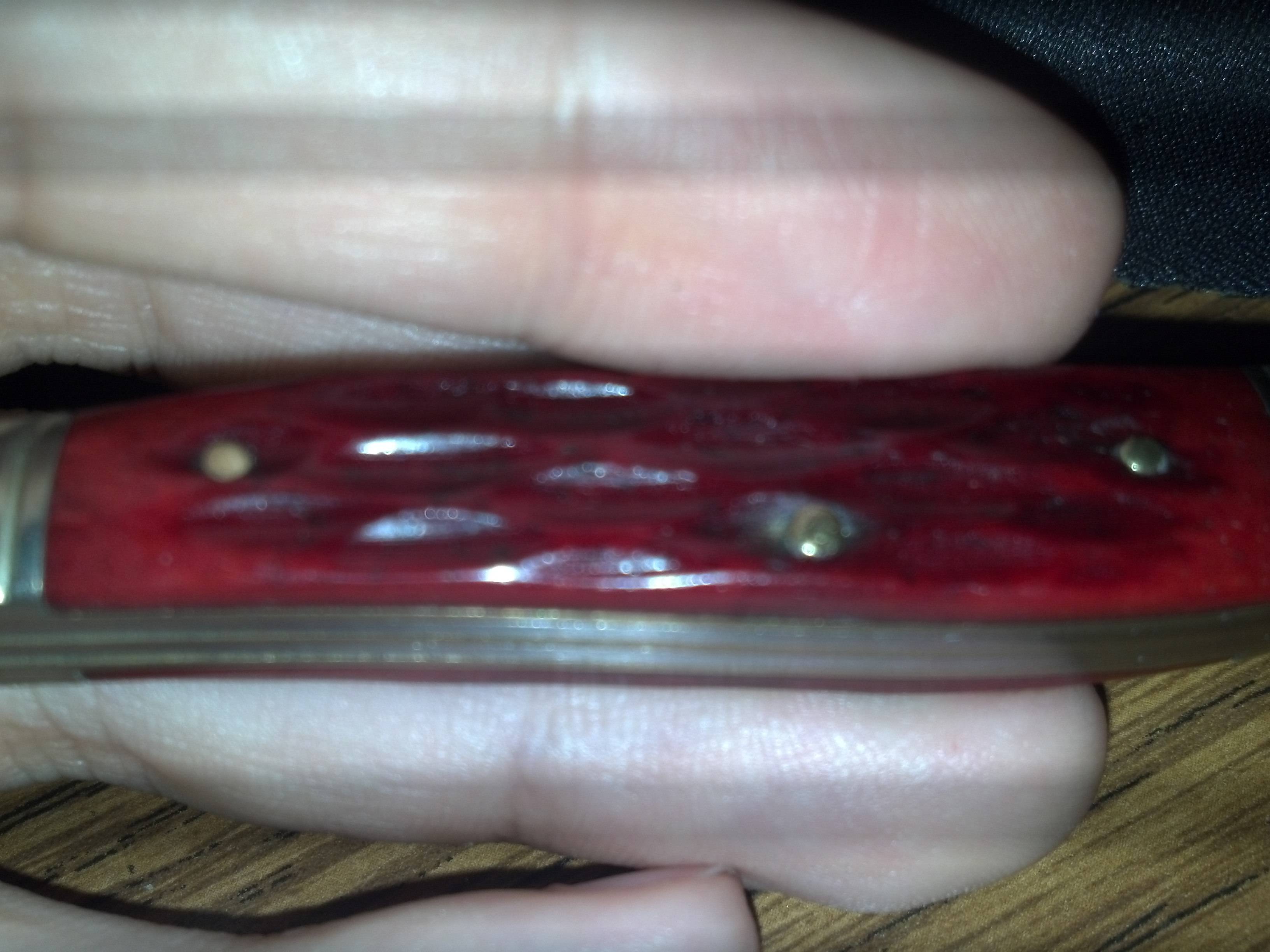

After reading the responses I got a bit antsy and jumped right into the filing and neglected to take before pictures.
Here is the picture of the back end pin which was at an angle - very happy with how this one came out. Scuffed the bolster a tiny bit but I'm fine with it.
And here is the backspring pin which was protruding further than I'd like. Due to the jigging you can still catch your finger on the pin if you're sliding your finger along it kind of hard but I'm satisfied with it.
Looks good. I had a Case Swayback Jack that you could catch your finger on the backspring pin a little. Also, the shield sat a little high, which I don't mind, but the edge was kind of sharp. I used a jeweler's rubber wheel on it and it worked very well. They are little rubber discs you use with a dremmel type tool. The nice thing about them is you can get very, very fine grit wheels, so I wasn't worried about removing too much metal, just wanting to smooth out the edges.
