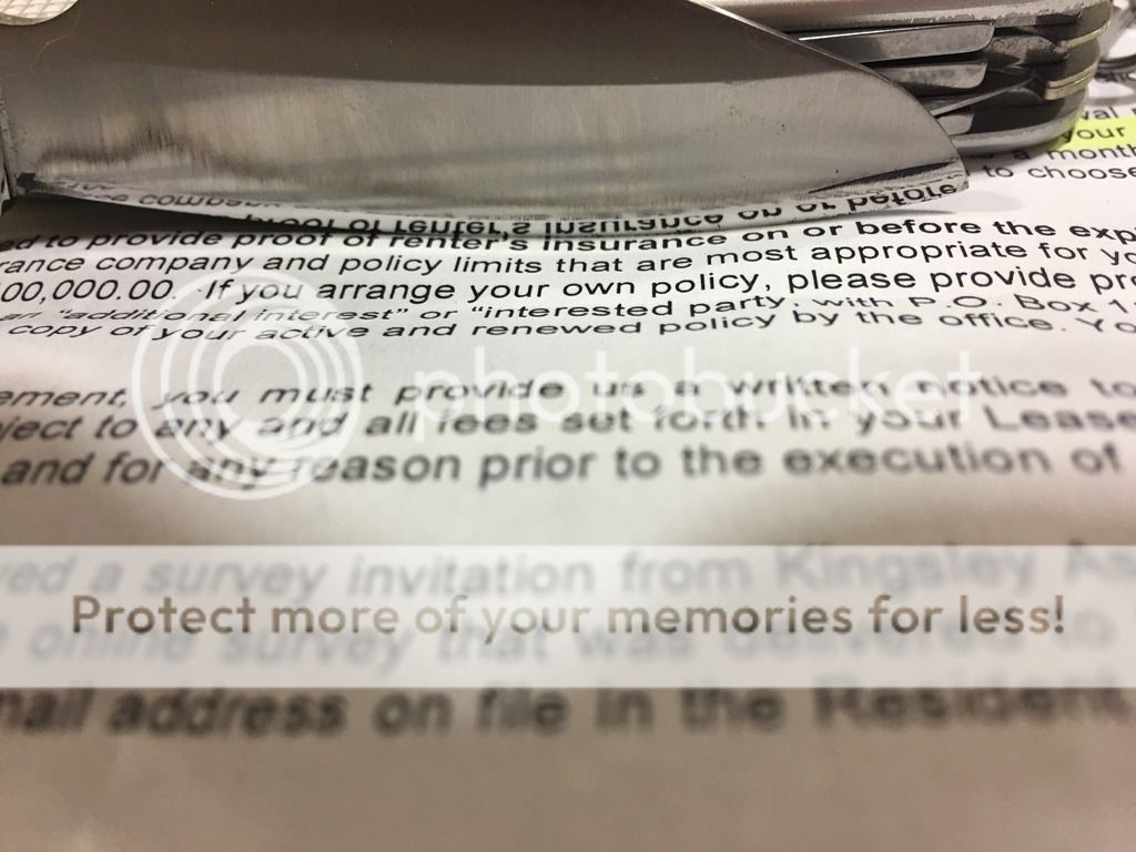

I have freehanded for awhile and have a Wicked Edge system. Before I dropped anymore money on stones for the Wicked Edge I wanted to try paper wheels. I used a sharpie to cover the edge and went at it with a big grin.
First knife I tried was my Spyderco Salt. Its a user and well loved. You can see I was a bit low at the back but that wiped off. ( I should have wiped it off first but I was shocked that just a few passes brought out sweet shine.)

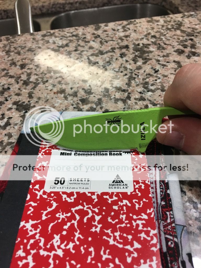

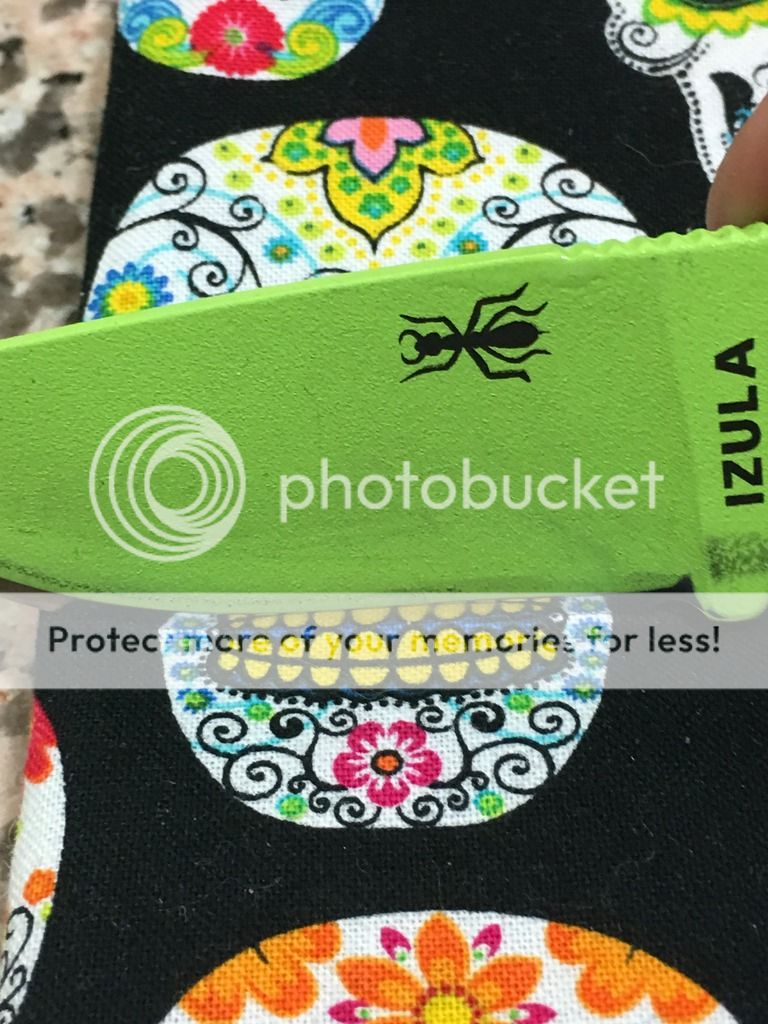

Next up my Izula. Another loved knife.
Overall I am very happy. These 2 knives were done with 15 minutes experience after just getting this all setup today. I am sure with more practice the results will be better. Now its time to tackle the kitchen knife that my lovely lady likes to use on paper plates with granite counter under it. :eek::yawn::D It will live again!!
