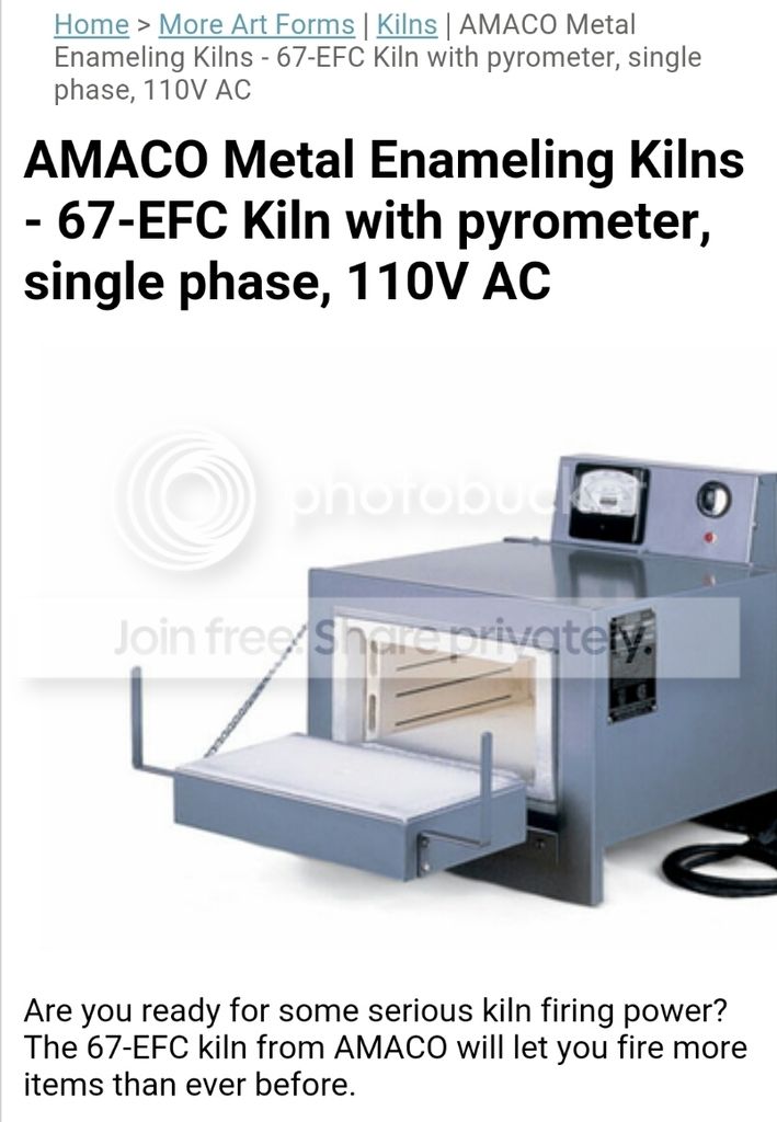

I recently came across a front opening jewelry kiln that I couldn't pass up.
It is in great shape and runs off of 110 with an analog temp gauge.
Is it possible or necessary to upgrade to 220
and install a PID so i can heat treat O1 and cpm 154?
Thanks for any advice.

This is the kiln. It has a thin layer of fire brick? With slots where the coils are for protection probably so I don't electrocute myself.
Not sure about an interrupt switch, I'll try to download a manual.
That fire brick is thicker than you think it's at least as wide as the top and sides of the structure. Most Furnace/Kilns have the coils inset like you see here in the photo I would bet that there is an interrupt switch on the far side where the chain is attached or on the bottom of the door hinge so when the door is open it opens the circuit. It does have a Red Power light not sure if that is connected to the coil and the light goes off when the door is open or if its just an ON light letting you know the unit has power. I've seen the aftermath of what can happen when a piece of metal gets away and hits the coils not a pretty sight killed the coils killed the control unit of a VERY expensive unit here where I work (like $80K and lucky the operator just got some minor injuries). It's hard to tell from the photo if the controller would fit that Back Splash where the existing controls are?
