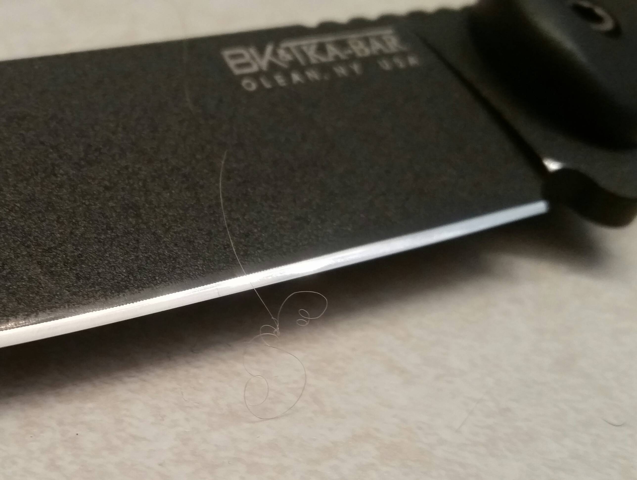

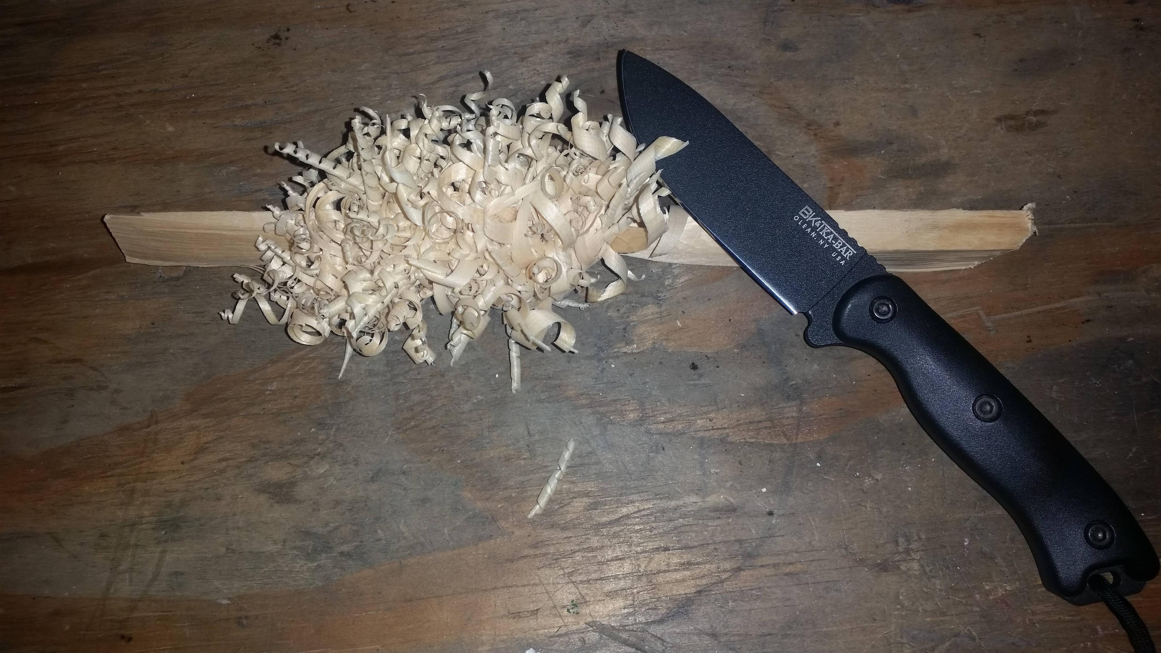

Once you get the hang of it, it's pretty simple and yields great results. I use the blade grinding attachment mainly and after stropping I have an edge that'll whittle hair easily.
Yea definitely worth it, it's probably one of the best investment I've made. When I can get an edge that whittle or cut straight thru my 5yr old daughter's fine blonde hair I know my knife is ridiculously sharp. Thou I typically don't take em that far, I only did this to win a $50 bet with a guy who said the work sharp couldn't do it.

However, your last post is most impressive! I have never come close to this degree of sharpness with the Lansky. I'm sure there is a lot of additional skill involved but the potential for improving what I'm currently doing is there. I'm going to make the jump. Thanks for your help.
It's all about technique, you'll quickly discover what works for you. I've also found once you wear down the belts to where they're no longer effective you can take em and apply a lil stropping compound to em and use it as your final step. You'll end up with close to a mirror polish and a hair popping sharp if not hair splitting sharp edge.
