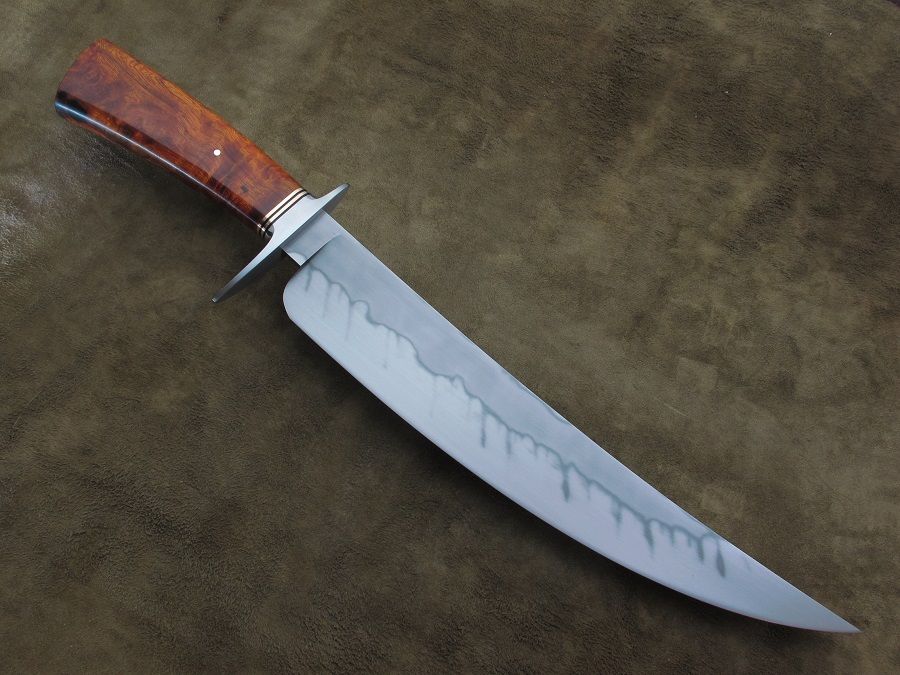

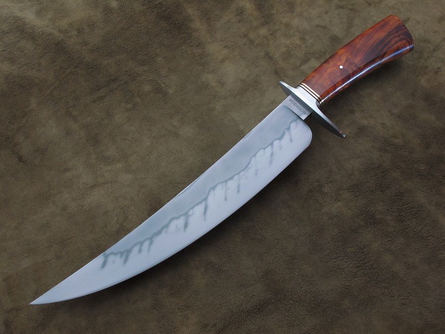

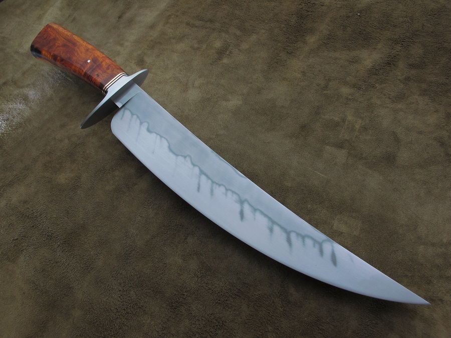

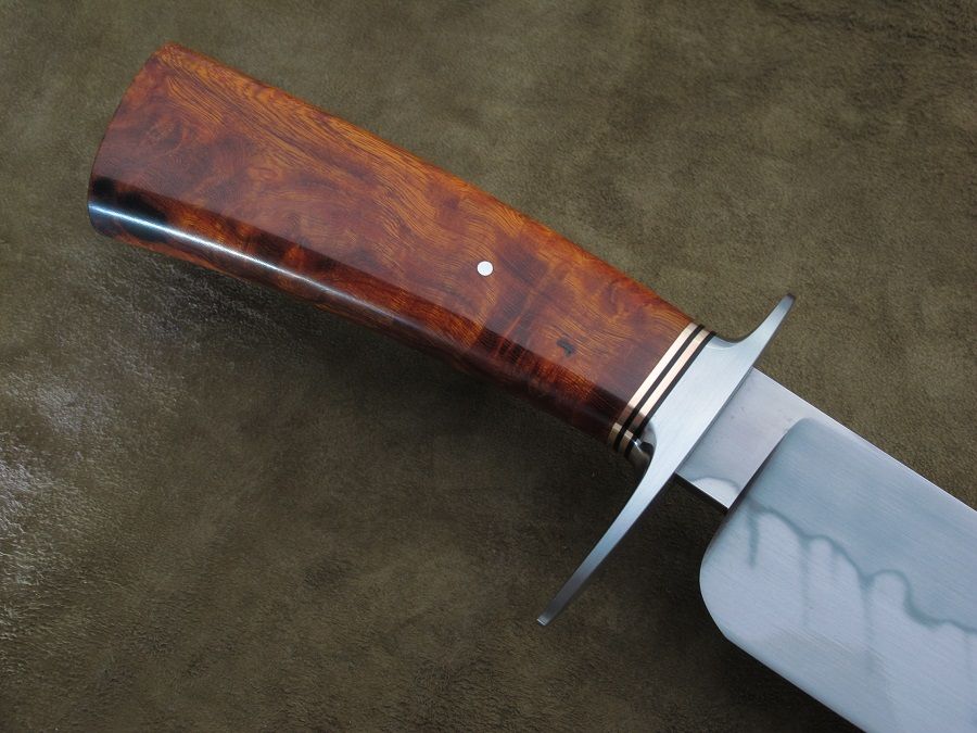

Finished this one yesterday.
The blade is 11.25" of differentially hardened W2 tool steel, 0.25" thick at the ricasso. The handle is Desert Ironwood with a 416 stainless guard, and phosphor bronze and black G10 spacers. The overall length is 16.5".
Thanks for looking!
