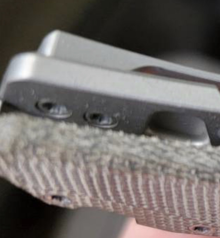

Snagged two in the recent drop. Impossible to clip or remove from pocket unless your pants are literally paper thin. How does this get past like every reviewer? Did I miss the part in the review vids where they stopped raving about it and said "oh, by the way, it's IMPOSSIBLE to pocket." (Yeah, I'm a junky, I watched all the vids I could find before I snagged em).
I've attached the photos to this thread so you can see just how much force it takes to move the clip to its max which is almost a full width of the human hair. Huzzah.
Hopefully UrbanEDC steps up and sends out replacement clips. They are cool knives. But I kinda wanna be able to... Pocket... My pocket knives.

Looks like it needs more of a ramped angle on the end of the clip.

That sucks, looks like the clip on the ZT 0804CF. To this day, I honestly do not believe one of those has ever been carried by anyone (the clip design is unique and nobody makes replacements).
Too bad because it a hell of a knife. (At least It is on paper, I’ve never carried mine)
…And I actually had 2 at one point. When they were discontinued they were selling for only $200….so I bought another thinking surely enough SOMEONE will make a god damn spacer for this terrible but unique clip. Nope

The tight clip thing happened to me a lot when I wore Duluth's regular Fire Hose pants, the edge of the pockets are thick on those puppies, but they're warm and protective. Since I switched to their lighter-weight Duluth Flex pants I haven't had that problem, but I doubt I could clip the knife in your photos.
I've taken off the sheet metal type clips and bent them and it works, with your I wonder if you couldn't just take off the clip and cut down the "nub" at the end of the clip with a Dremel and re-install it. If I otherwise liked the knife, I'd try that or search for aftermarket clips that suit you better.

Bend the clip a bit?

Best would be to remove the clip and reshape with a Dremel, but you could also slide some fine-grit sandpaper underneath and sand the nub down that way, then proceed to coarser grits until you get optimum clearance
