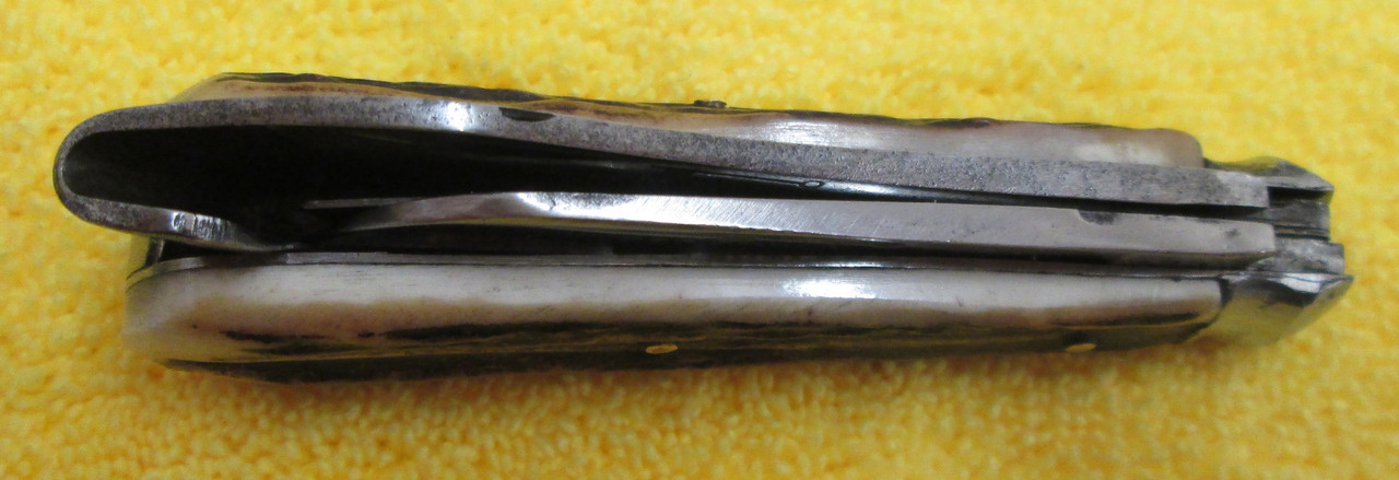

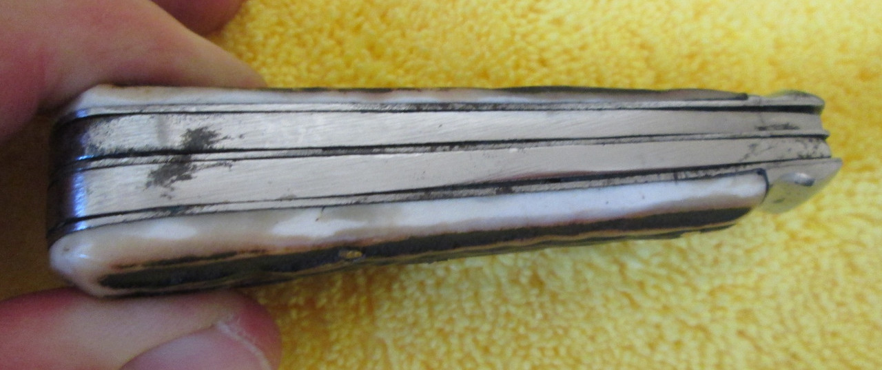

Here's the knife I showed Stan, by Joseph Haywood. Natural light is long gone here, so these will have to do:

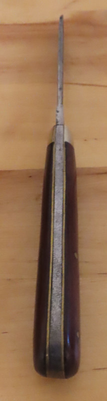

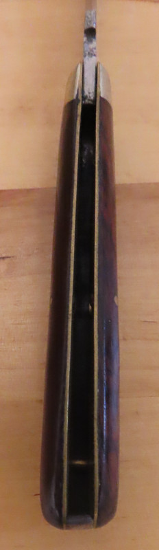

Here's a very unusual Rase Knife by George Butler, where the springs are tapered, but for a reason :)
