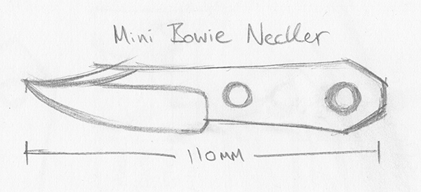

Little tutorial on how to computerize a knife design, this is useful for refining the lines, proportions and size.
I'll be using Inkscape, which is free to download and use.
As always start with a sketch.
You can transfer this to your computer by either scanning it or taking a pic with your phone and emailing it to yourself.

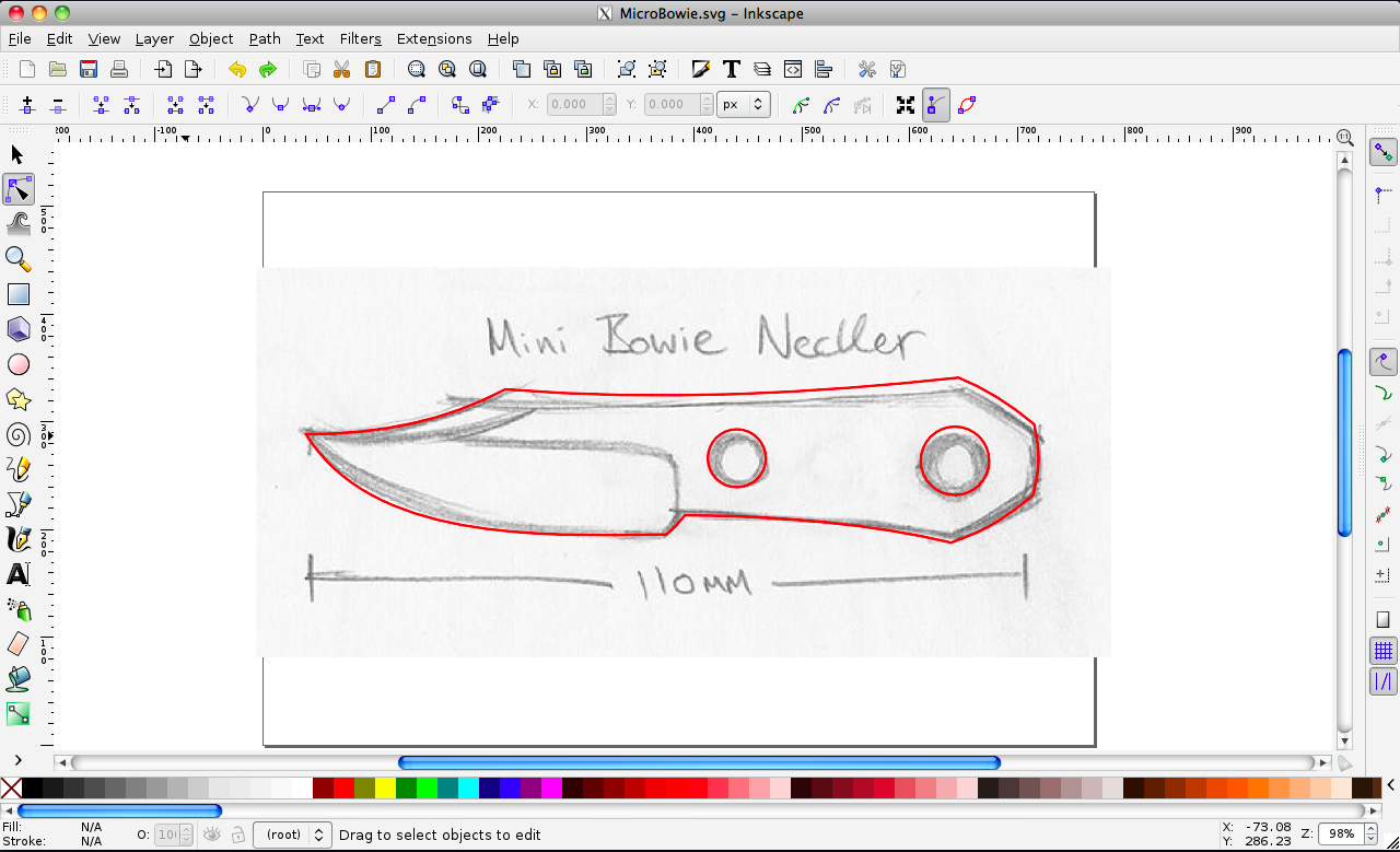

Once you have it on the computer fire up Inkspace and select the image from File>Open.
This is the first tool we will use.

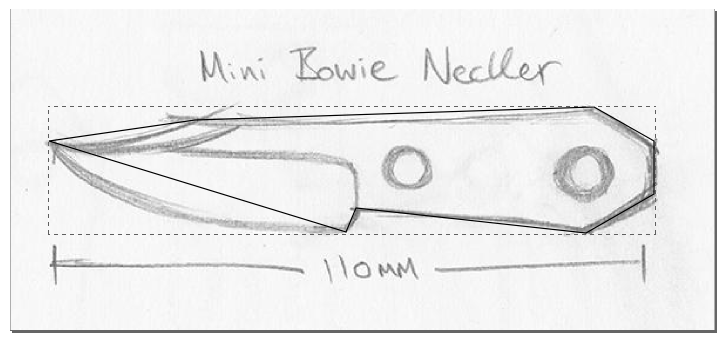

Use it to create the basic profile of the knife, start by setting a point at the tip and go around the knife creating points anywhere else there is a sharp corner, finish by clicking on the first point you created to complete the shape.

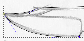

At this point all the lines will be straight so we'll use the next tool to add some curves.
You can either drag on the lines you want to move or select a line and use the handles.
All done.

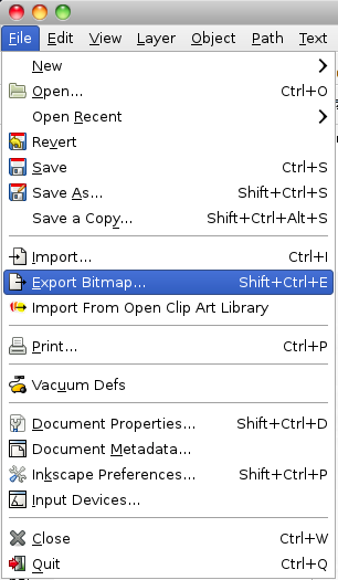

From here you can save your file as either an Inkscpae file from File>Save As or you can create a .png by going to File>Export Bitmap. This software will also allow you to create a .dxf file which is what you'll need if you want to send your design to a waterjet cutter.
