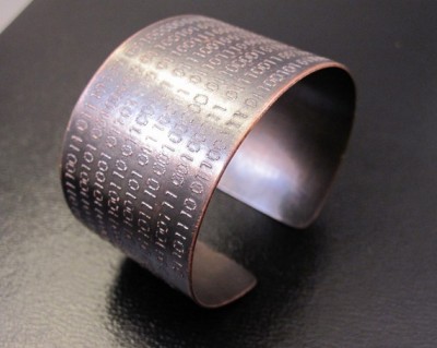

I use copper in a lot of my work. For a nice brown to grey finish, I prefer a soak in Liver of Sulfur and then brushing with a soft brass brush. You can then "seal" it with renaissance wax.
EDIT: Here's a sample of the look.
