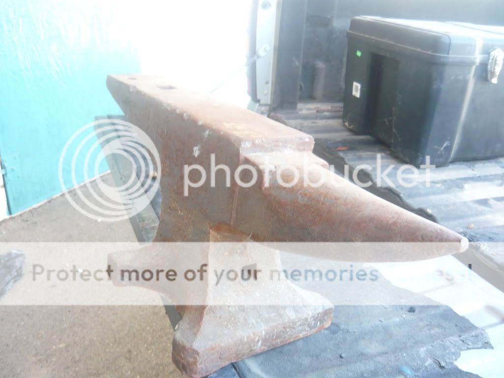

So, I need an anvil. Been looking around and found a guy on Craigslist selling a Hay Budden Anvil for 350. Its a bit dinged up, couple chunks out of it here and there and 350 sounds steep to me.
So, what do you guys think?
Thanks a lot for any input, brand new here and after looking around on the net this seemed like one of the better places to ask.
It's hard to guess what would weigh, from the pic, but guessing
it's over 150 lbs, it's a hell of a deal...!
You can crisp up the edges by grinding into the sides, not down from the face. It's worth it, not a great price but a good price.
Thanks a tonne guys, this makes me feel much better about this. Going to try and go look at it tomorrow. The seller hasn't responded to how heavy it is so I can't say but you folks no better then I and all I'm hearing is a resounding "Buy it". Most likely I'll bring it home. Now to find a stump/stand for it.

Just found out it's a 125#er.
An absolute steal if it has not been through a fire.
So... I did a quick search and couldn't find anything about anvils being ruined in fires. Excuse my naivete but is there any way to know this? When I go and look at it this afternoon is there anything I should do/look for?

Hay Budden is a good anvil. If you get it for less than $2 a pound you got a good deal. Above that you pay to play. This one looks to be in real good condition. If it rebounds nicely and there's no cracks or repairs then it's all good.
