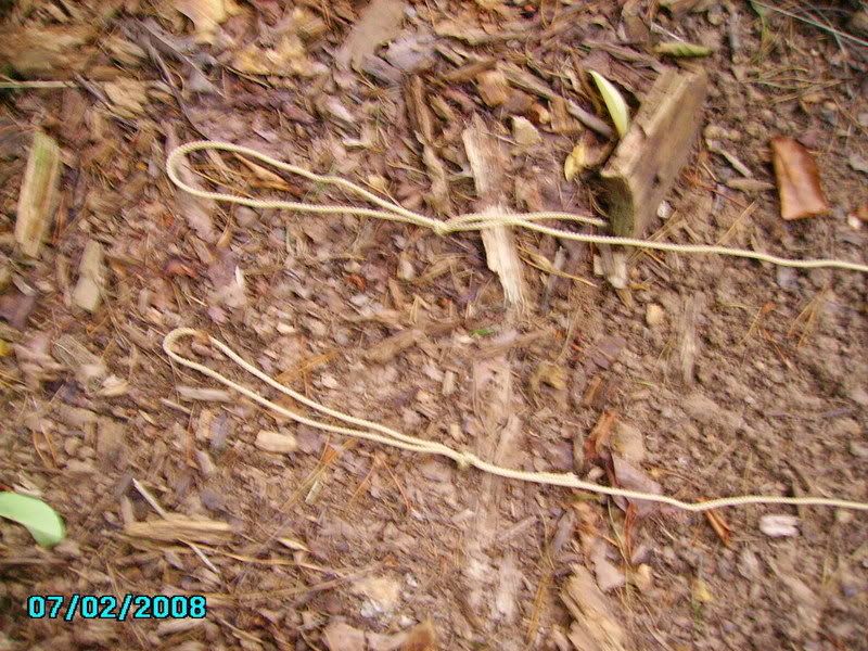

Then I pre-tied some loops in four pieces of string, with the first two being only about a foot long or so,( you may want to wait on the second two to avoid waste).

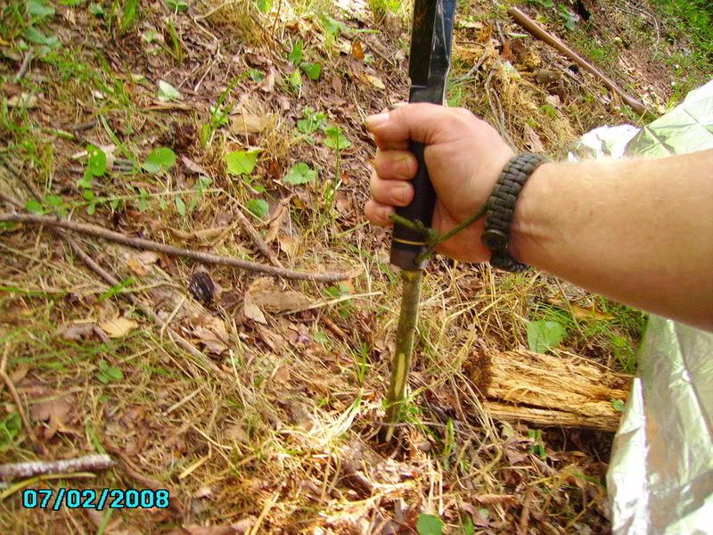

I pulled the e blanket across the ridge to a position of roughly ¾ on one side and pull the long side till it touched the ground and this was where I drove my stakes at an angle leaning away from the shelter and just a bit wider than the material to help keep it taught. The stakes can be driven with the pommel of a knife if it's all you have available. but a good sized rock works well also.

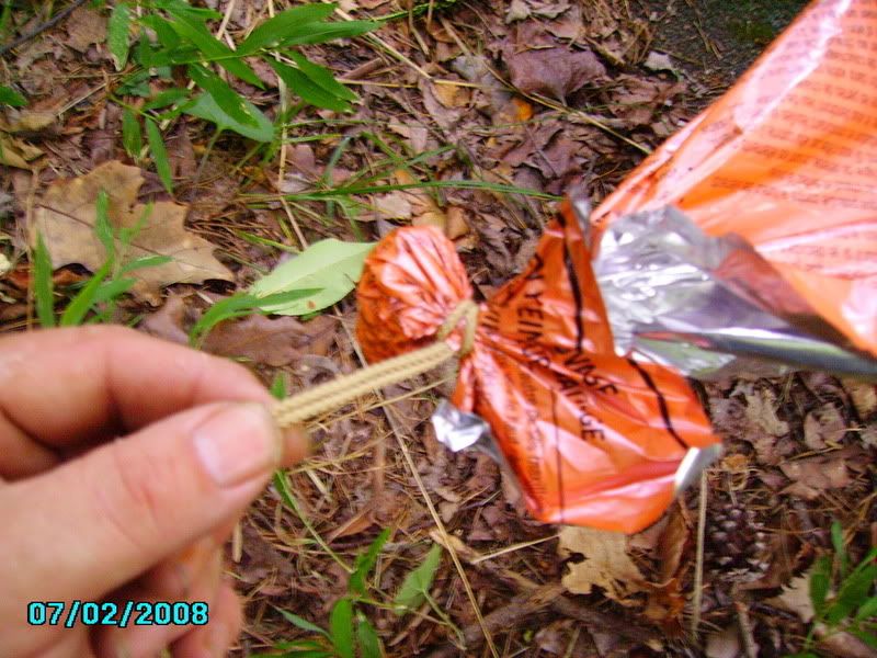

I took some debris(also known as duff), and placed it on the corner and wrap the material around it making a ball

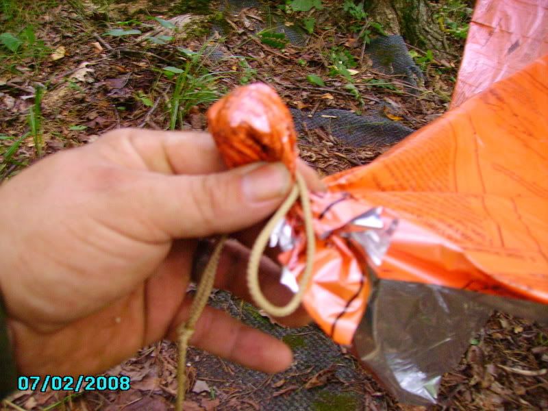

Then I took the loop and wrapped it around the ball.

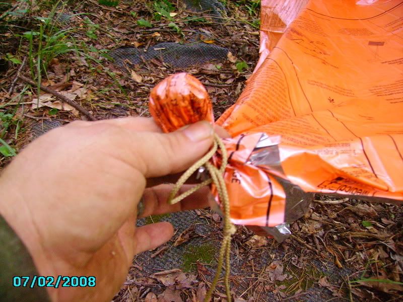

Then pulled the working end of the cord through the loop and tightened it.

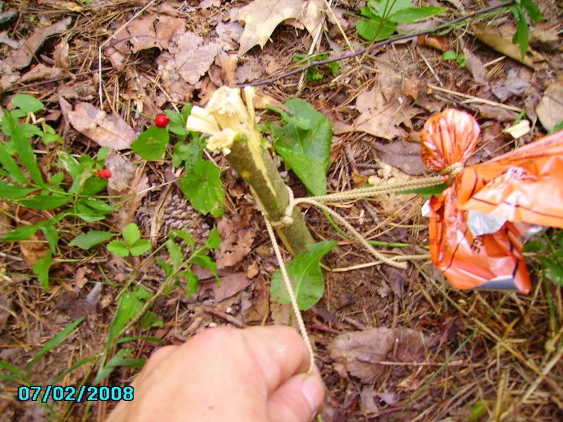

Then just tied it to the stake
I repeated this step on all four corners doing the back ones that touch the ground first, then using the front ones to tighten it all up.
