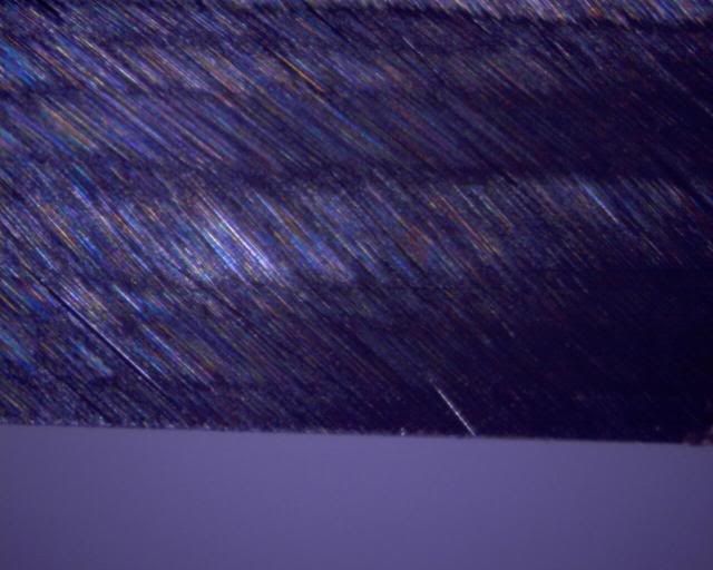

Hey all,
when sharpening, I like to check my edges under a magnifying glass.
This gives you loads of information during sharpening, and interesting observations, such as:
- did your edges come together?
- how is the scratch pattern
- did you get your angles right?
- are there small chips
- is the angle consistent over the blade
- which part of the edge needs more attention
- what's up with the tip
- large micro serrations
- state of polishing
- what is the state of the burr
- how does gunk look on your edge
etc.
I found this to be very valuable when I learned how to sharpen, since I could now actually see what I was doing, which is not possible by just looking at it.
By seeing how the edge looked like under the magnifiying glass I could verify what happened and I could now reference that to what I saw with just my eyes. Making it easier for me to spot things without magnification when i learned this skill.
I started out from the beginning with a doublet that gives me 10 times magnification.
I recently purchased a triplet, essentially a better lens system with 20 times magnification consisting of three lenses.
It rocks! Gives me a better level of detail, the magnification is great to check you blade :thumbup:
I'm curious as to what you guys use and what your experiences are, but I definitely recommend a tool such as this.
I use it in combination with a simple flashlight (in this case a fenix e01) to provide the light and put the triplet very close to the blade and my eyes close to the triplet.
Here are also some pictures (the black one is the triplet), unfortunately, I don't have a macro function on my camera, so what you see through the triplet on the cam shot is nowhere near the quality and magnification you would get with normal use.
attachment.php
attachment.php
attachment.php
this is not my pic, but gives you an impression of what you could see (detail level wise)

Zyhano, I use the same . A triplet from Radio Shack (larger lens) and a Maglite flashlight .
I'd prefer a 5X lens on my head-set but haven't found one . As this would give me more hands free to work and both eyes with less fatigue . I've found that atleast a 5X is a must . It allows you to really see the burr and whats going on with your sharpening . Good write up . DM

Just searched around a little. I got mine for about (euros to dollars) $30. It's high quality triplet though. 2 times magnification is bad. I'd say you need at least 5 (loupe) or ten (doublet) times magnification to see anything at all.

the bigger the magnification, the better you can see what's happening. For a quick peek to see what's up, a small, more portable device is more handy and quicker to use though.
