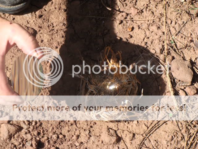

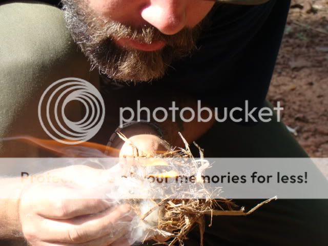

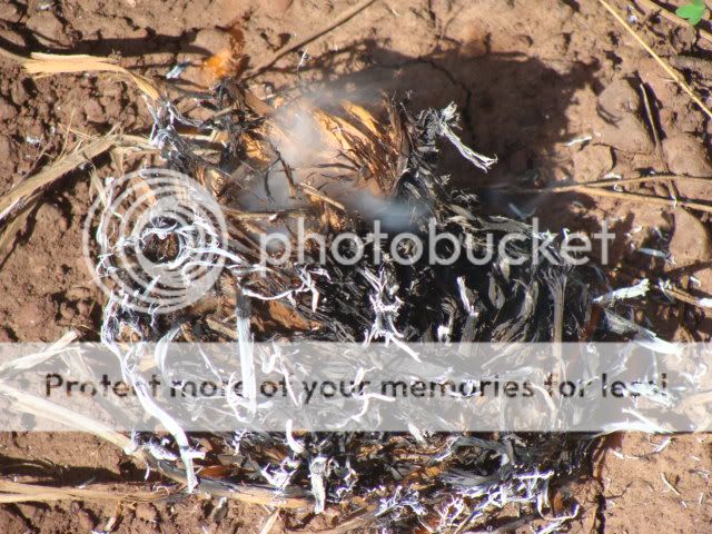

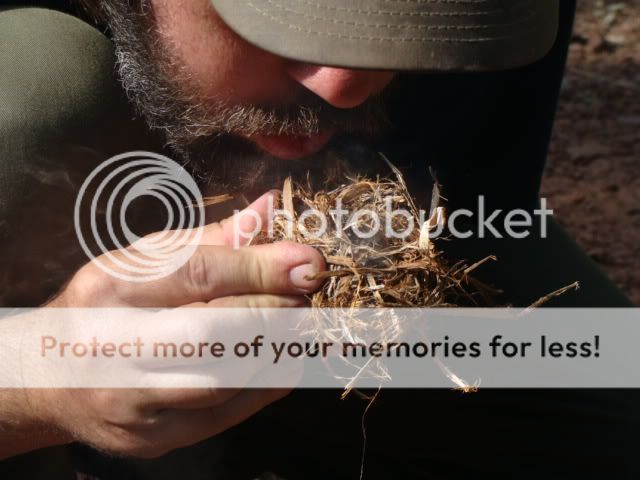

My wife carries a small glass one in her first aid kit and it has been awhile since I have practiced this method. It had rained the day before and the tinder was damp, too. It was about 1550 in the afternoon. The small tinder bundle is made from Shaggy Juniper.

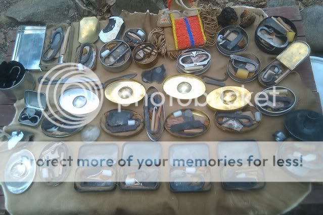

Here are some magnifying glass setups from a friend's collection. I thought they were neat
