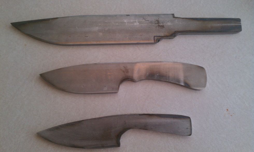

The steel is from Aldo and it is 1/4' 1095 which in hind sight was much thicker than I probably needed for my first knives.
Here is how they turned out. I have a little more to do on the curves but so far I am pleased.
