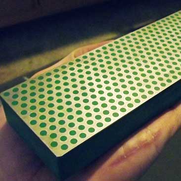

I formed most all of my sharpening habits holding pocket-sized hones in one hand, and the blade in the other. Really became spoiled in holding the stone with one end of it toward me, so that I could get a clear look at the edge-to-stone contact as I worked. So, with any 'bench' hone that's maybe 6" or smaller, I actually prefer to use it in a similar manner. As a side benefit, I've also come to believe it's much easier to regulate pressure using a stone this way; it's harder to use excessive pressure, as might happen if 'leaning into' a stone laid horizontally on a bench. This sort of interplays with feedback as well; the 'lighter touch' I get in this manner seems to make the fingertips more easily feel the stone.

The pic below shows how I ordinarily hold my hones (this example is of one of my strop/sandpaper blocks, which I use in the same manner). Also shows why I do this with hones that are maybe ~6" or shorter, as my hand wouldn't span anything much bigger. Depending on thickness of the stone/block, sometimes only my thumb/fingertips will be in 'the sharpening zone' above the surface. Otherwise, my hand & fingers are ordinarily out of the way. The exception is with smaller pocket-sized hones, which are obviously thinner and shorter. I have nicked a fingertip or thumb on occasion, using those; especially with my oft-used DMT 'credit card' hones. Just forces me to pay attention, and take everything nice & slow, and keep pressure at a controllable level. ;)
