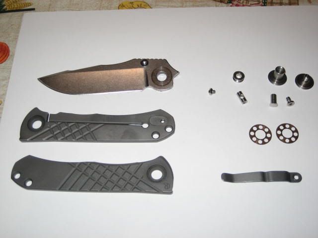

When I got my umnumzaan in a trade, I took it apart and cleaned it thoroughly. I took a pic of the parts. Teflon tape might work, I never tried it.
