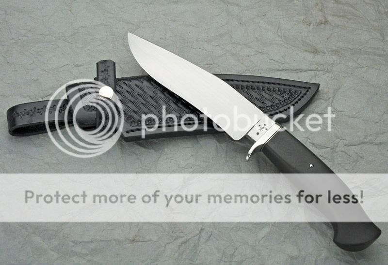

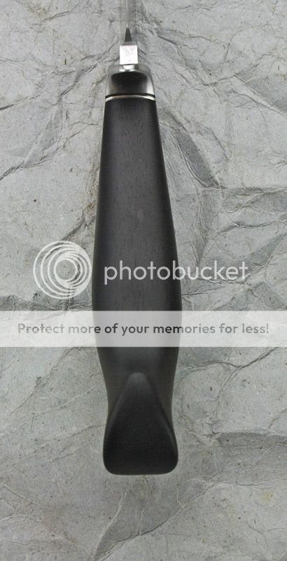

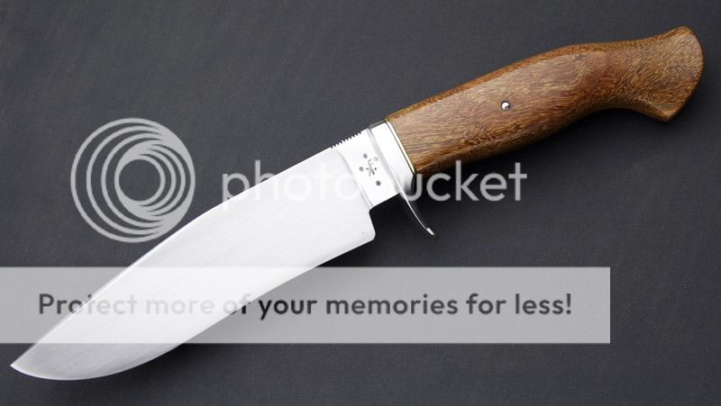

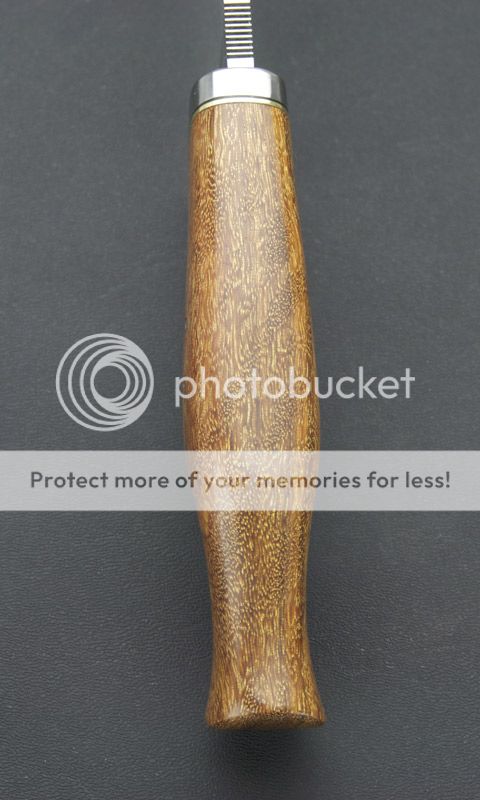

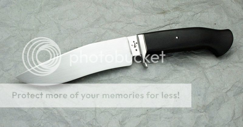

Here are a couple of Utes that I'll be taking to Blade. These are a new design that I will be making as a standard from now on.
Thanks for looking and would like comments on it, thanks in advance.
Specs
BL 5 1/2", 140mm. OAL 10 3/4", 275mm. Thickness at Ricasso .2170", 5.56mm
1075 Carbon. Flat ground with a convex edge. Stainless guard and spacer with black fibre. Australian Ironwood handle, domed pin. Hand tooled leather sheath.
Same specs with ebony.
Cheers Keith
