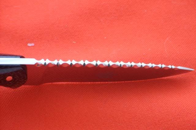

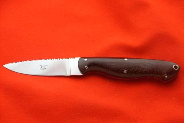

Just finished this knife for a customer who likes to wear his knife on his Backpack while Elk Hunting. The sheath can be worn on pack strap(Verticle) or on a Belt ( Horizontal or Verticle)
The Knife is my Utility Drop Point Model
Steel:1/8' 154CM@RC61/62 Cryo'd
Blade:Length-3 3/4"tip to handleWidth 1 1/16",Flat ground,Mirror finish,File Worked Spine
Handle: Burlap Micarta(Old Stock from the 60s)
Sheath: 8oz leather,Handstiched and Wetformed
Thank you for looking and all comments are welcome
