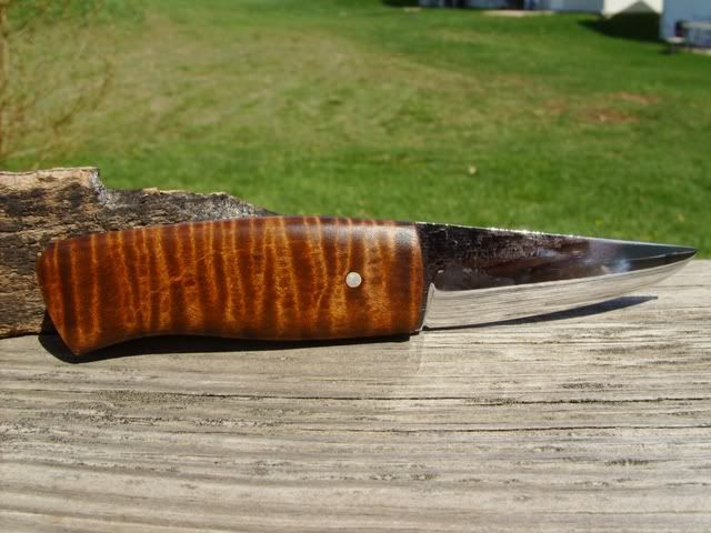

This is my latest knife. I don't have any of the knives I have made because I have a tendency to give them away to friends in need of a top quality knife

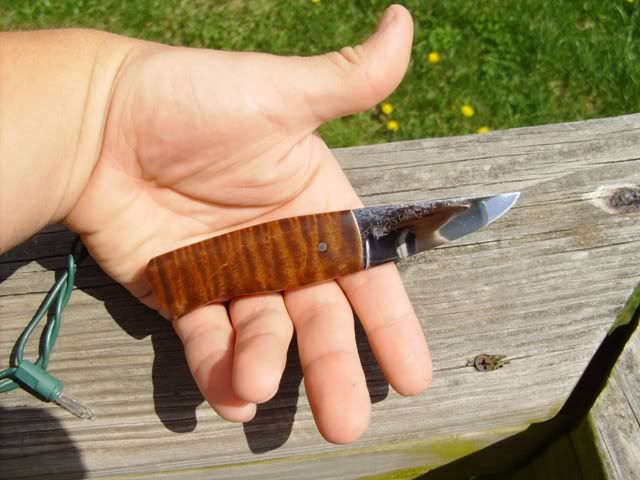

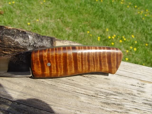

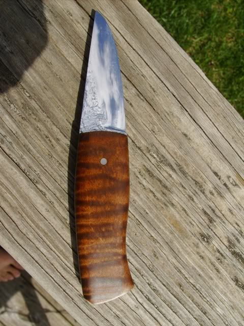

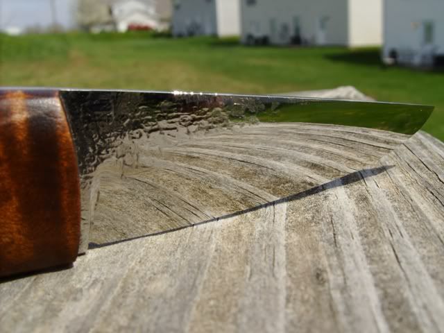

. I wanted a small knife to act as a detail knife when bushcrafting or woodcarving. This knife will replace my U2 for light duties. It is a great size. Three fingers fit easily, but you can grip it with all four if needed. I plan to make a leather sheath with a stainless steel pocket/belt clip so that it can be carried in my pocket in place of a small folder. It is a full tang knife with one nickel silver pin and two hidden pins. It has a full convex grind that is very shallow and becomes nearly flat as it reaches the edge. I prefer scandi edges for woodworking, but I have noticed that a convex with a nearly flat edge will work wood just as well. The name is Spring Break Knife in Swedish. As the name implies, I made this knife during Spring break last week in only two days which is a new record for me.
Blade length: 2.5"
Blade thickness: 1/8"
Blade material: O-1
Liners: black vulcanized fiber
Pins: 3, 2 hidden made of nickel silver
Wood: curly maple
Wood finish: contrast dyed curly maple finished with tongue oil and a layer of beeswax for gripiness
