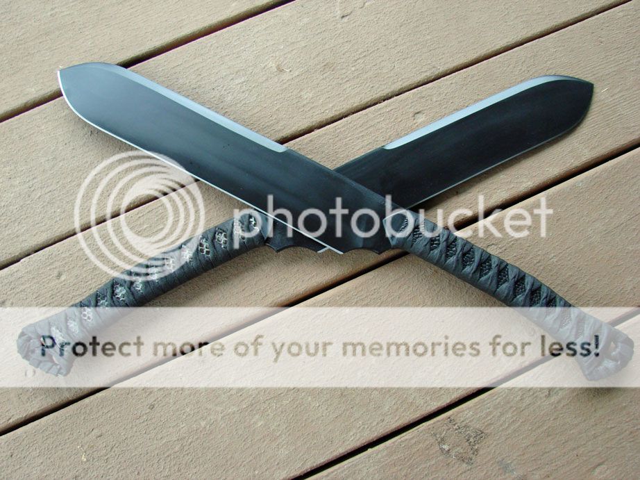

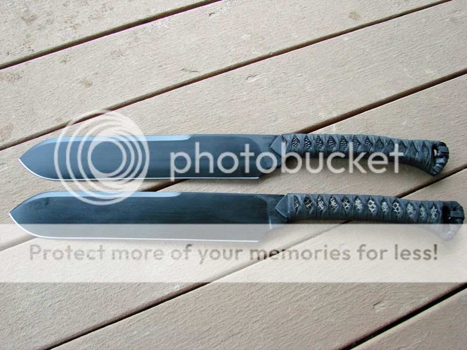

These are two V1 Choppers that are going to the OKCA show.
Steel- 5160 at 59 Rc with a torch draw back
Cerakoted by forever powdercoating in Olympia, WA
Wrap- ostrich skin and snakeskin underlay with Japanese cord. Minwax wood hardened.
Blade length- 13"
Overall- 24"
Thickness- .250
About 2# 6oz overall weight.
Dan
