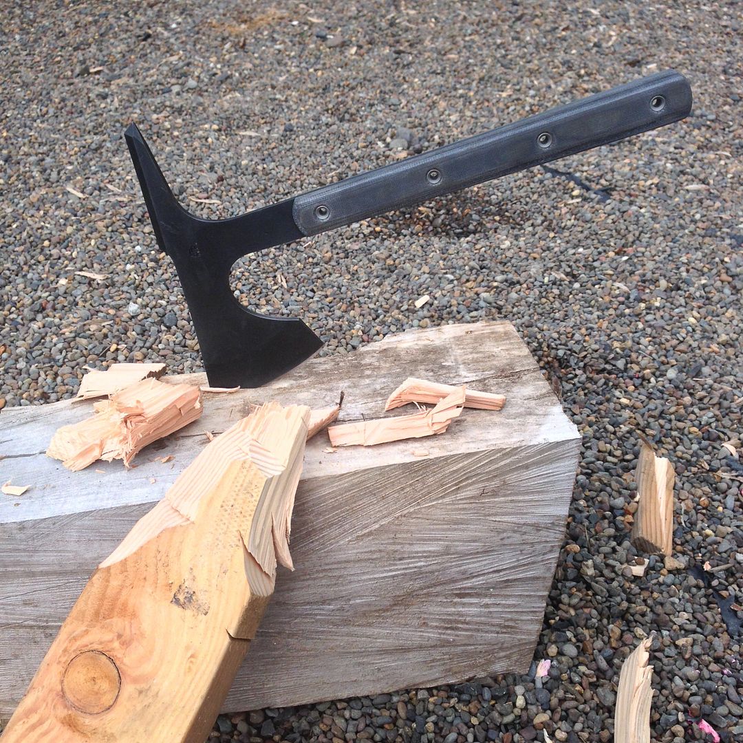

Hey guys, I just finished up these two small axes and I thought I would share. This is my Valkyrie tomahawk design minus the spike. For the prototype I wanted to something different, so I gave it osage scales and did some Norse inspired burning on it. I think it came out pretty cool.
The second one has natural canvas micarta scales. The steel is 1/4" 4140 that I deferentially tempered. These should make a really nice woods hawk.
Let me know what you think.
Drawn back tang.

It is styled after norse axes, always been a favorite style of mine. They knew what they were doing when designing and axe.
I do still like L6 steel, but these I did in 4140. It seems to make the most sense, it's extremely tough and takes a razor sharp edge. The hardness seems to be just perfect for axes and hawks. It is 55rc on the cutting edge and pole and then I draw back the tang into the body to appx. 47rc for even more toughness.
It is also more available in the sizes I need for these.

Playing around with handles.....
