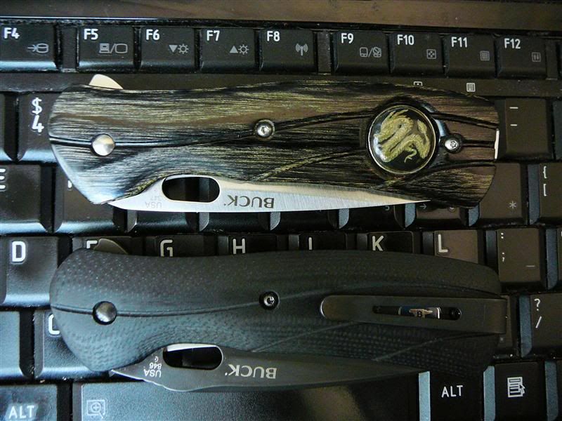

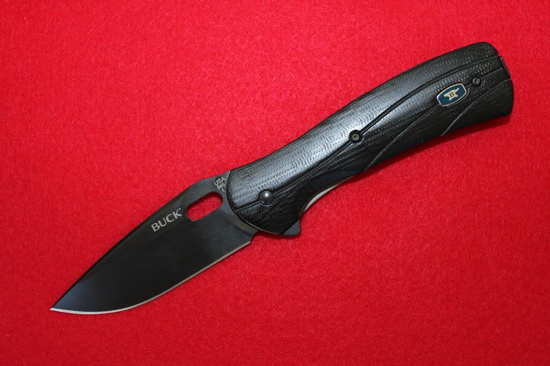

Here you go. For those that try this, be carefull of the little bar that goes through the blade and limits it's travel. It dropped out on me and I had a heck of a time finding it.
Vantage Force Avid with Vantage Pro G10 scales. Much more comfortable in my hands than the aluminum scales.
What hogger said. No surprises. The only potential surprise comes from a full disassembly of the knife- if the blade is in the closed position, the liner lock spring pressing against the blade will cause that liner to spring up a little when you unscrew the three inner screws. But you don't really need to tamper with that to swap scales.

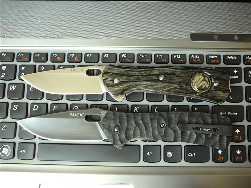

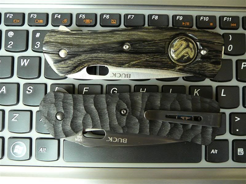

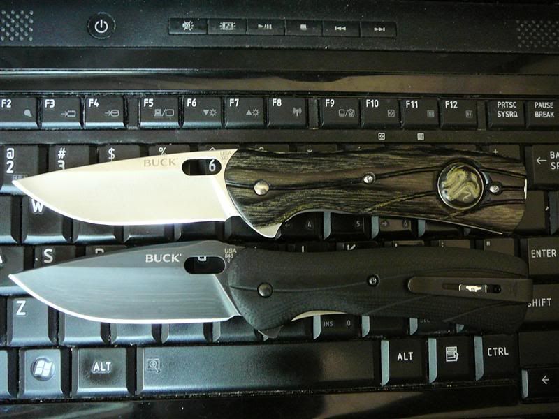

Here's some pictures of my new Vantage Force with my normal EDC Vantage. I plan on EDC-ing both of them simultaneously, carrying the regular Vantage in my right front pocket and the Vantage Force either in my right rear pocket or my left front pocket, hence the flipped pocket clip on the Vantage Force. I may try putting a zip-tie on the Force knife to turn it into a makeshift waved knife.
Edit: I took so long posting that Plumberdv got his picture in first! Nice work Plumberdv. It looks good. I personally prefer the feel of the aluminum scales; to me, they're just aggressive enough to really lock the knife in my hand. Any more aggressive and they'd tear up my hands, but they felt good as they were. My big problem though was since they were so aggressive they wouldn't go into or out of my pockets easily at all; even if I could resolve the snagging under the clip, I have no doubt the aluminum scale on the other side of the knife would have been akin to rough sandpaper on my pants causing serious premature wear. I see the aluminum scales being ideal for carry in a holster, but not pocket friendly at all. The G10 from the non-Force line though makes a wonderful substitute for pocket-friendliness.

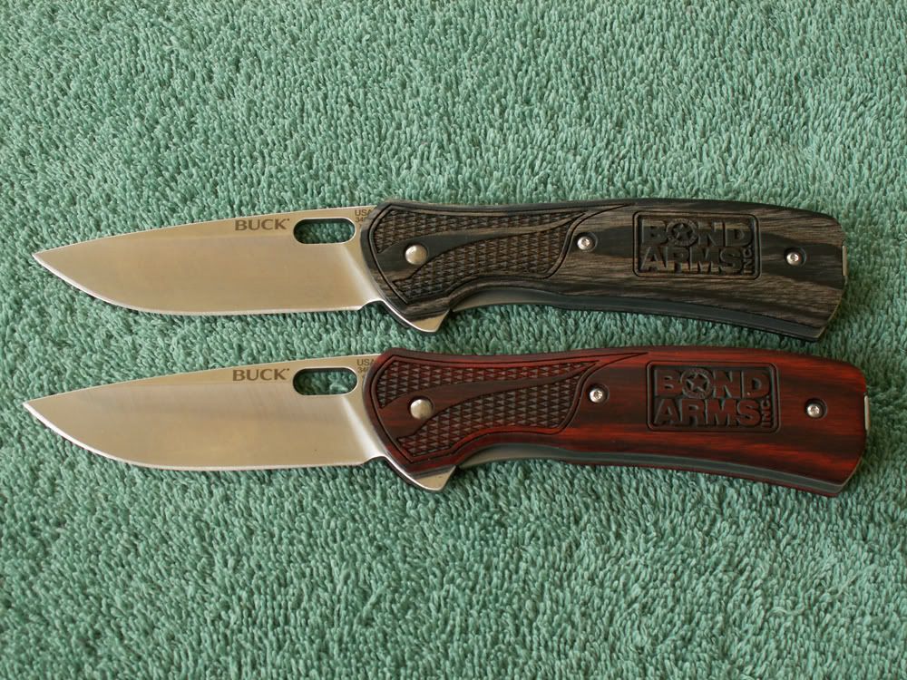

I like the change on mine so well, I may change the other one I have and use a set of the the rosewood scales from a Bond Arms Avid.
Ooh. Pics if you do, please! I love the scales on the Bond Arms Vantages. They look fantastic. (Can you tell I'm a bit of a Vantage fan? Just a weeeee bit?)
I think the Rosewood will look the best with the black blade, but the other one would look good too. I'll have to check, but if I have two of the Rosewood models, I'll do a swap.
Those are beautiful knives, plumberdv. What blades are on those, are they 420hc 345 Selects? Should be interesting to see wooden scales with a black blade; I don't think I've ever seen that particular combo before.
Wow that rosewood one looks really pretty from the clip side. And I suppose I should have guessed 13c26 since the Avids are the model with dymondwood scales.

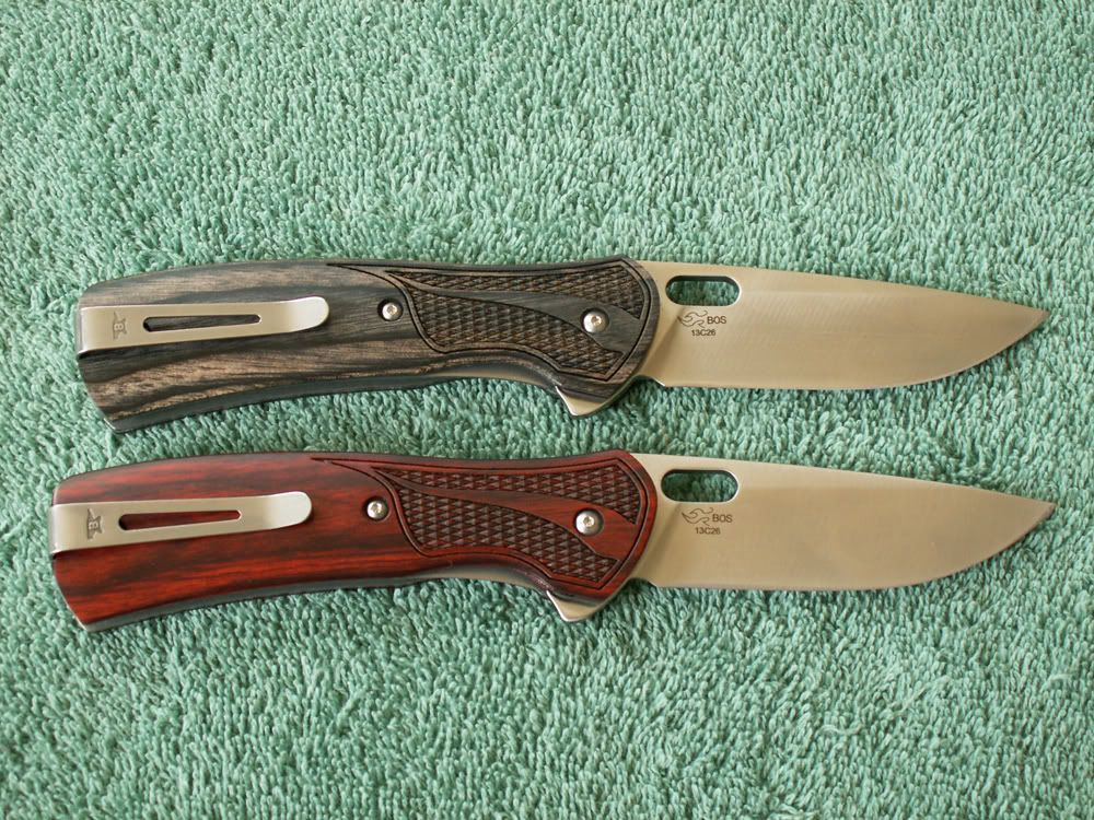

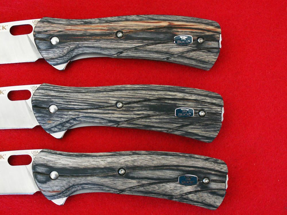

I might check that out too. Here's a few of the Selects I have with Dymondwood handles. Any of them would look good (and be better for my tender hands than the cheese grater like factory scales :)).

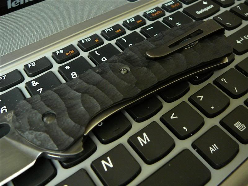

While I enjoy the sleek look of the smooth G10 scales from the Vantage Pro, it admittedly offers less traction than textured G10 or the standard Vantage Force Avid scales. While looking around, I saw some customized Spyderco knives that had grooves cut into the handles. I debated over whether I wanted to try customizing my G10 scales, and then last night I stumbled upon this thread- http://www.bladeforums.com/forums/showthread.php/733428-Customized-my-Vantage-Avid -where someone had already done exactly what I was thinking of doing, but with Dymondwood scales. It looked good, so I finally decided to pull the trigger this morning and give it a shot. Of course, words are useless without...pictures!
The effect isn't quite the same as Sawyer's horn imitation Dymondwood scales, but I'm happy with the way it turned out. It was actually kinda fun taking a Dremel to the scales and spontaneously deciding where to put the grooves (I'm used to coming up with a design or pattern beforehand and trying my best to follow it for projects like these). It feels very grippy now, but not sharp like the aluminum Vantage Force Avid scales. It also doesn't catch on my pockets as badly as the standard Force Avid scales do. I'm also pleased with the aesthetic effect, as the textured scales make the knife look much more rugged than it did when the G10 was smooth.
