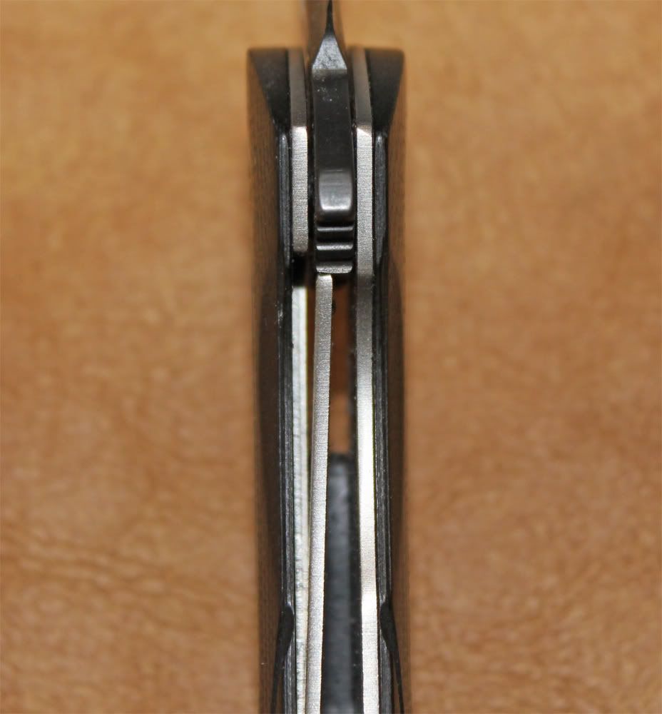

That Force have decent lockup AND flip open easily? Certainly looks very nice, I've give it that.
- OS
Flips open like a champ, slick as grease. The lockup is solid as you can see from the photo below.

Seriously, I have 6 Vantages, 4 are way past center, if not upon initial opening, as soon as you put any force on the blade.
Not to mention the three I've sent back, two to Buck, one to vendor.
Left to right: Select (early-excellent IMO), Select w/ Dymondwood, (centered - good ), Select w/ Paperstone, Avid, "hybrid" Avid, Pro (all four way over to other liner).
Note that only the "hybrid" has been carried and used for cutting (and was this way when I got it about 4 months ago) so none of this is due to wear.
Oh, I also have the small Select, which is just a tad past center, okay. Ironic the cheapest models have the best lockup.
