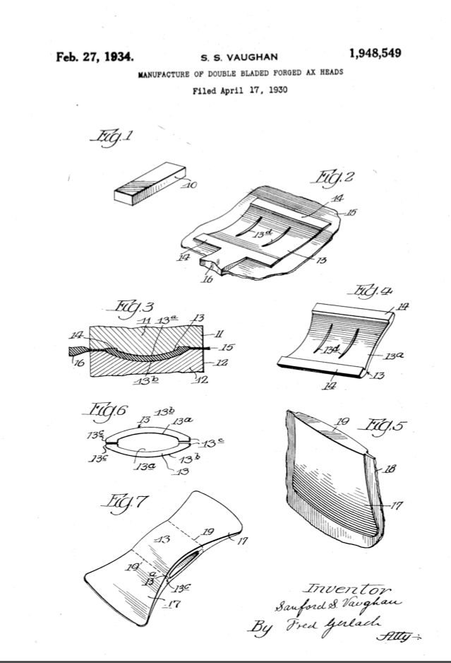

A four-piece double bit from Vaughn!

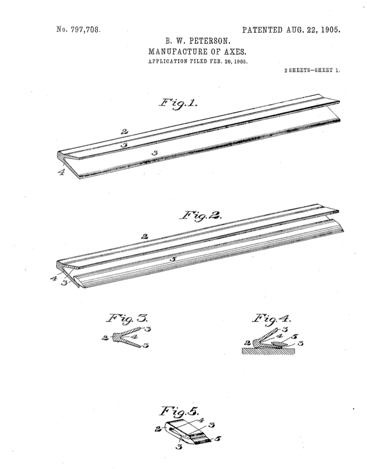

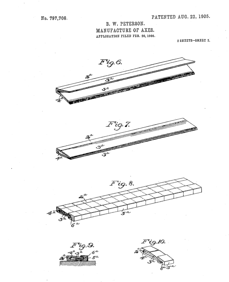

Mass producing blanks from rolled forms, creating over-coated blanks which were sheared off and then hammerwelded.
The same process as above but with center-bitted blanks.

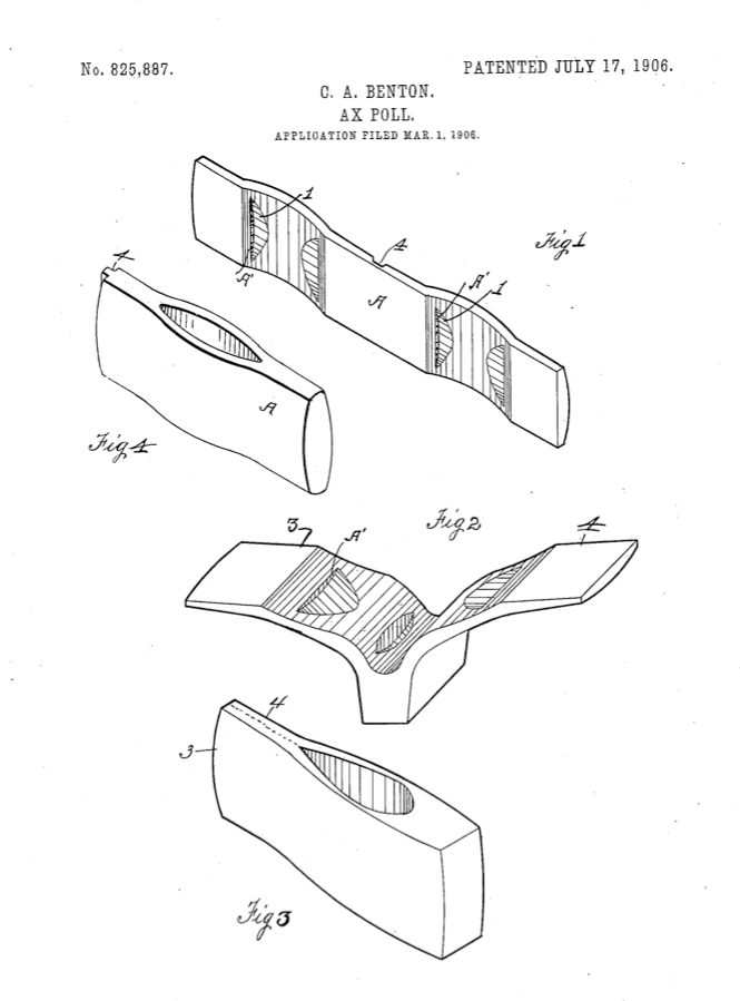

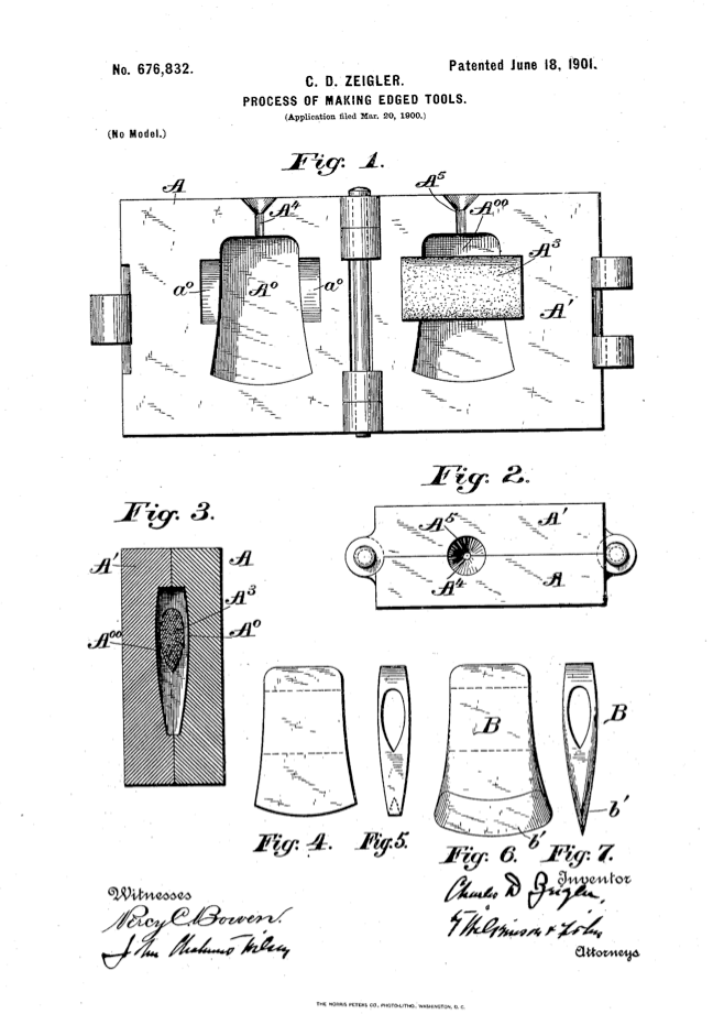

Casting an axe poll (which is the common term for the axe head minus the inserted bit). Notice the use of a mandrel to create the eye of the axe. It seems that punched/upset eyes are a much more recent development.
