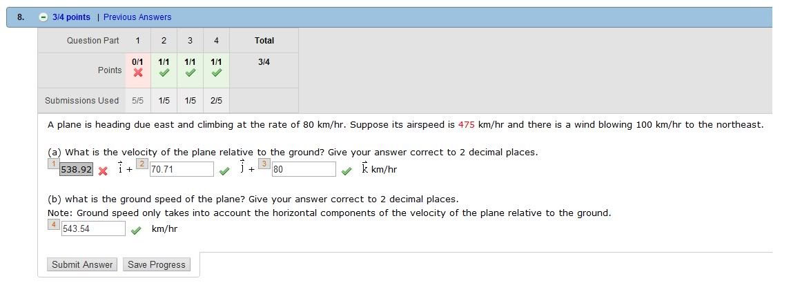

I'll end up asking the professor tomorrow, but this bugged me all day!
To get the i component of the vector (before wind), I took:
475[SUP]2[/SUP]=a[SUP]2[/SUP]+80[SUP]2[/SUP] ==> a=(475[SUP]2[/SUP]-80[SUP]2[/SUP])[SUP]0.5[/SUP] ==> a=5(8769)[SUP]0.5[/SUP] ==> a=~468.21
Doing the similar operation for the wind vector, the i component was:
50(2)[SUP]2[/SUP]=~70.71.
So I add the two components together and get ~538.92. I even used this value to get the ground speed, which was right. I double checked and double checked again to make sure it worked and made sense. Am I making an incredibly elementary error here? I don't care about points but this bothers me to no end!
