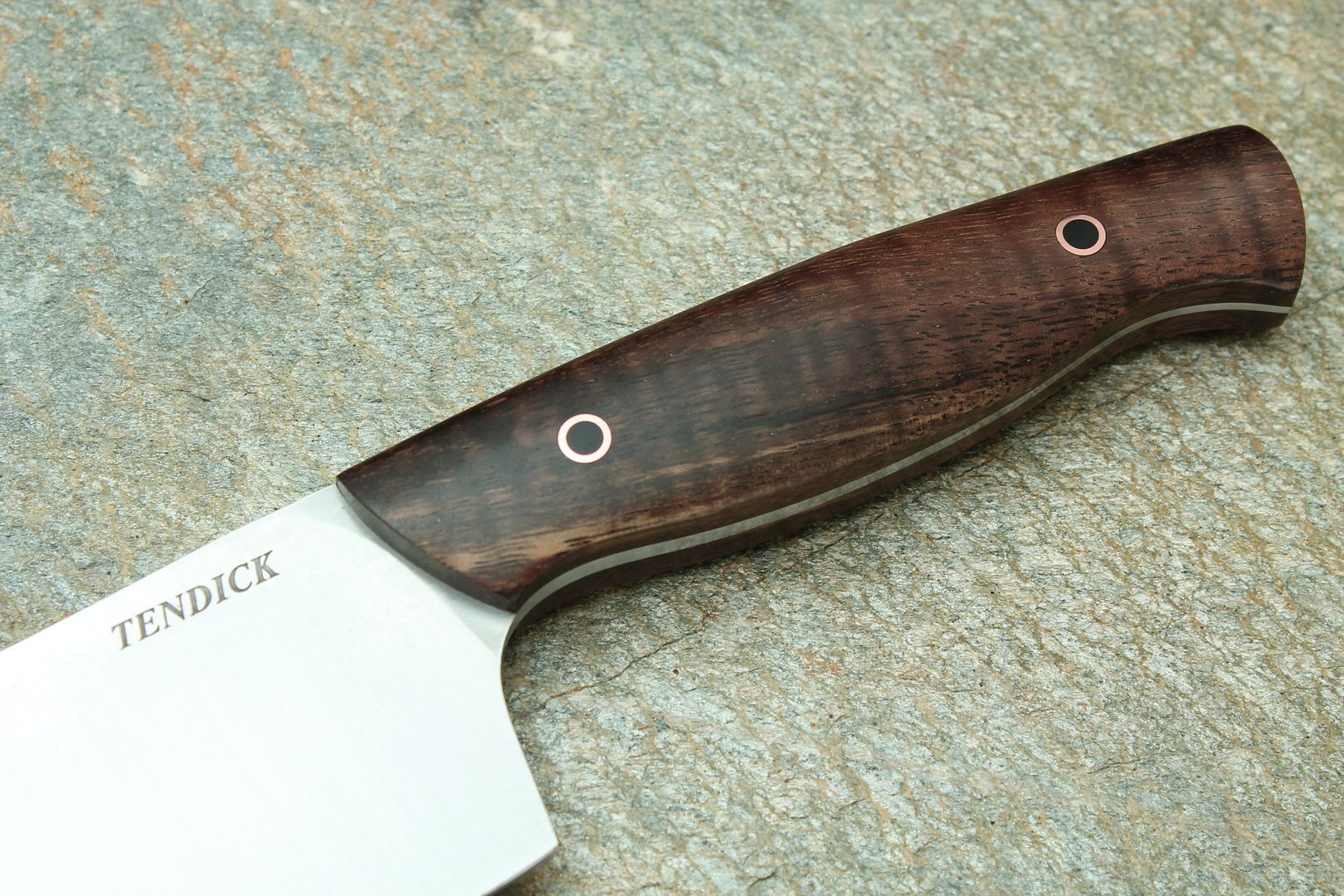

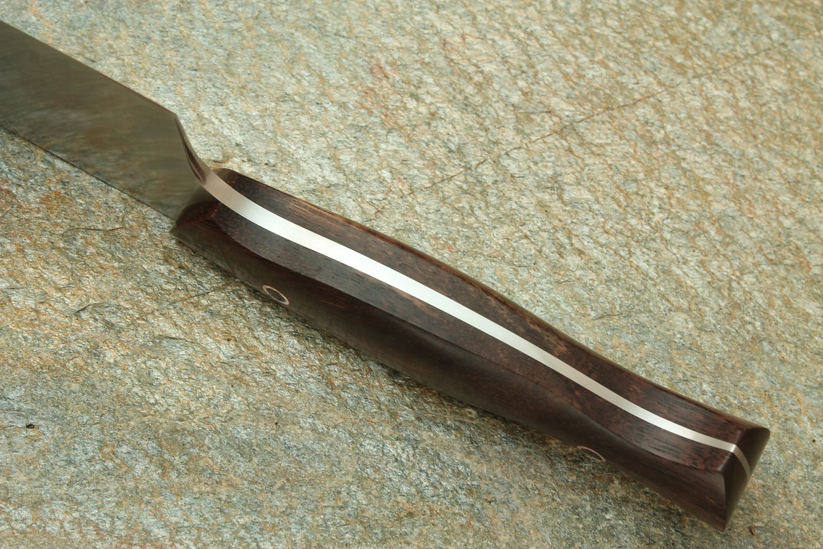

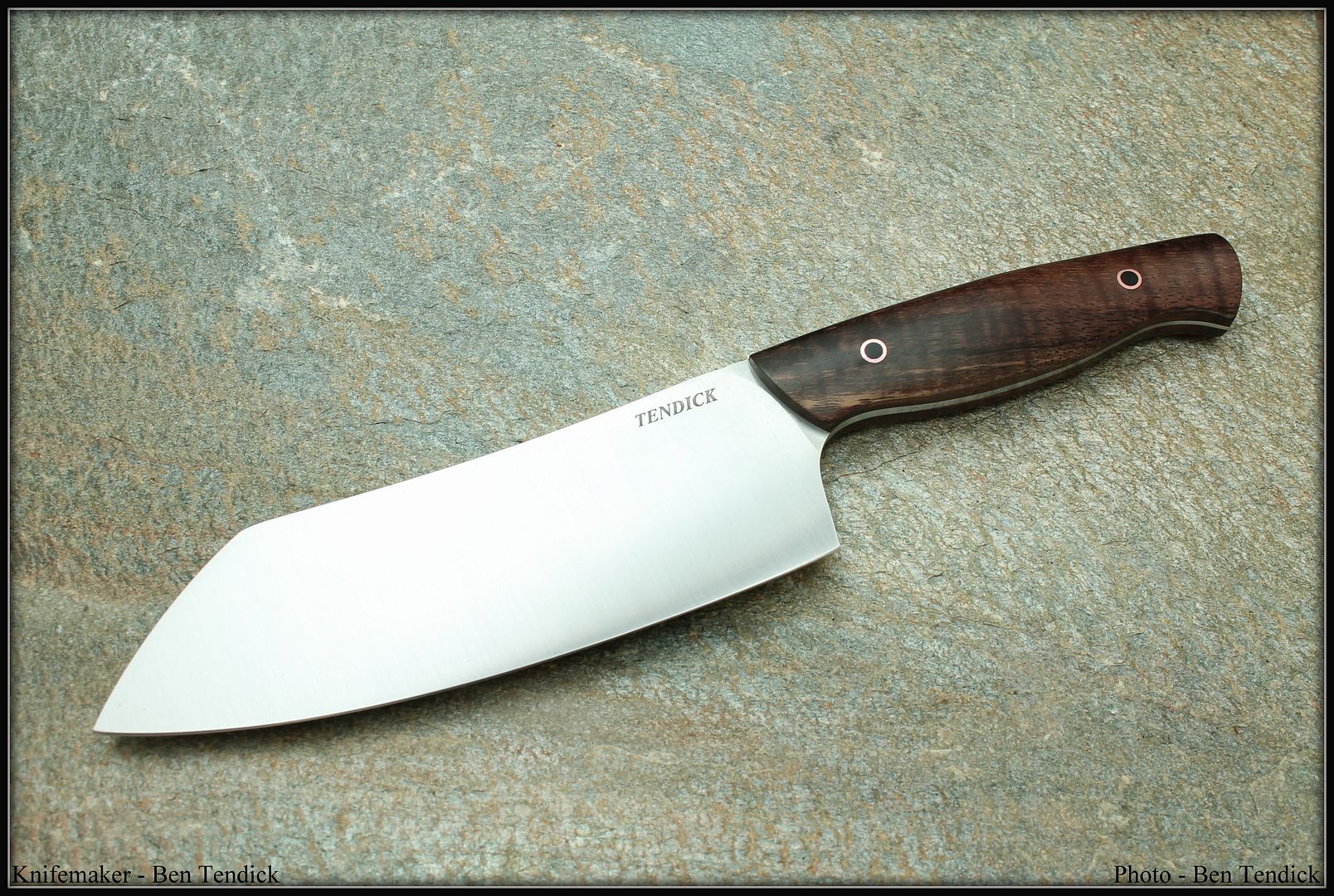

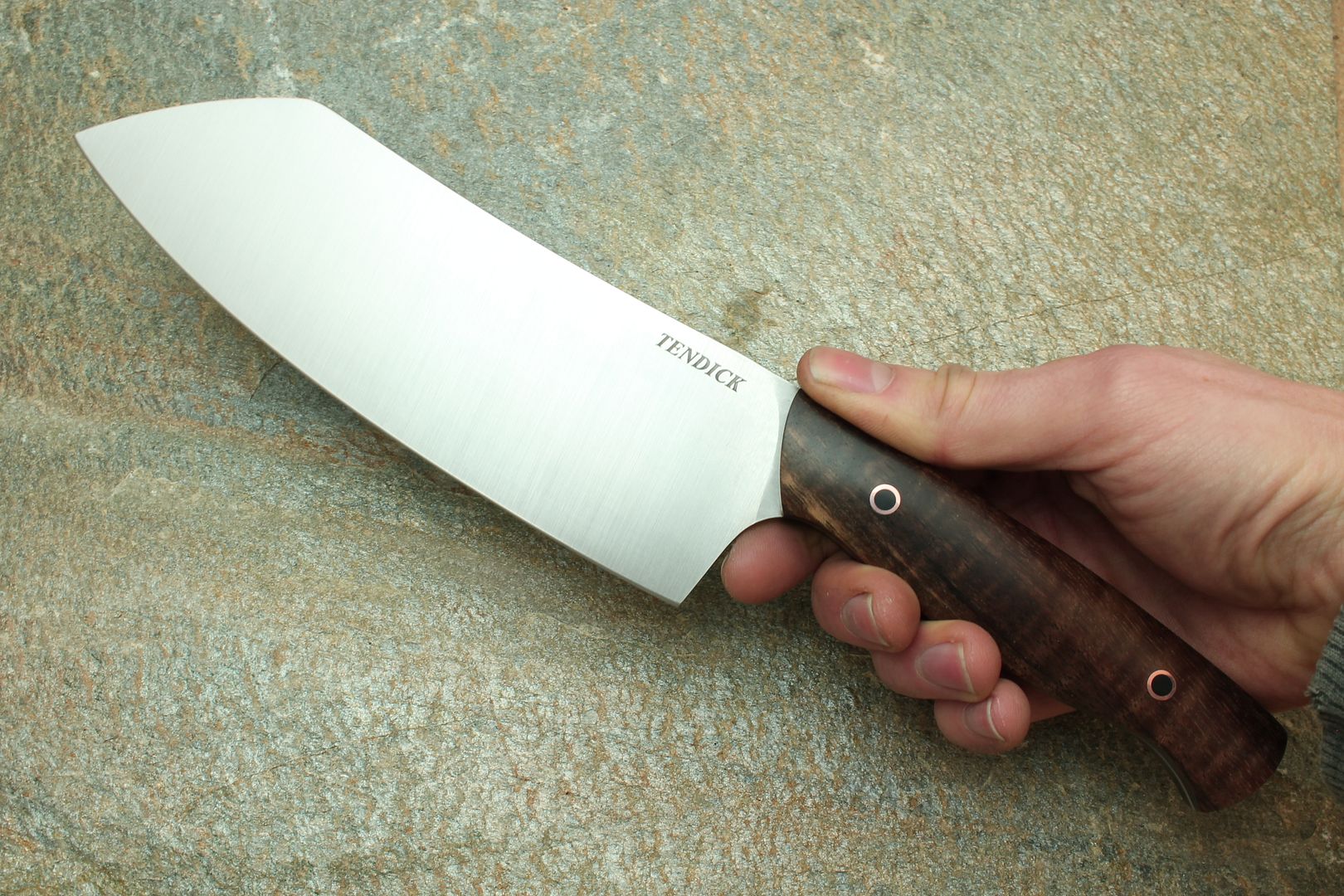

I just finished this big boy up last week, and I figured I would share it with you all! This is my new santoku design. The blade is 14c28n stainless. I am really liking this steel, it takes a VERY fine edge, holds it nicely and is very corrosion resistant. The handle is some very nice stabilized curly Koa. It has a tapered tang and my copper/carbon fiber pins. The choil is nicely rounded and polished for a comfortable grip.
OAL is 12", and the blade is just a hair over 7".
This should make one heck of a Veggie chopper!!
Very handsome design. Good lines. Very clean execution. I've been a fan of your work for some time now.
