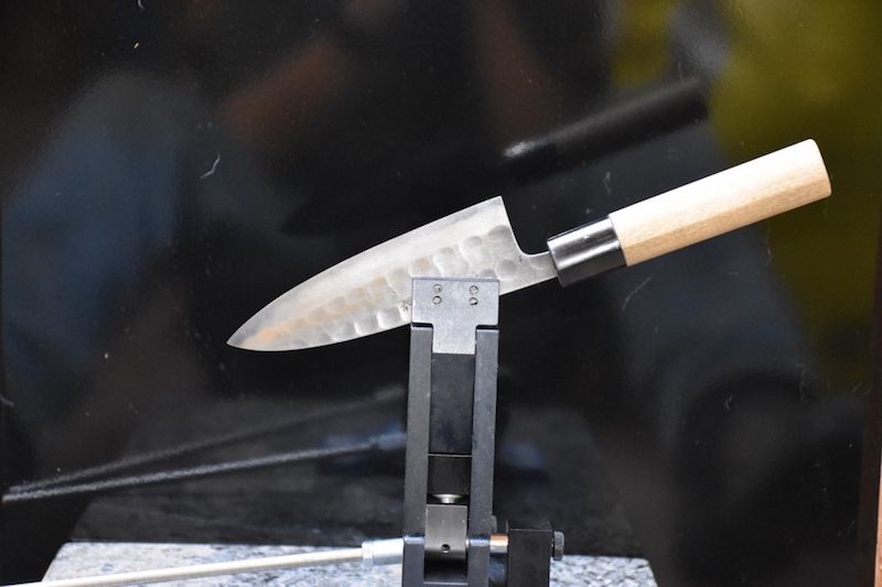

My Military has a spine width of 0.1375 inches where I put the rear part of the clamp. At the front part of the clamp, the spine width is 0.1055 inches.
The Military is a pretty good spine width for the cam clamp, at least at the back part of the clamp.
My Kumagoro 135 mm petite guyuto is 0.990 at the rear part of the spine -- too narrow for the cam clamp to work securely. But an inch and a half down, where the front part of the clamp engages, the spine width is 0.825. It's also a hammer finish, so the clamp can get caught with even less to clamp.
Because the jaws don't adjust to the profile of the blade (to the distal taper), they can't clamp these blades effectively.
Here's a photo of my Kumagoro. I tilted it up with just light pressure from my little finger. It has both a thin blade and a good distal taper, together those two characteristics make the Gen III jaws ineffective.
