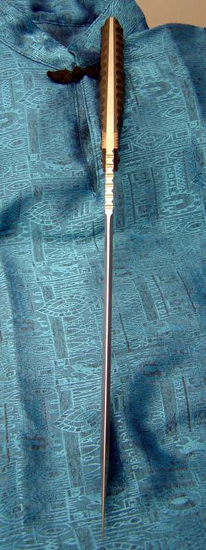

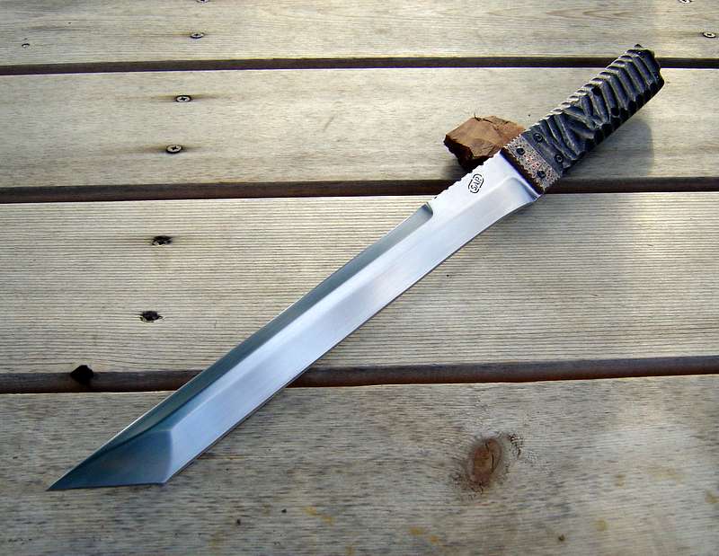

Little bit O Japanese influenceOne of a kind thats for sure
CPM 154 CM
.25x18 1/2" OAL 12" blade main bevel done with a 14" wheel which gives the appearence that it is ground flat. upper swedge 3" wheel unsharpened.
Tappered tang ( Thanks Bill H ) with F-22 CF, bolster are mokume from Phillip Jones (thanks bro )
This is my first shot at hand finish, not perfect but its a start, first time doing bolsters as well once again not perfect.
I had started a really nice wood sheath but it just was not working got a plan on how to do it next time. I think I will send it down to Dave Cole??
