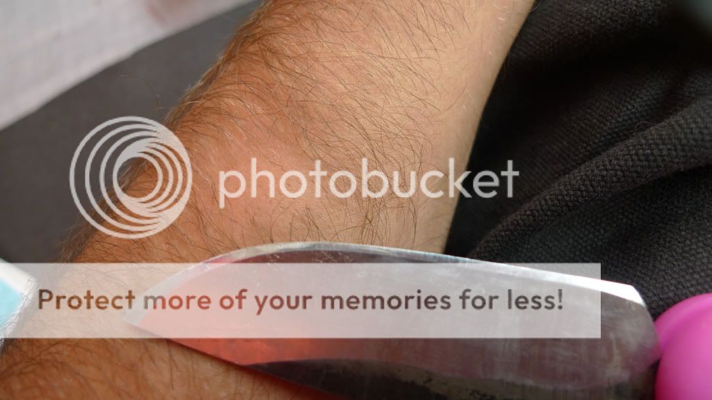

I got a pink Svord Peasant Knife a while ago just to see how it worked since it was only 13$. It's a pleasant surprise at that cost, if I had to choose the mora style grind or this at the same price, I'd choose this. It opens and closes easily with one hand, it's easy to change the lock tension (friction), and it takes very little to sharpen the main edge since it's so thin to begin with. The handle is simple but feels solid in the hand and has multiple grip positions. The grinds on each side are uneven, but for 13$ I don't expect it to have great attention to detail and it doesn't effect how it works. The edge angle was set to 18 degree's per side from the factory, and the edge thickness was reasonable:
.023" behind edge
.060" behind tip

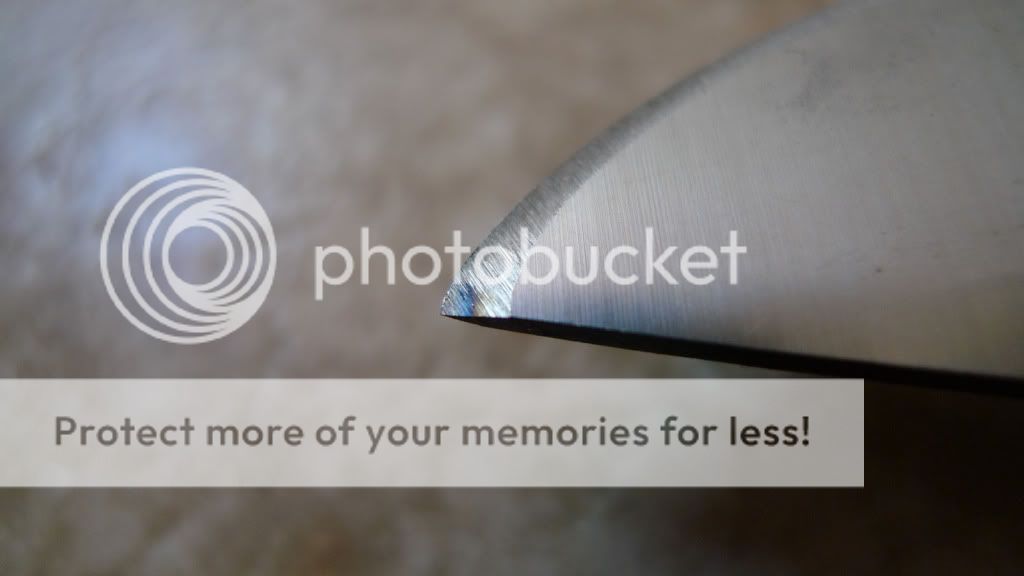

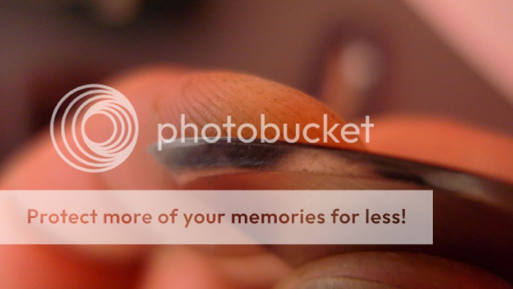

The only two concerns I had were the tip being slightly burned during the factory sharpening, and the placement of their stop pin. It was set a little to low allowing the edge to come in contact with the chicago screw. I noticed the edge was dented there and fixed it with a nylon washer. Heres the pics of the tip, and a short video of the fix:

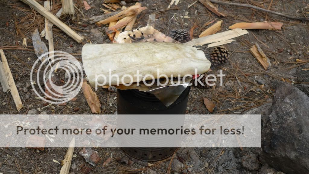

Here is me making a somewhat ill conceived plan for an aluminum hot plate. Next time I'll leave out the holes, since all it did was burn anything above it, which did give a great smoke flavor to the onions.
and the sloppy mess it made, full of smoke flavor :D :

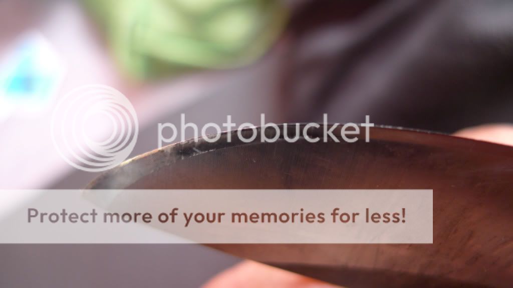

People have complained about the svords L6 being chippy, but everything I'm seeing is light mashing and rolling.

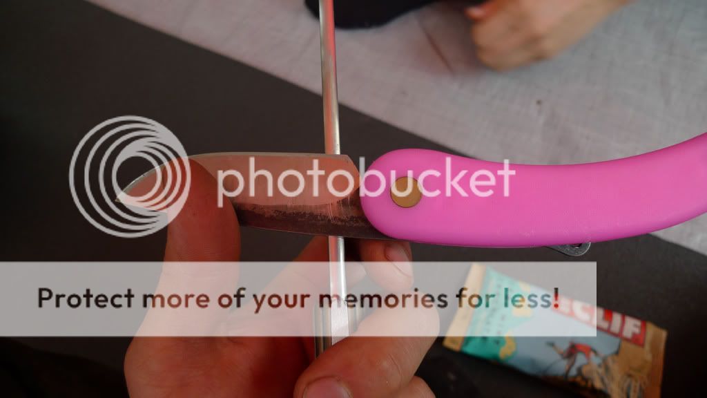

The damage was relatively minor, and I could still shave through it without it being too scratchy.
After steeling it on the back of another knife (a Busse choiless BOSS Jack Proto) and a few strokes on a 1000 grit stone, it was back up to near it's original edge. I didn't competely get out the damaged area, but I only spent about 2 minutes steeling it and hitting it on the stone. All in all it did good for what I expect out of a knife, certainly out of a 13$ knife.
