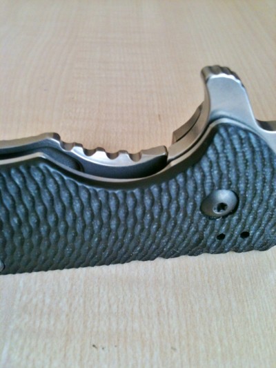

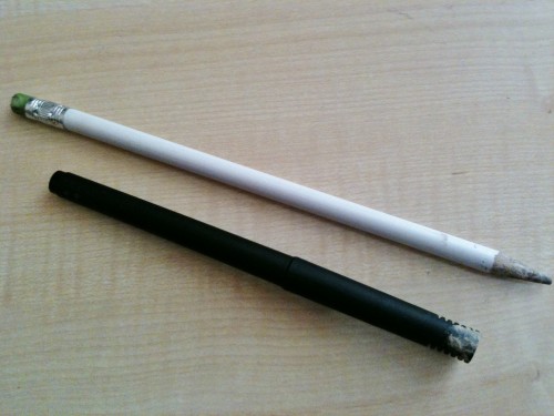

Hey guys, I got inspired by the 0560 review by Nicegy525 to sand down the over-hang on the handle scale of my 0560 to make closing the knife easier on the thumbs. I thought it was gonna be a quick job, but got a true appreciation for the toughness of G10. I just want to mention that, for anyone who has been bugged by the difficulty of unlocking the 0560, this slight mod makes all the difference in the world. I sanded everything down flush with the steel liner (with the exception of an area of the steel that has a slightly abrupt dip):

I can understand being not very handy, I'm right there with you. I am a total noob with these types of things, so the way I did it is probably not ideal. I wrapped 400 grit wet/dry sandpaper around the end of a pen (cap on) & just went back & forth, making sure to keep a good, even curve on the scale. I also wrapped the sand paper around the sharpened end of a pencil for certain spots. I then finished everything off with 1000 grit. Knife was not disassembled during any of this. Probably far better ways to do this, but you asked :)...
Here are the cutting-edge instruments I used:
Hm seems simple enough, I will give it a try once I feel brave enough! Thanks for telling me how you did it!
That's exactly how I did it, except I used 220 grit for faster results. Always better to go slow and easy, using the least abrasive material necessary. You can always remove more material, once it's gone you can't fix it

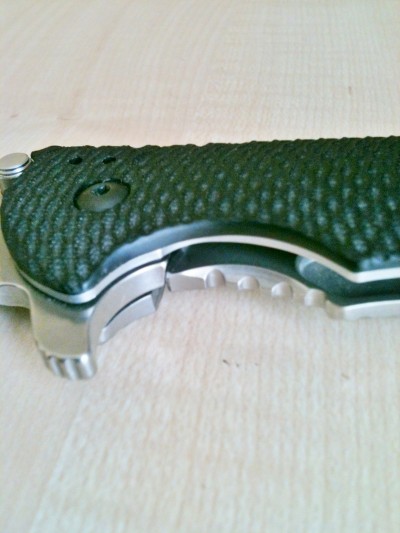

Here's the overhang I'm referring to:
Here's the sanded-down version, makes a huge difference in terms of ease of closing:
I bet they cut away the liner so it would be easier to get your thumb on the lock bar. No liner = more space to get your fat fingers wedged in there.
Wow! No wonder it took a while:D You need to be a bit more aggressive with G-10 to make a dent in it without spending all afternoon. The more you experiment the better you'll get. Also, for an inside radius that size, it would help to go to home depot and get a piece of wooden dowel from the lumber department that's bigger than a pencil or pen, 3/4" or 7/8". It will make things go smoother. You want something that is as close to the size of the curve you're working as you can get. I would be comfortable starting out with 100 grit paper to remove the bulk and then go down from there.

Jonnymac44 -- You're right that it took forever. I definitely will use coarser sandpaper next time I do something like that.
