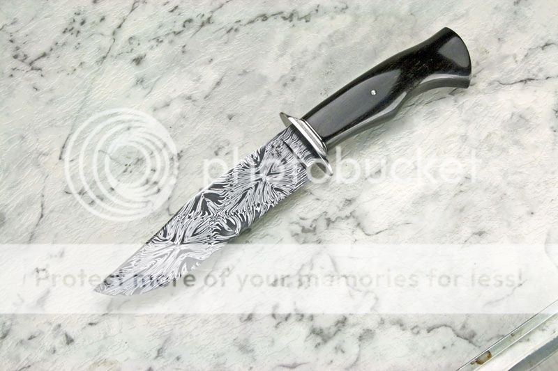

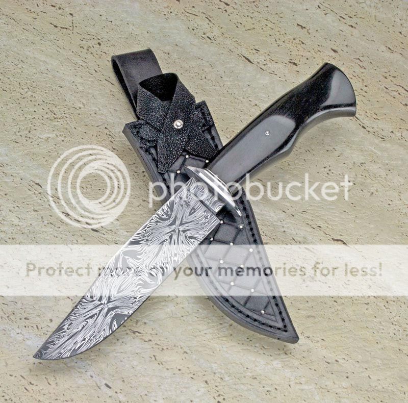

G'day all, haven't posted here for a while and I thought you might like to see a recent commission that I have just finished.
Mosaic damascus, bl 5 1/2" oal 11 7/8", textured stainless guard with G10 and stainless spacers, Ebony handle. Leather sheath with domed pins (boy o boy are they tricky little jiggers) ray skin keeper. I know my photography skills haven't improved much:), thanks for looking and comments welcome.

Knife looks awesome. The Damascus looks great, and your choice of ebony works perfectly with it.
Those evil little pins really make the sheath, though...

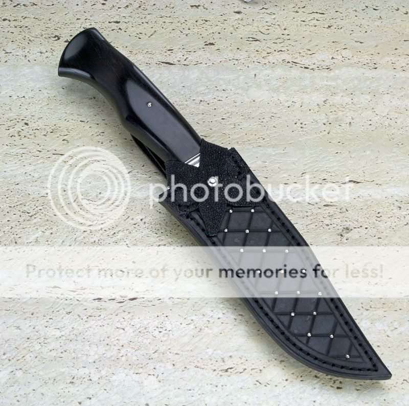

Keith,
Your knife is really great! The sheath is what really intrigues me. The little domed pins set it off. Would you mind explaining how you did them?

Thanks Steve, the domed pins have 4 prongs on the under side. I use a nail punch on the leather so the pin has a place to sit, using needle nose pliers I place the pin and set it, again with the nail punch. The tricky part is setting it up so they are straight, once it’s set you can’t get them out as the prongs spread out in the leather. Hope this helps. Cheers
