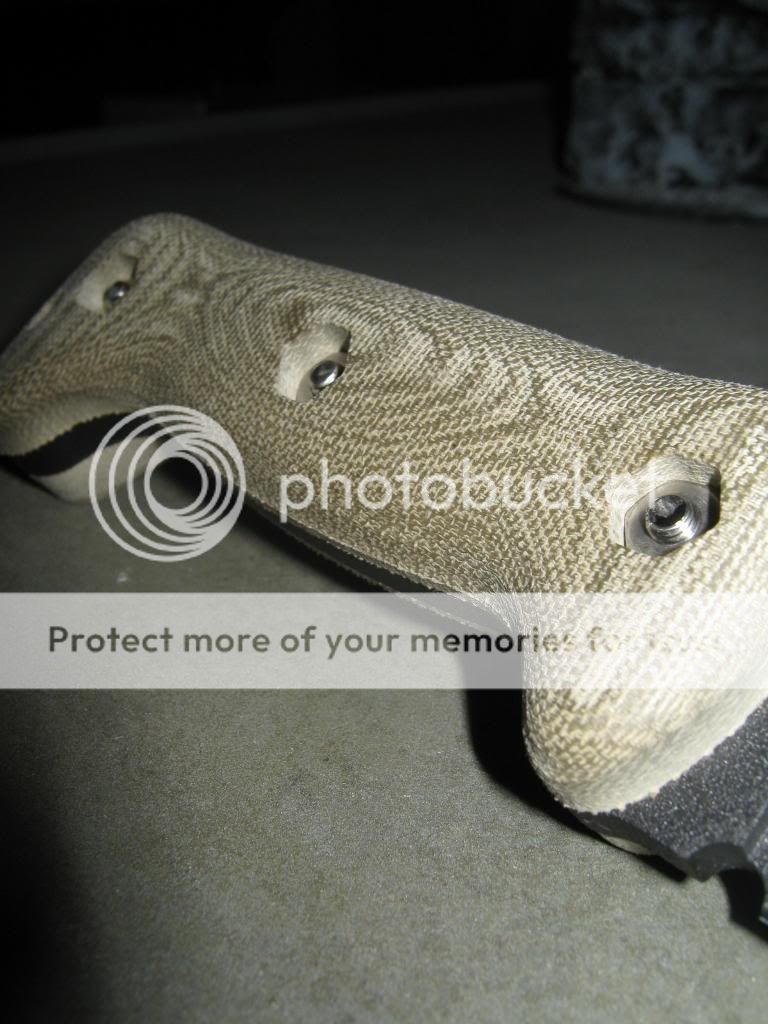

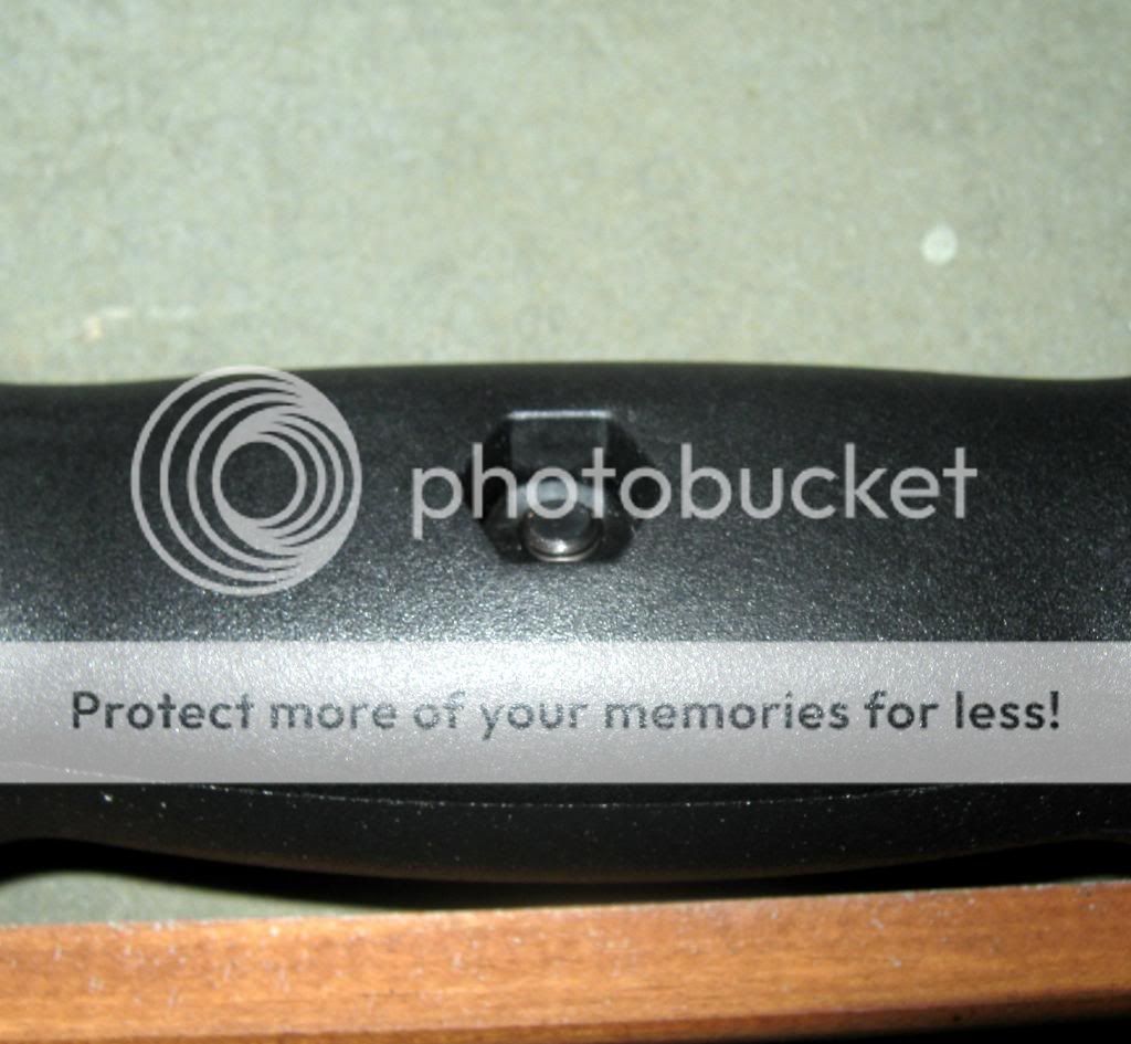

I just purchased the micarta handles from KA-BAR on 1/20/2014 and this problem does still exist. Here is a closeup of the grivory hadles with the factory bolt. Notice the bolt extending beyond the nut.
Here is a closeup of the bolt after I installed the micarta handles. Notice that the bolt does not extend beyond the nut nor is it flush.
Really disappointed that KA-BAR has still as of January 2014 not addressed this problem. Well, I am off to the hardware store to get some stainless!

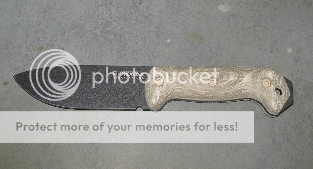

Just added the stainless steel bolts. The aesthetics of the stainless really bothers me. Will have to remove, mask and paint them to get this blade back to being more tactical.

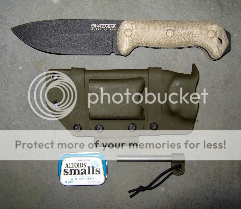

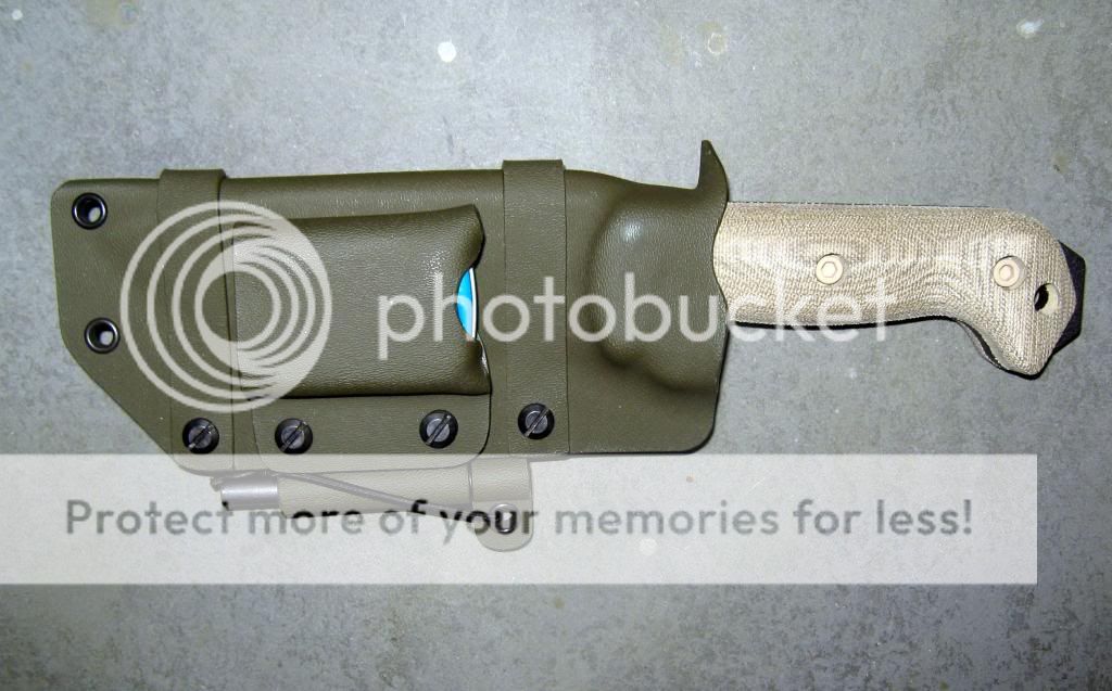

Here is my Grizzly Outdoors horizontal sheath with 5/16″ diameter ferrocerium firesteel mounted on the bottom of the sheath. I also requested Grizzly to add a small survival tin to the sheath and they had no problem doing so (customer service was exceptional). Went with olive drab standard color.

Derek H - Factory supplied screws are just fine with grivory scales. Same screws do not accomodate KA-BAR micarta handles. Problem fixed by purchasing longer stainless steel hardware at my local building supply store.
Micarta is a vastly different material in comparison with the grivory used in the stock scales. As such, it may require a much thicker area under the bolt to provide the same strength since it is a layered material vs a solid poured material. Because of this if it requires longer bolts, those longer bolts may be uncomfortably long in the stock scales (protruding so far above the nuts that it would be uncomfortable to grip). Not sure if this is the reasoning, but it may be applicable.
