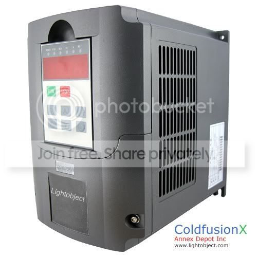

So I got my Grinder in a Box kit today and I started looking into my next major purchase for the grinder, the VFD to run my 3 phase 1.5hp motor. I am looking at 115v input VFDs. I am leaning towards the KBAC-27D, but I stumbled across this one by Haunyang Electric
specs are:
* Type: Single 3 phases
* Input: 100V~125V, 50Hz/60Hz
* Power: 1.5KW 14A, 2HP
* Frequency: 0.1~ 400.00HZ
* Accuracy: 0.1%
* Resolution: 0.01Hz
* Communication: RS485
* Display: 5 digit Digital Display for "V,A,Hz,Temp,Forward/Reversed,Fault"
I know a number of home machinist have bought them along with the companies air and water cooled spindles. I would say its not the quality of the KB unit, but the price is about half. I know my grinder is not the place to save money, but it is tempting:o.
My question is, is it save to run a 1.5hp motor on a VFD rated for 2 or more HP?

It is safe to run a motor of less HP then the drive. The drive is rated for it's max. HP.

Yes, rating is what it will handle, 1.5 in a 2 is safe.
Have you got a manual? Those ventilation slots look like it is unsealed and needs you to build a clean enclosure with cooling or heatsinks.

Current is pull down, not push through.
The motor will draw what it needs, the larger vfd cannnot push too much to it.
I'd be concerned with the vents in the housing as well. I would definitly check if it is a sealed unit or not.

No I don't have a manual but it is available online. It is a made in China piece so the manual is a little tough to understand. A lot of the direct translation errors to make it fun. If I went the cheap way I would need to put it in a clean box. I still need to get all the numbers together and see what the real cost is compared to the KBAC-27D..

The difference in price is the enclosure the KBAC-27D is NEMA 4 which means washdown and dust resistant. The drive you are showing looks to be IP20, if you mount it close to your grinder the metal dust may short it out. I just ordered the sixth one on this page http://www.wolfautomation.com/ProductList.aspx?CategoryID=823&ManufacturerID=361 for my 3HP KMG clone.

Yes it is a IP20 enclosure but is the enclosure really worth $150+.

You can buy a remote and mount the drive away from the grinder. I looked at a bunch of drives. To me it was worth the extra, my shop is not climate controlled as I understand the IP20 it is just made for impact. If funds are tight go with what you can get, mount it in a cabinet with vents and start grinding.

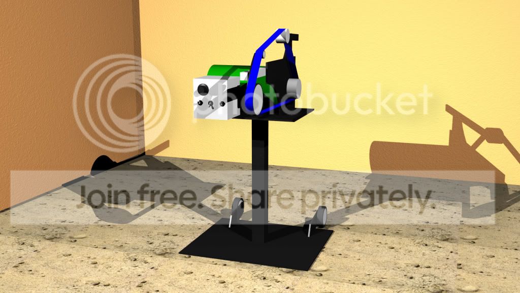

I will be pretty much stuck mounting the drive to the grinder itself, sort of like this quick drawing because I don't have a permanent shop space to leave it set up on a bench. My shop is more less just my backyard.
My whole plan is to be able to lean it back and move it in and out of my storage shed/small garage, so unless I can get a dust proof case for the cheaper ones for a total price considerably less then a KBAC-27D it looks like I may be stuck spending the few extra dollars
I was able to find the KBAC-27D for around $340for a 2hp. I tell you if you are going to mount the drive like in the drawing you will need an enclosure, which will have to be larger with some type of air vents. If it was $100 or less I would go with a NEMA 4 drive.

The NEMA drive can handle more heat as it has to perform in a closed (sealed) case. If you put a sealed case around the lesser unit, it can very well over heat.
So Yes, the NEMA 4 units "ARE" worth the extra cost.
