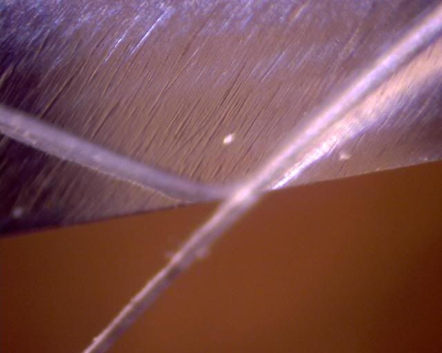

Can you take close up pictures of the edge?

Since I got a bit desperate and tried different methods :rolleyes: I thought maybe I should start all over with my standard sharpening method before I take the pictures (since that's my preferred method and the one I want to improve ;) ) So I started from the 400 grit stone up to the 5000 grit and finished with my leather strop.
Did a couple with my standard camera and a couple with a microscope at work ;) With the microscope I took some pictures at the base of the blade and at the tip. Pictures if both knives are in albums below;
Spyderco Delica 4:

*for the WM1 I noticed already that I didn't keep my angle steady towards the tip (picture WM09 and WM10 are made from the tip of the knife) :o
Those edges look mirror like to the naked eye view and then under magnification - like they'd have a lot of bite too. Just my $.02 :)
The bright line running down the apex of the edge is what we like to call a burr, look to the link in my sig for detailed info.
Using feather light pressure when finishing your edge will help to reduce or even remove the burr completely. Stropping with a higher/coarser grit compound will also remove it.
This picture of your fallkniven tells the other side of the story, See the deep "pit's" in the edge? and random but overly large scratches?
The pitting or roughness to the edge is because it is not brought together, you got close but missed it by less than a hair. You are also jumping to the next grit too fast and basically sharpening the sides while you miss the apex. You can also see the burr in later photos and you will notice its much larger than your delica and more folded to one side.
The delica actually looks pretty good and if you strop or maybe work your finishing stone with lighter pressure it may be just enough to remove the burr and it will then become sharp. The fallkniven will need to go back to at least 1k and be worked through the stones again.

I can not tell in the first picture that knifenut reposted for you if that is a burr, or if you simply have not reached the edge yet. In your sharpening efforts, do you raise a burr on the coarsest grit you are sharpening with and try to remove it before moving to the next step? Do you ever color the edge before you start your sharpening effort to give yourself that visual cue that you are getting all the way to the edge? Also, what polishing compound are you using on your strop? Just curious.
