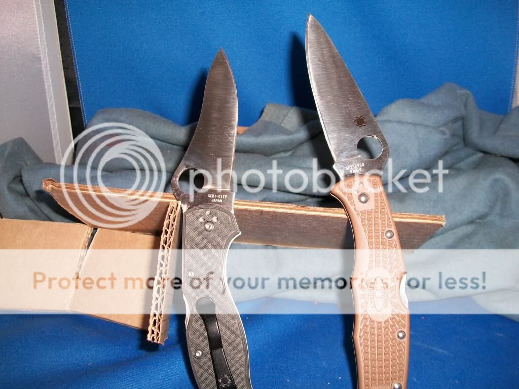

endura & stretch both cut 32 times 15 in. cardboard. code on cardboard was edge crush test 48 lbs. per in.[whatever that means] heavy board was lawnmower container.both slightly shaved leg hair with the stretch shaving slightly easier.this was difficult to push the knives thru & i was surprised the vg10 was so close to the zdp189. 480 in. of board each.

Thanks for the test. Since those two knives have the same grind and edge profile any cutting difference should be attributable to the steel. I'm pleased that the VG10 preformed well. The more I learn about VG10 the more I like it. This test also reaffirmed my previous decision not to get ZDP-189.
I'll grant that edge retention might be better in ZDP-189 in some circumstances, but for me that doesn't outweigh the problems with ease of sharpening, chipping, and corrosion.
Between these two I'll take VG10 any day.

Are you kidding? those two edge profiles are night and day different....am i the only one that see's this????

ditto to knifenut1013--pushing those knives thru the cardboard broke a sweat on me /i sure hope i do'nt ever need to cut drywall.mr. wheelspeed please elaborate as to how totally different 2 flatground bevels can be as long as blade stock is equal.
What kind of distal taper does the FFG E4 have? What are the measurements behind the edge? Was shaving your hair the only metric of edge retention you used? How were they sharpened and to what polish level?
I don't want to be rude, but this is not a very good test of any sort of edge retention. A measured or weighted cutting test done over specific intervals would have been a better test. That slight difference in shaving ability could translate into a large percentage difference in actual cutting performance if based on a more scientific and quantitative testing style.
