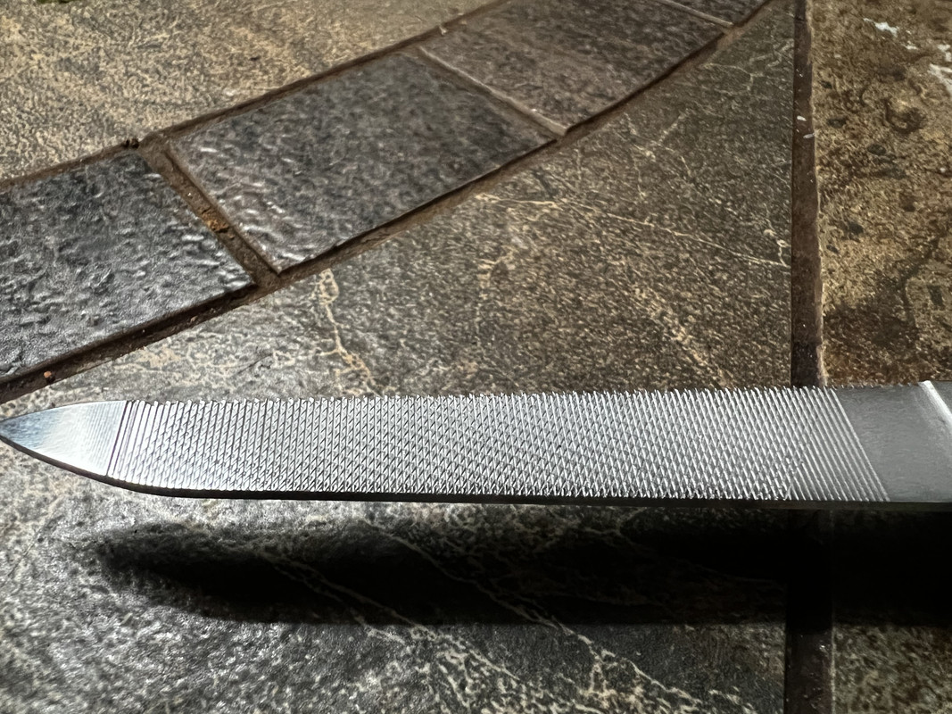

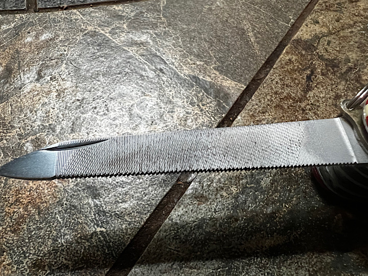

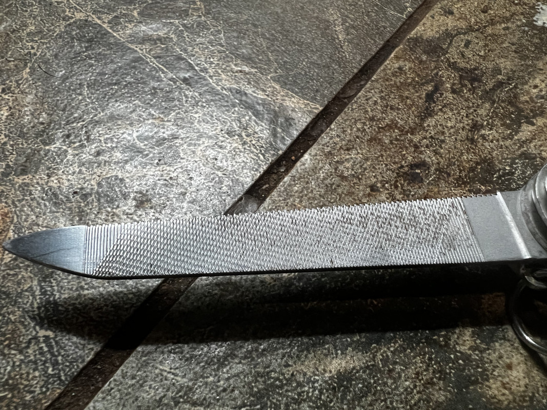

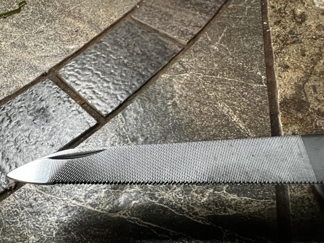

The only tools that would need replacement are the files on both an old Handyman and Craftsman. They’re both just worn down enough that they don’t do the job anymore.
All the blades are still intact, but a few have some very minor chipping…pretty sure that they can be sharpened and cleaned with no issues.
The old files are distinctly different than the version of the file which is currently being manufactured.
The old files were thinner, were flexible, were duller in appearance, and had a more fine set of textures on both sides. They were also made from different metals and were hardened to have extra capability for being used on tougher metals. If you were to put one of the older files next to a current production file, they would look and perform very differently. The newer files are thicker and more aggressive but are also made from a softer material and are consequently less capable of being used on harder metals.
They both have their pros and cons but the point is you would clearly see the difference if one of the old files was replaced by a new one.
Well, like I said... the old file textures are less aggressive, so they might not actually be worn out, but I would have to handle them myself to be able to tell.

Ah - maybe I’m just comparing the textures of the old files (these are from the late 70’s-mid 80’s) with my more modern models. I need to reevaluate for sure, and maybe just send everything in for a sharpening and cleaning.
Thank you.
Here’s the file on the Handyman:
And here’s the Craftsman:

Well it's hard to tell from just pictures but the Handyman looks pretty normal aside from a little corrosion and some minor wear. The tip on the Craftsman file might be a bit worn and both files could definitely use some cleaning. Wear on the tips on the older files is sometimes caused by overusing it as a small Phillips screwdriver. The tips on the new files are more resistant to wear from that kind of usage. The rust on the Craftsman file could be bad but you probably won't know until it's been removed so you can see what's underneath.
