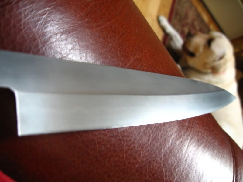

thats a light etch, thats been rubbed with flitz, just to remove the oxidation the would rub off. The steel is 52100
