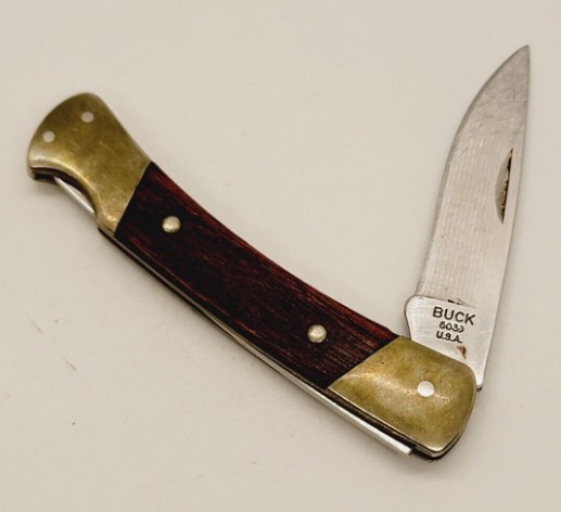

Hey all , I recently acquired a vintage script Buck 501, it is in like new condition. I was just playing around with her tonight after noticing the weak spring tension on the blade while it was closed , keep in mind the pivot was flush with the bolsters at this time … and I just squeezed the bolsters between the my right thumb and pointer fingers . Well it exposed the pivot on both sides of the bolster, is this common with this model of Buck Knife ? I would understand if I had put it in a vise or hit it with a mallet , but I simply squeezed ?F007E2AE-223A-4BB4-B0B2-A1D9C4D0A7E0.jpegCF42FDEA-5B8D-483D-A514-E92AECDB6875.jpeg
This is going to be an edc use for everything and anything knife borderline abusive …. So I can live with seeing the pivot pin, I guess my question is , is the pin going to move its way out of the knife eventually or is it fine the way it is ?
I think it would be OK. If it's going to be your edc just keep and eye on it. I would be suprised it it were to moved.
Just didn’t know if I should do some light peening around the edges of the pivot and a light polish or just leave it be
The pins are installed slightly over length and are retained by being slightly swelled on each side when they are set then the bolster/pin is ground & polished flush in finishing. it won't work its way out because of the slight swell on each side IMO. If your blade has slight side to side movement you could tighten it with a careful light tapy-tap each side with a drift on an anvil like surface. Cover with clear tape so you can see the pin but avoid scratching. I would use a drift the same size as the pin. Peen the entire pin to swell it, not around the edges. If the blade does not have any concerning side to play I would leave it be.
No sir, no movement at all, I was just playing with it really… and pushed the bolsters together , if buck already peened them then I’m not gonna worry about it! Thank you !

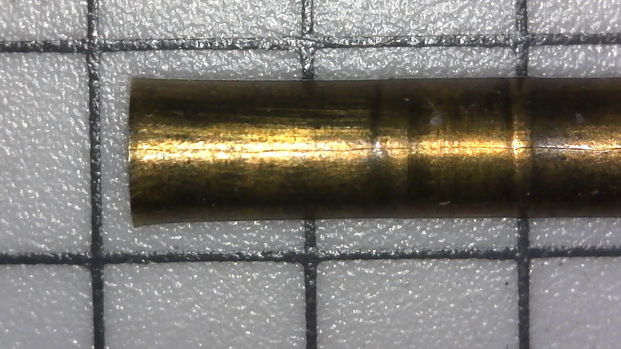

Here's a pivot pin that was removed from a 110 showing the mushrooming that happened during the peening process.
There almost zero chance your pivot will work its way out.

Somebody probably did a lot of prying with that knife causing the bolsters to spread on the pivot pin. The only way it would fall out is if it never got peened at all.
Thanks for the reply guys !! All very informative !! I’m just going to use it as is and keep an eye on things ! No biggie if I have to drift the pin at some point in time this is going to be a user !
