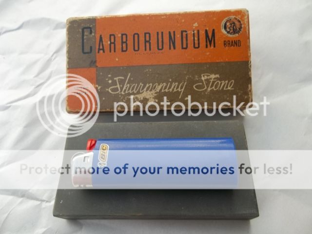

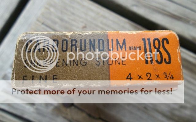

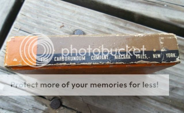

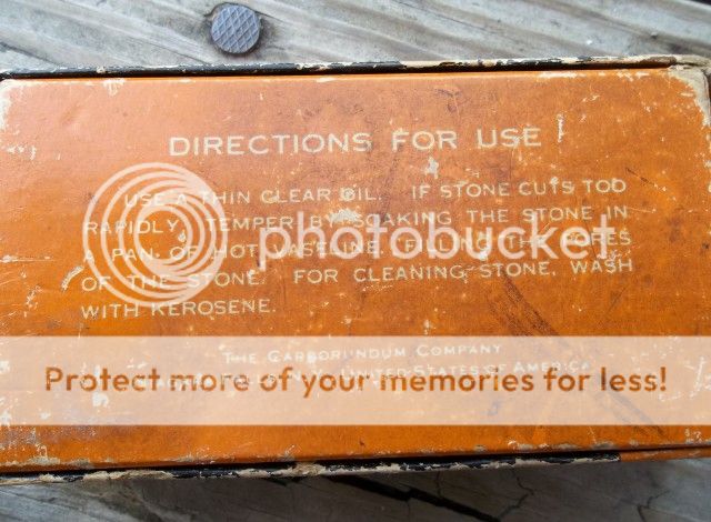

Saw this today at a antique shoppe. 3$ and it came home with me.
Seems pretty much unused, stone is in excellent condition although box is wore. Neat as a display if nothing else.
Never heard of this type/brand 'stone...anyone know anything about it? Collectible? Would it be a decent user 'stone?
That's a pretty cool find. :thumbup:
'Carborundum' is the original trademarked name for what we know most often as silicon carbide, as named by the inventor of it. Here's a description of the history of the product & name:
(from site: http://www.carborundumabrasives.com/aboutCarborundum.aspx )
"It all began with a failed experiment.
It was in 1890. In a small Pennsylvania town, the inventor Edward Goodrich Acheson carried out a series of experiments. He tried to heat carbon so intensely that it would result in diamond.
It didn't work.
So Acheson began mixing clay with carbon and electrically fusing it. The result was a product with shiny specks that were hard enough to scratch glass.
This was silicon carbide. Also known as carborundum.
The next year Acheson formed his company in Monongehela, PA and named it Carborundum, and moved the organization to Niagara Falls, NY in 1895.
Being silicon carbide, I'd think it should be an excellent user. I've no idea how 'collectible' or rare it is, but pretty cool nevertheless.

The instructions on the box, for soaking in 'hot Vaseline', are pretty darn unique. Having said that, you might give some thought to avoiding soaking it in any oils or greases (assuming it's not already oiled/greased). Many here have found it somewhat challenging to remove oils from stones, once it's in there. The stone would likely be as effective using water, or dish soap & water, as the suspension medium. Much easier to clean up. I don't have a firm opinion one way or the other (oiled or otherwise), but some have found stones get clogged easier if oiled. If you're planning to use the stone, try it dry or with water and/or dish soap first. If you like how it works, no need to oil it.
And post results here too! ;) I'd love to hear how this one works.
Edited on 8/16/2020, to add:
How times have changed, as well as my perceptions. I've since found that oiling these stones keeps them working more reliably without clogging. Tried water, water & dish soap, etc, and found anything based in water won't suspend the swarf as well, nor will it do a very good job of keeping the stone from clogging. It's not that the stone can't work that way at all; but it'll need a lot more cleaning, scrubbing & upkeep attention along the way. If used with some good mineral oil, just rub some clean oil on the stone to 'float' the swarf and then wipe it off with a microfiber towel, after using the stone. No further cleaning necessary.
I usually use water only. Although I just bought a new Norton's fine/coarse that I'm gonna try the Norton's Oil with, see how it works.
Just used the Carbo on my Case, jeebus! It works! Soaked it in water for about 10 minutes then dipped/rinsed it every few passes. I'm not the best sharpener (maybe closer to worst) and I still managed to get a wicked edge on the ol' Soddie. I'm quite pleased, awesome graphics on the box, and great user stone, all for 3$!
Worked on my BK9 tonight as well, Used the Norton coarse, then fine....was sharp, but after I used it on the Carbo it was really sharp. I think I'm gonna consider the Norton ''fine'' as a medium and the Carbo as the true Fine

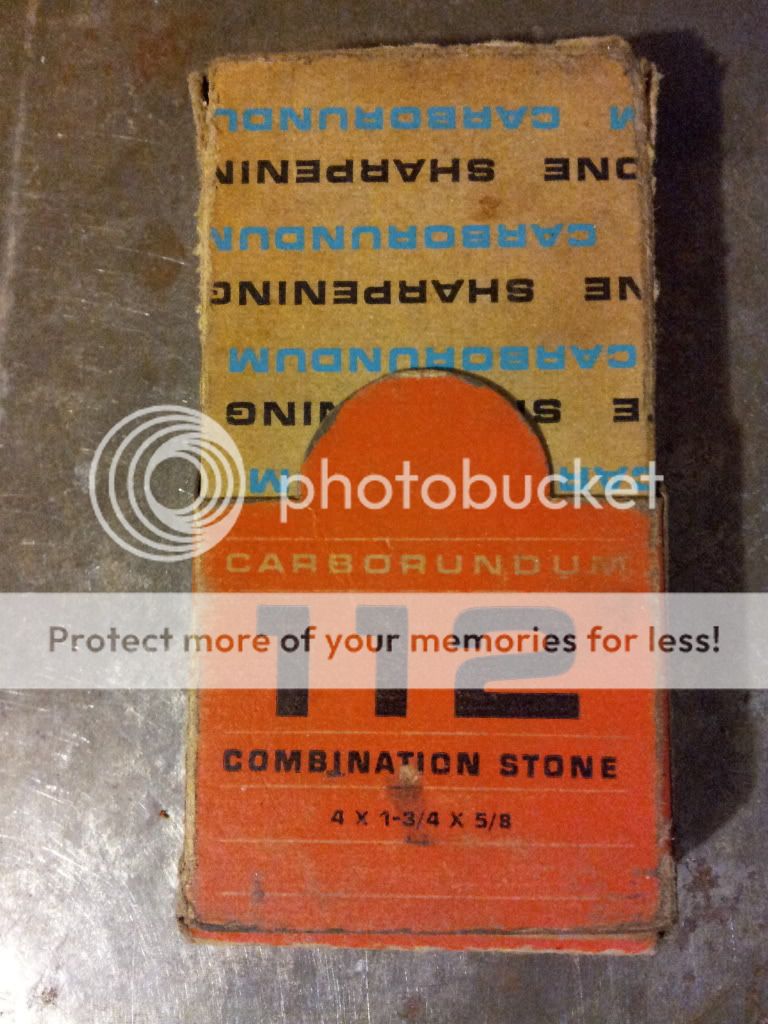

Then I realized I have a carborundum stone. I picked it up at an estate sale about a year ago and it works better than most of my other sharpening gear. Mine is a combination stone - medium on one side, fine on the other. Everybody should try it if you can find 'em.

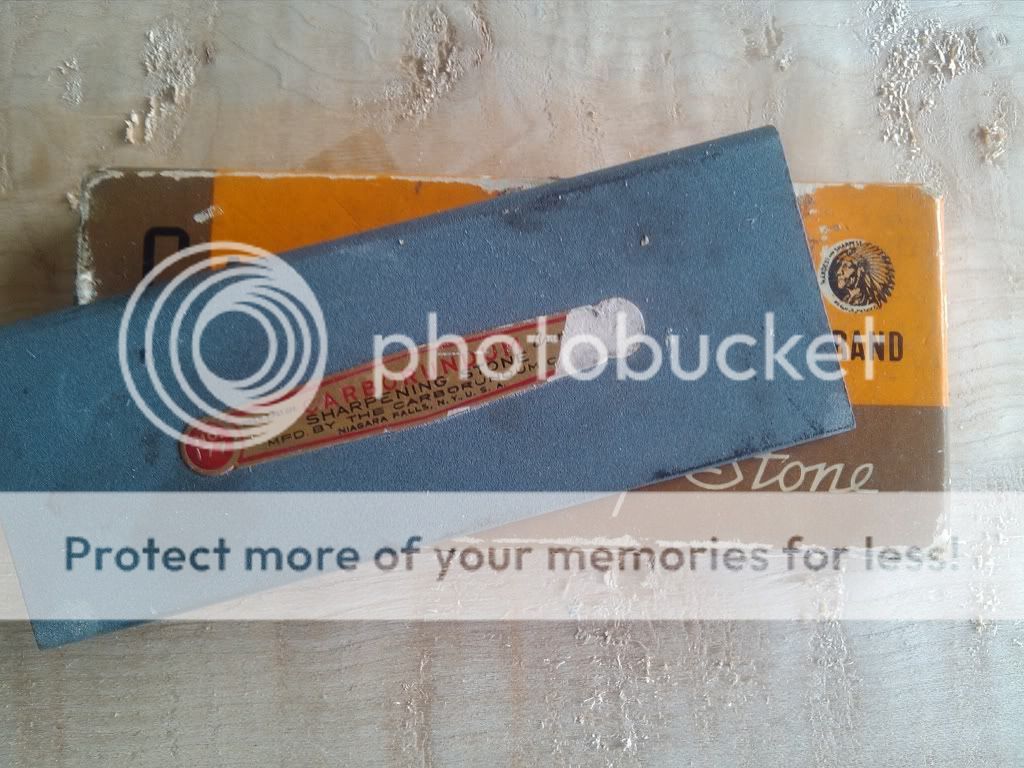

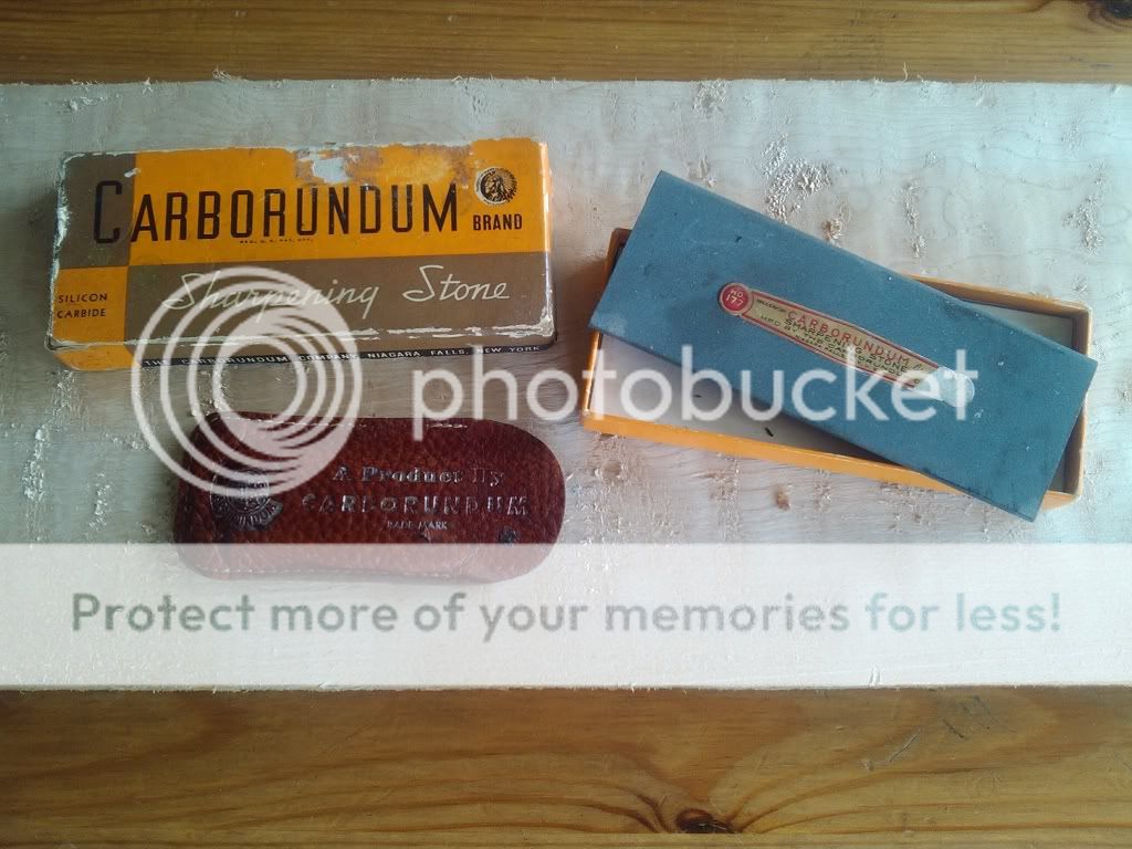

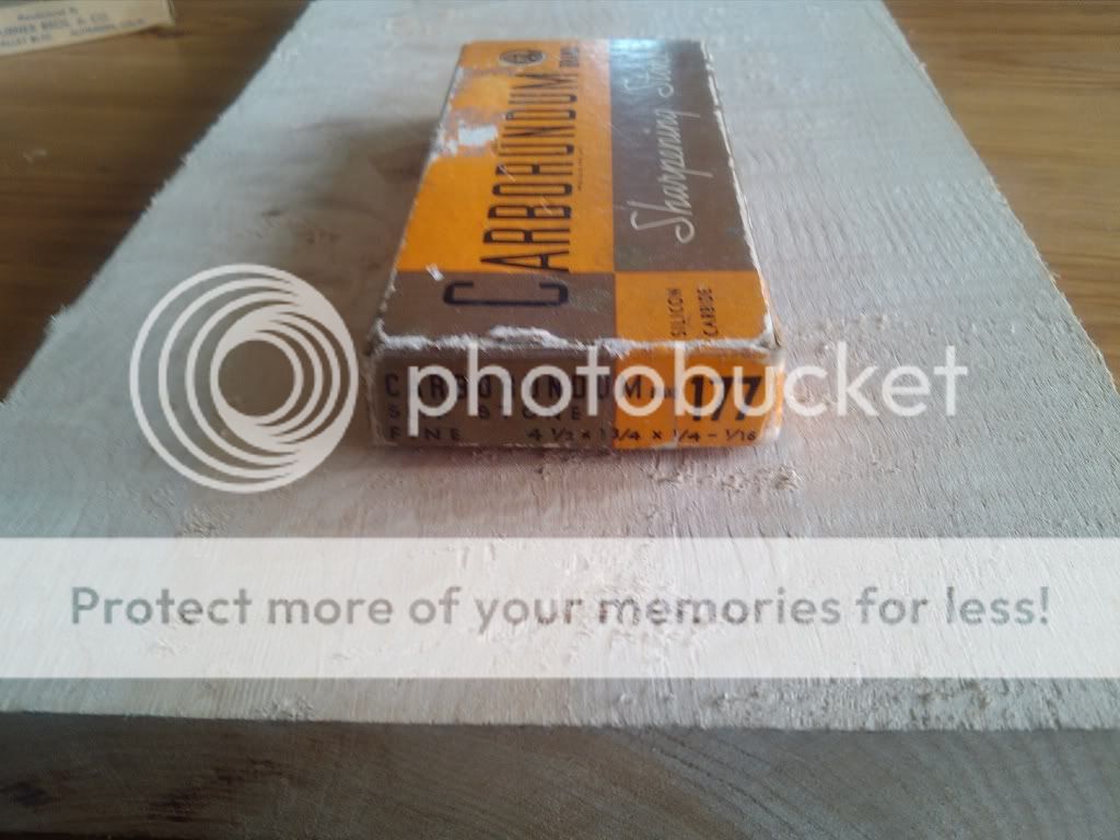

Nice stones! I missed this thread the first time around. I have a Carborundum slip stone I picked up a few years ago.
I haven't had an occasion to use it yet. I'm still working on my freehand "technique :)" with a couple larger benchstones.
The small stone in the sleeve is in pretty rough shape.

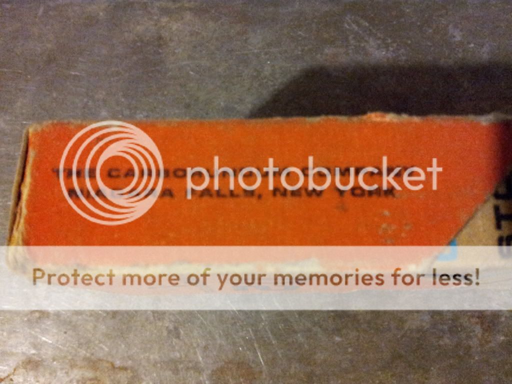

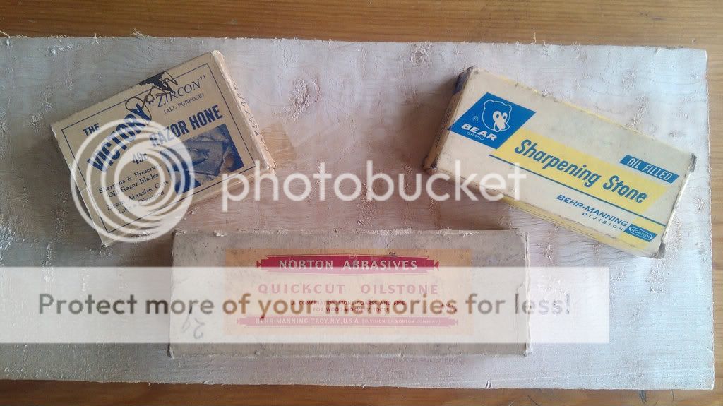

A few more oldies:
The big Norton is in about six pieces, but I like the box. :D
