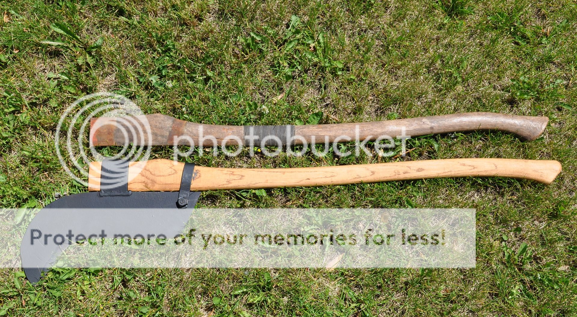

I've had a Kelly brush axe out in the garage for awhile. I decided it was time to get her in working condition.
I forgot to take before pictures, but here she is with the original handle shown above. The original helve didn't have a kerf cut in it. I used a 36 inch helve on her which did have a kerf cut in it. So I left it a little longer through the top eye. She turned out nice and tight. The hook took a nice edge.
I had to really thin out the shoulder of the new handle to get the lower loop attachment to fit. The original helve was a much sleeker handle. It seems that all the new handles one gets these days are thicker than the original vintage handles.
Dating the stamp would make this Kelly pre 1949.
The head on my Kelly looked rough and rusted like this Council Tool # 12 Brush Hook / Axe (below) before I cleaned her up.
Looks like I have another project. I'll have to get a straight 36 inch handle for the CT # 12 Brush Hook. I may be able to salvage the original CT helve on this one.
Council Tool still makes two styles of brush hooks. One like my Kelly and they still make the one shown above. Models 122C and 212.
Thanks for looking...

Nice! I've got a Kelly waiting for a handle but it's missing the the "lower loop". I saw a Council one a a junk shop awhile back but I think two is enough brush hooks for me.
Easy enough to fabricate your own. Thin strap like that can be purchased at your local hardware store and a plumber's Mapp gas torch will get it plenty hot to shape it. Throw a piece of round bar in your vice to shape it over. Drill out one side of your strap. After bending/forming it around the haft, drill the other side just slightly short of where you think the hole will line up. Then try to force a bolt thru at an angle. Tightening the bolt will pull the strap tight around the haft. And if you drill the hole too short to get a bolt thru then you can elongate the hole with a small rattail file.
