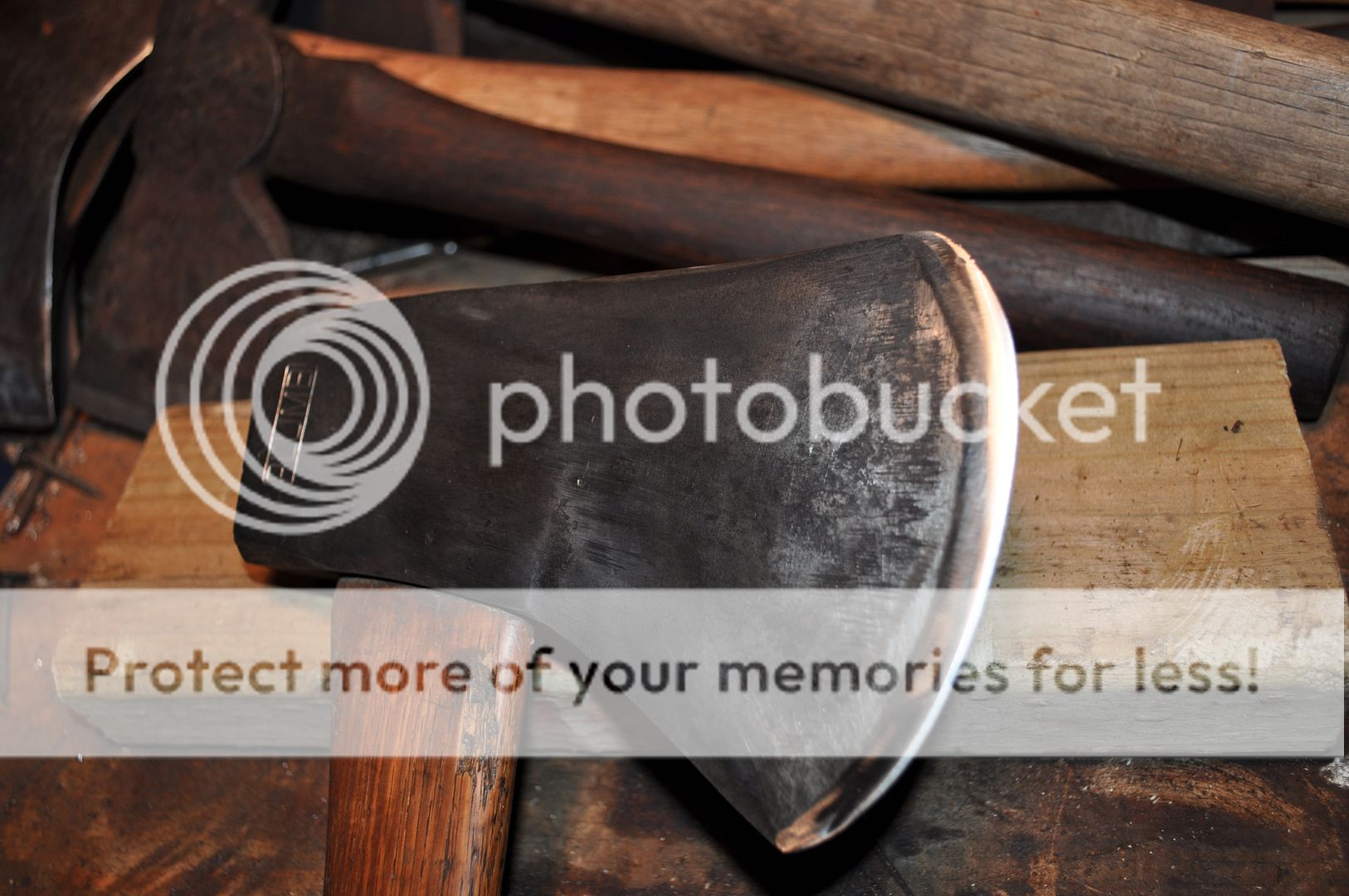

Awhile ago (8/21) I posted some pictures of a sweet Plumb single bit with a 22 haft on her. My intentions were to take her up to camp and use her on a windfall popple tree we have there. I ended up with a short trial of her and she did a nice job limbing the tree. I also used a CT Velvicut Hudson Bay for a comparison of the two.
Both have approximately 22" handles and both had their edges profiled before we got to camp.
While they both did a good job of it, I have to give the CT HB the nod here on performance between the two. I would have preferred a 28" boy's axe size haft vs the 22" these had for this job, but they did work out.
This may have been a rather poor test for these two, as I had split some firewood prior to using these to limb the tree and I really did a job on my back doing the splitting the firewood. I have some messed up discs in my lower back and didn't accomplish what I had set out to do with the Plumb or the CT. But, M3mphis asked me to post some pics of the Plumb, so here they are.
Thanks for looking, Tom [URL=http://s810.photobucket.com/albums/zz21/doubleott/?action=view&current=axe_to_grind.gif][/URL]

Thanks guys for the nice comments. M3mphs, all I can say is that the HB Velvicut simply out cut the Plumb. While both bits were sharp, the HB seemed to cut faster than the Plumb. If was as if the HB was sharper than the Plumb. Maybe the curved edge profile on the Plumb vs a rather straight edge on the HB bit.
Peg, I let my 12 year old nephew, after some instruction, use the CT HB last week to cut down two small popple trees at camp. I'm not quite sure how he managed to do it, but he sure scuffed up the head and the upper part of the haft on the HB. Note how the poll is rather bright and the rest of the bit is darker = scuff marks. Since it didn't affect the performance of the axe, I left it the way it was. That maybe why you asked the "Q: about the head on the HB. It is tight & snug as can be.

By the way, what would you guys classify the the head pattern on this Plumb? Kinda of a Cedar pattern with a Rafting poll. But it's not a true Cedar or Rafting pattern.
Thanks, Tom
I have 3 or 4 of those, from hatchet size to full size single bits. I always called it a Cedar, but you are correct, according to the agreement in the early 1900s, it doesnt match the photo descriptions. Also, I believe only Plumb made that pattern, and it was used for Boy Scouts, Plumb Victory, Plumb Guranteed, and Plumb DefenseAx to name a few. The DefensAx I have still has the paper label on head and handle, dont think I have ever shared it. Those are quite the workers.
