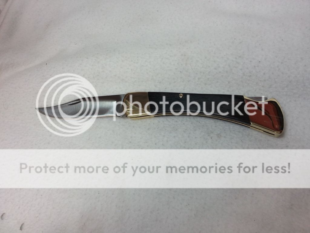

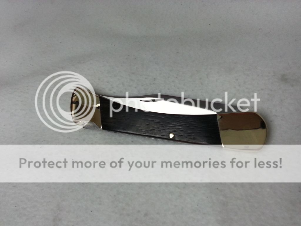

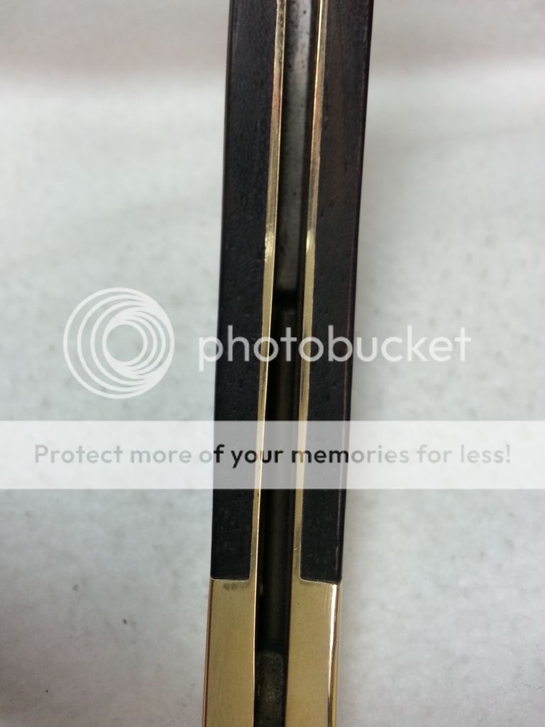

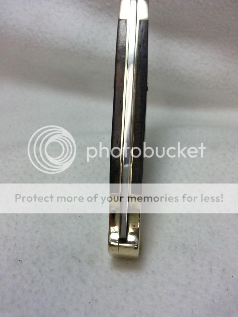

Here`s a Vintage, Cast Bolster, Right Hand Stamp 110 that I put some Maccassar Ebony on for a fellow Canadian. Note the differences in angle required to make a scale fit nicely. I believe this is why so many production knives from this time period have glue filler between the bolsters and inlays.
The liners in this era are so thin, I figured a through rocker pivot would be stronger.

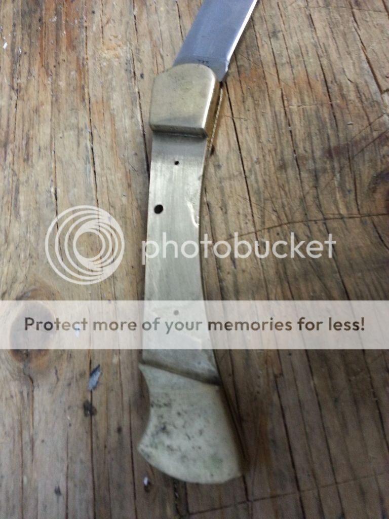

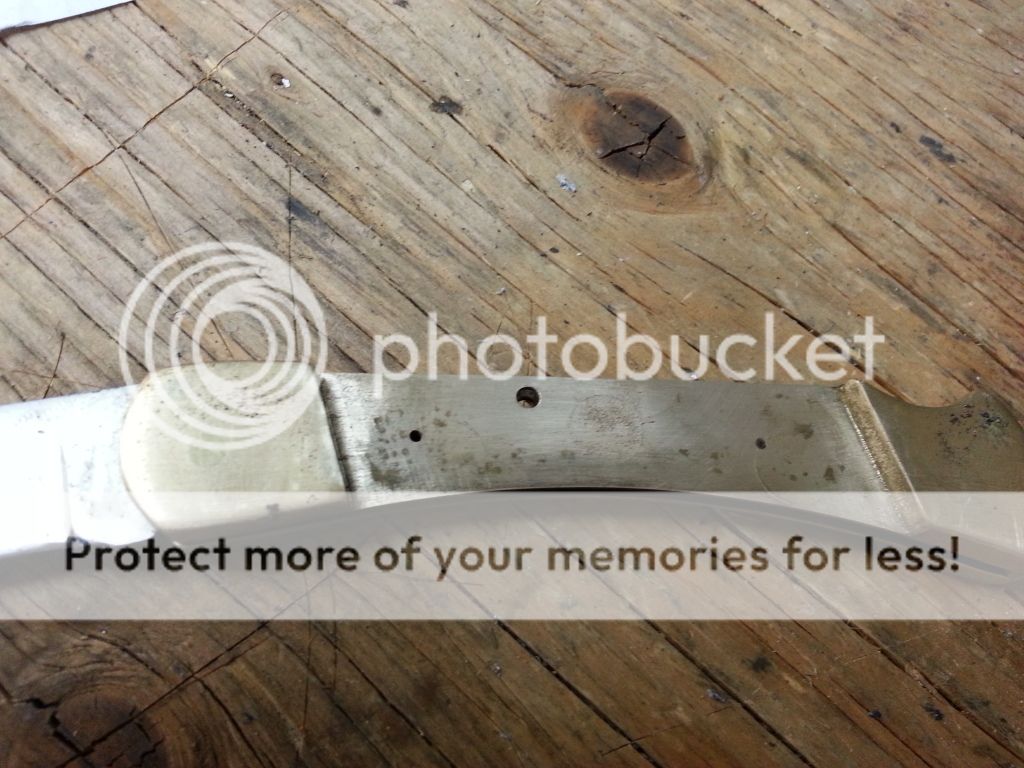

Note the Sprew marks on the one side from the casting and the voids on the other.
