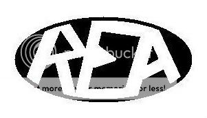

This is pretty much what I want, but smaller obviously. No idea how to make it a vector from a .jpg though. Well rough idea, but it's been a few years since I've done anything like that.

Just a couple mouse clicks from JPG to Vector. :)
Cool. Def. looks cleaner than my MS paint jpeg ;)
The actual vector file is even cleaner. That's the JPG converted to vector (EPS), then converted back to PNG since you can't post vector files. Takes all of 10 seconds with overpriced single purpose software. :)
